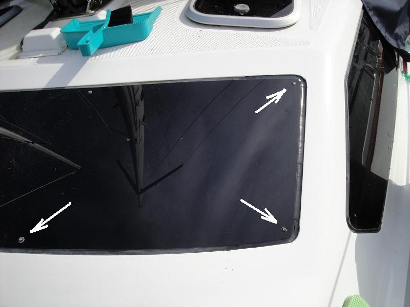

I still maintain the easiest way to hold the glass in place until the DC 795 sets is with screws for a month or two, remove the screws and finally fill the holes with 795. That is (was) the factory installation for my fixed ports. Invisible unless you press your nose to the glass.
13,012
Seems legit... curious! Why not counter sink the screws and leave them in?
Countersinking screws into plastic adds stress which leads to cracking. A pan head or cap screw compresses the plastic but countersinking adds hoop stresses which can be quite high. Don't countersink screws in plastic for a structural part.
Also, countersinking positively locates the window with respect to the frame which means any lateral position out of tolerance will also add stress. Any thermal mismatch will also add stress. Pan head screws can allow relative movement between the window and the frame if not torqued down completely.
Bad idea. Metal expands and contracts at a different rate than the plastic (acrylic or lexan) he counter sinks act as wedges and can break around the outside edge. Best idea is to slightly over size the hole ..
Exactly. I also think Hunter Marine (way back when) figured it looked better with no screws, which it definitely does.
However, the large front fixed hatchlight does retain the screws which are painted black. This was done to assist the glass in maintaining its slight curvature. The screw holes are considerably oversized:
Screws 1, Rube Goldberg contraptions 0 :thumbup:.

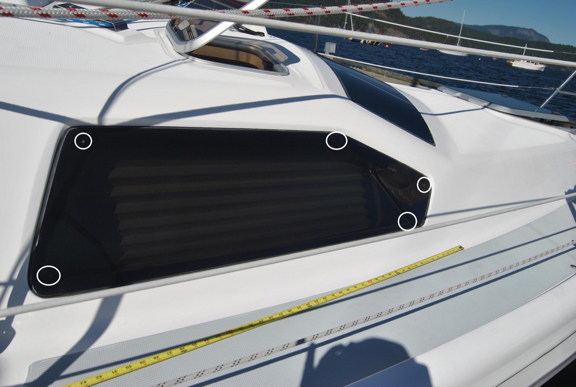

So how do you go about installing them without screws?
My responses
1. Butyl tape --
2. Use the same thickness acrylic that you have currently.
3. I believe your Grampian has framed windows with trim pieces that cover.the window edges -- you don't have a frameless system. Install it the way it went in in the first place. (It's been in there for over two generations...)
4. Be very careful drilling any holes in acrylic -- or you'll get cracking. You have to use a special bit , over drill the holes, etc. Do the screws go through the acrylic now -- or are the holes outside the windows?
5. If the trim pieces have sealant on them (in addition to the butyl tape) then use a LITTLE sealant. (NOT permanent 5200 -- something that can be released later, if needs to be.)

The windows are frameless but do have a trim on the outside
they are held in place with screws
so if I understand correctly, I use butyl tape to seal and then screw them back in then use a little sealant to seal the edges
what kind of drill bit do I need?
Drill the hole larger than the screw. You want to allow for expansion and contraction -- you don't want to concentrate stresses on the hole.
