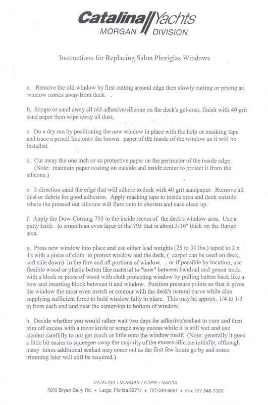

I've collected a library's worth of info to date, some of it contradictory. I have to plan the replacement of all fixed port openings as they are starting to show their age.
The most ridiculous one I've seen to date is supposedly by Catalina (paragraph g), although I suspect it's a forgery, it's just so far out there:
Picked this up from another post by some poor guy who had tried this and was ranting and raving about all his ports being crooked plus a couple popped open after a few weeks.

I would say the hardest part of replacing windows is holding them in place while the sealant sets. Mine were pretty easy due to the shape of the frame, I was able to hook onto it to apply pressure. A friend had a heck of a time wedging boards in place with enough pressure to hold the new windows in. 2x4s, diving weights, ropes, widgets, and Rube Goldberg contraptions. So yes, I can believe the instructions.
It is VERY important to follow the adhesive/sealant manufacturer's instructions and make sure you use material compatible with your glazing material and the frame. I had to use primers on mine but it worked well. Also, ensure the frame is clean and free of old sealant.
