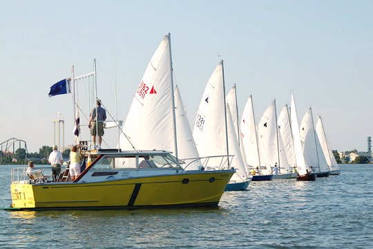

Starting line boats are typically anchored in place, and are held by the push of the breeze. They do move slightly as the breeze shifts.
So NO they do not move to avoid contact, that is the sailboat’s responsibility. Often RC boats will float a small mark off the transom, attached to the boat via a short line. This mark becomes part of the RC boat, and reduces the likelihood of contact. If done, this must be mentioned in the SIs.
A good idea if your club uses sailboats or other boats with exposed rudders on their transoms.

Our club has the hit the committee boat hing figured out. The have a couple of Inland Seas Steel Clippers for committee boats. These boats have this nice little 2" diameter round bar around the back quarter of the boat. My friend on his 29 footer came in late and hit one. No damage to the com boat, about $1500 in fiber
glass work to his boat.
