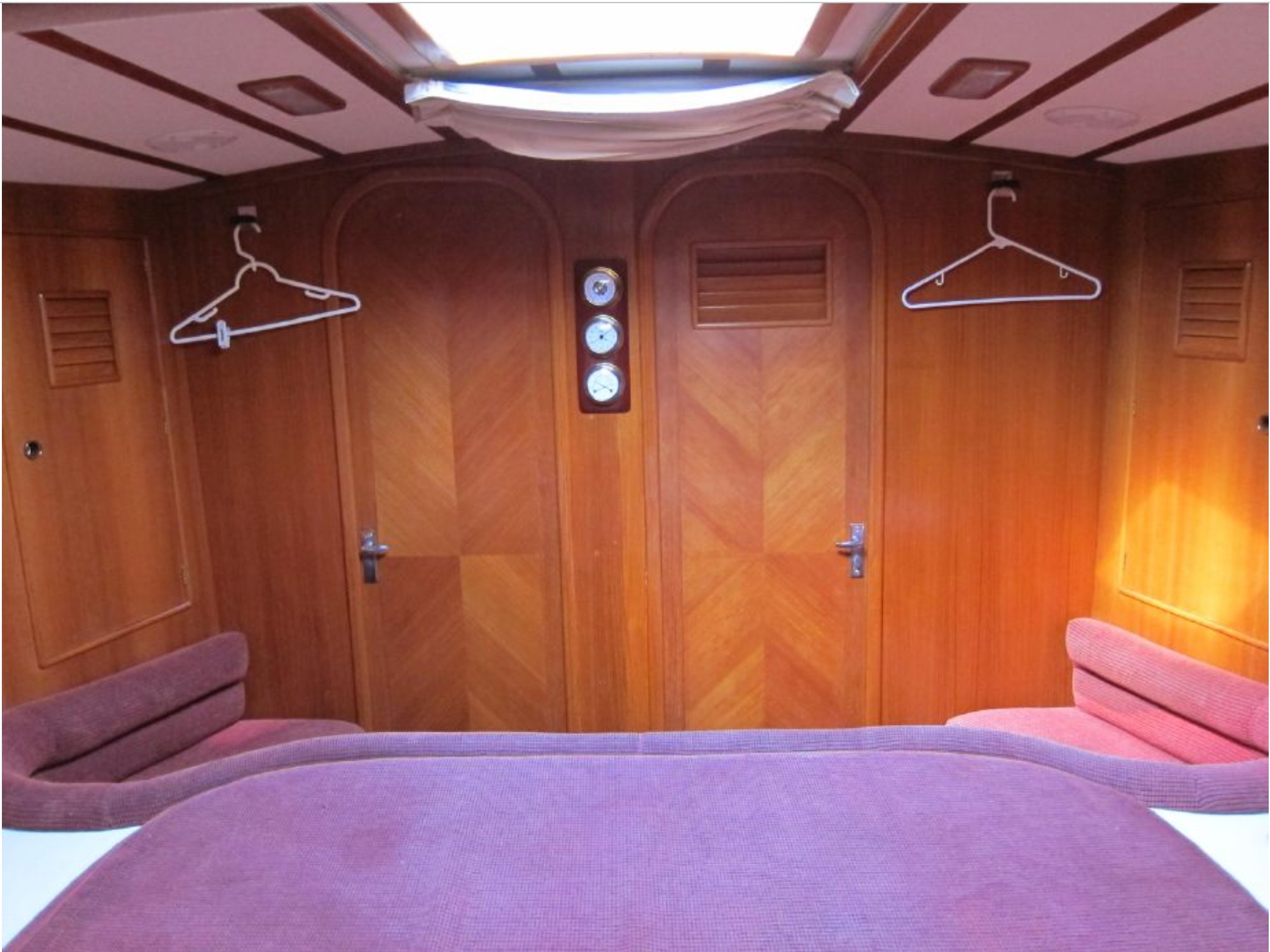

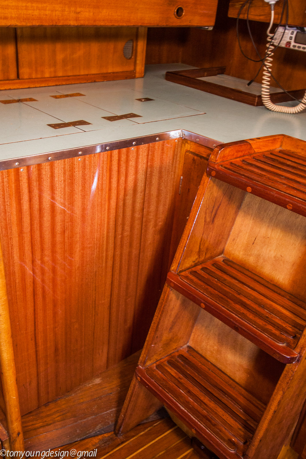

Are you fishing for pictures? Hahahahha - here comes one anyway!

My wife saw the picture and she now wants a set of steps so she can reach the bottom of our refrigerator.
