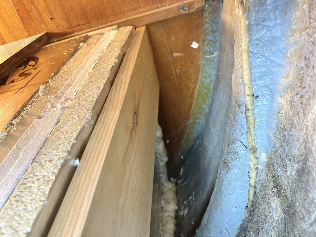

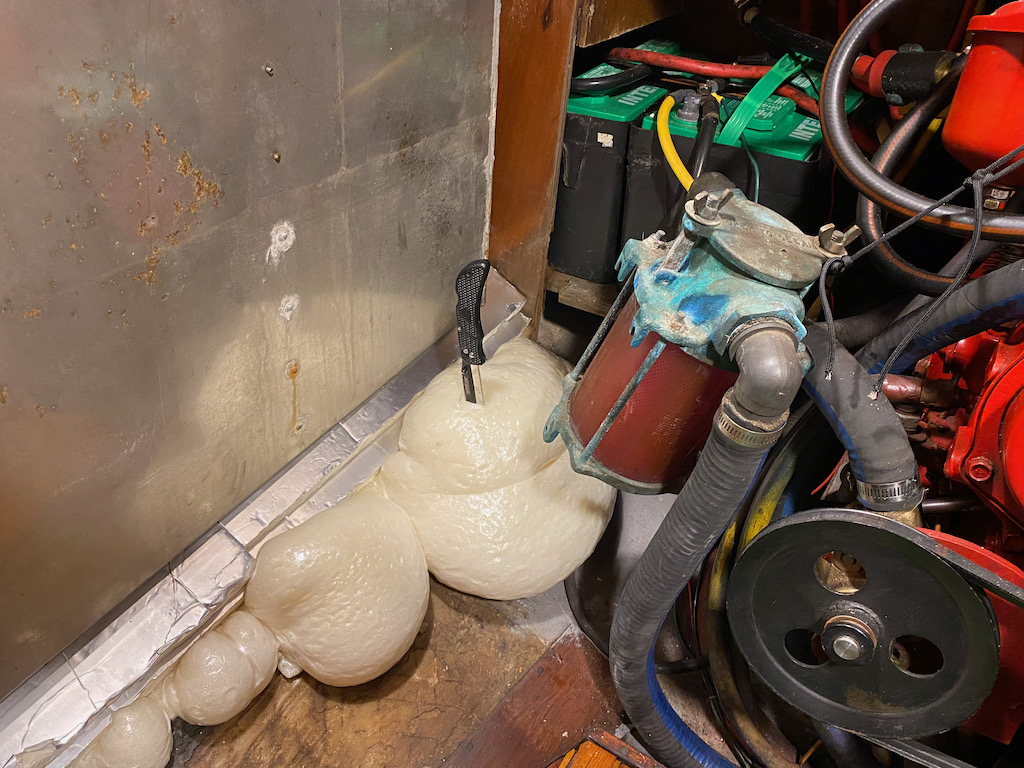

I finally got back to this project. Lots of good advice.
I forced 2 1" polyiso sheets between the hull ribs and the SS box. That left 1"+ void at the tops of the ribs. As hull moves out that space grows to 4". With an extension tube on the expanding foam cans, I was able to reach the middle of the void from each side to begin filling the void. It went pretty well on Saturday. I used 7 12oz. cans. I returned today to finish filling those voids.
Suffice it to say, I don't work with foam much.
Ok, so I could have gotten away with 6 cans.
But all voids are filled along the hull. The back has tons of space so I'll put 3" of polyiso sheet back there.
I now have the two sides fitted with 2" polyiso. That leaves about 1/2" void remaining so I'll attempt to shoot those voids with foam between the iso and the SS box. Every bit will help.

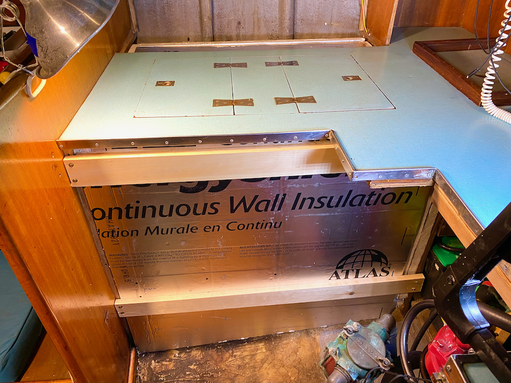

3 4X8 sheets of 1" polyiso later. It's a big box,....
It's still only 2" on the top, front and sides, now 3+" on the bottom and back. Polyiso foam is rated about 2X of the original 1961 foam. Plus it's all fit more tightly now. I lost count of the cans of foam.

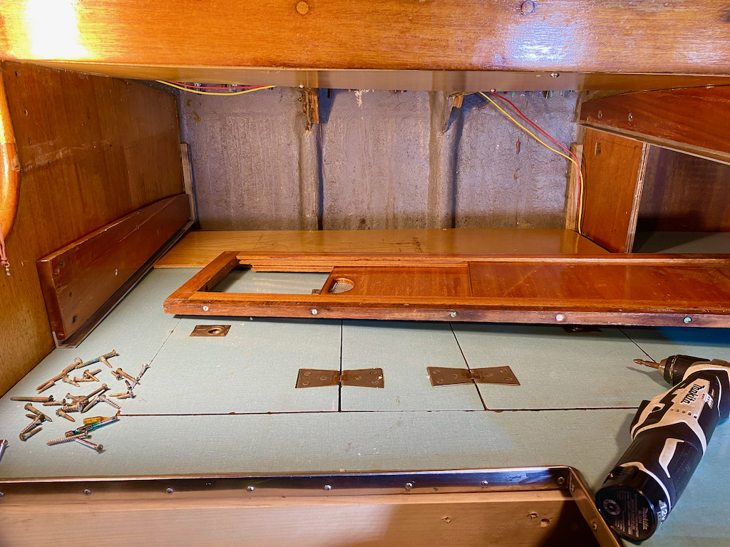

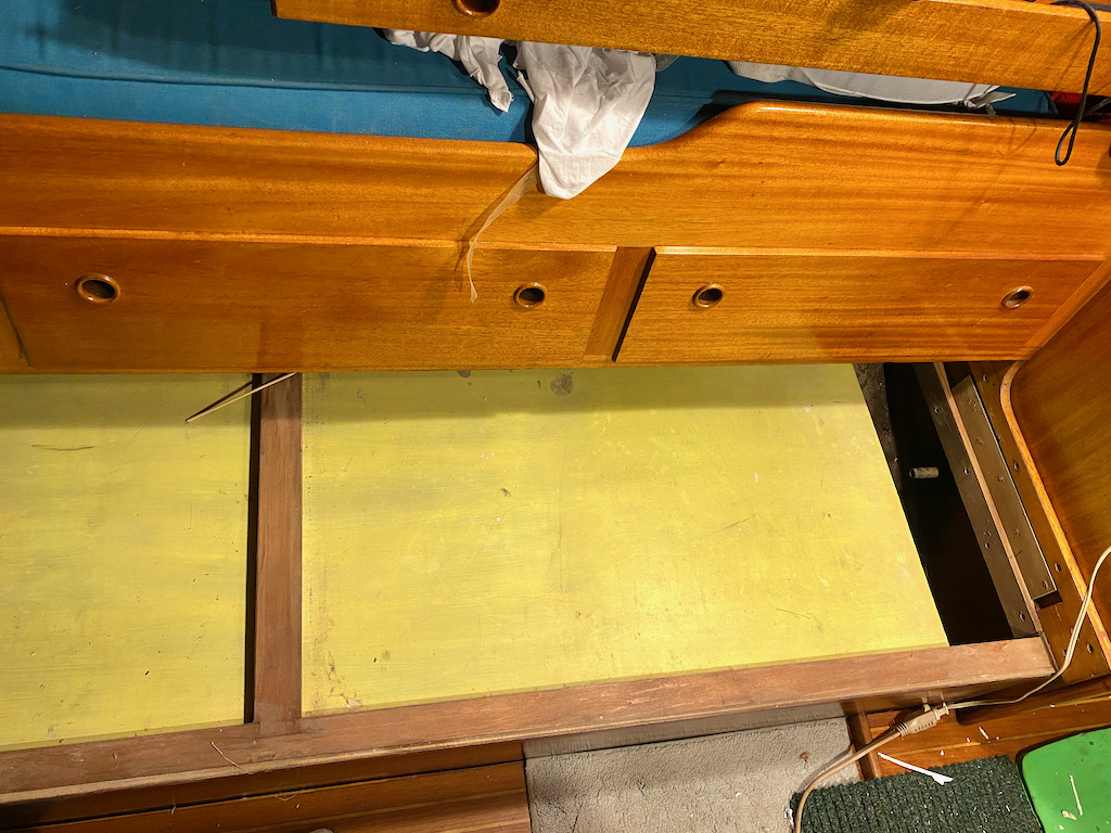

A skilled stick-built boat builder knows (knew), that you'll be taking apart their work sometime in the future. Screws and bolts were pre-drilled in parts to prevent splitting, hand tightened, and made to be removable.

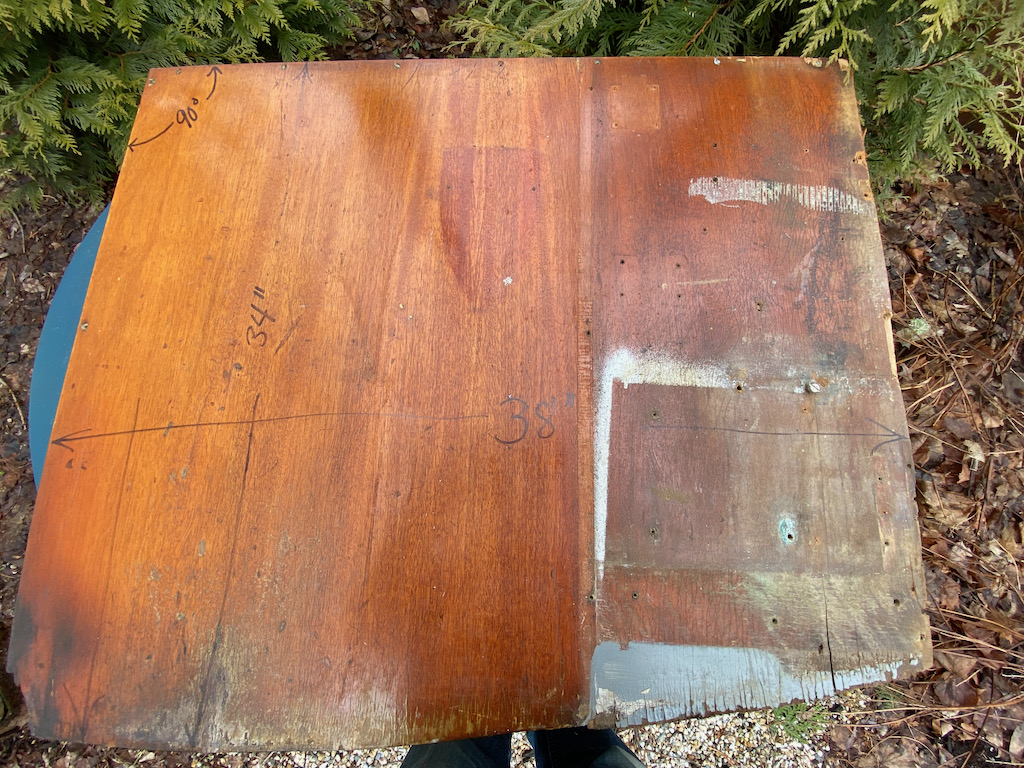

The icebox front had rotted out in the corner from decades of condensation. Boulter plywood in Ma. carries marine stock. Shipping large pieces is expensive so I marked the size I needed (plus an inch extra) so they could cut a 4X4' piece down for shipping. You get the leftover waste as well.

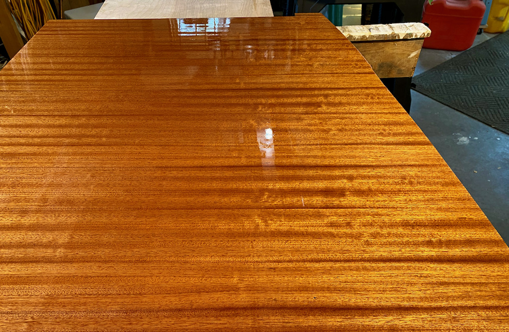

The closest match they had was 3/8" Sapele marine ply. I used the old piece as a template for the replacement. Here it is with 2 back to back sealer coats and 2 coats of Captain's varnish.
It could go in place now but I'll put a third coat of varnish on, just because it's too much fun not to. :)

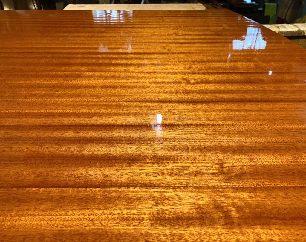

Thanks for asking. My point in showing this varnished work was in how easy it is if you do it right. And with a flat horizontal piece like this, it's fast:
I used a 6" random orbital sander for nearly every step, with the pad carefully flat on the surface, and each sanding was for no more than 5 minutes, usually less.
1- Roll and tip with foam roller and one coat of Petit wood sealer.
2- Roll and tip a second coat of sealer about 2 hours later, no sanding between coats. Overnight dry
3- Sand with 120 in RO, medium pressure until the surface is smooth and flat. Tack rag well.
4-Roll and tip one coat Captains varnish (mid-range varnish). Overnight dry
5-Sand with 180 in RO, light pressure, until the surface is smooth and flat, but don't take the coat off! Tack rag well.
6-Roll and tip one coat. Overnight dry.
That's when I took the photo, 3 coating seasons later, 2 coats of varnish. Actual work time,... hour maybe? Actual sanding time, 10-15 minutes? What I'm looking for is a smooth durable coating that can be washed, over and over (it's right in the galley). It looked fine at this point but you could see small pores in the veneer that weren't filled.
So I did one last coat yesterday. Here I used 320 grit paper on a rubber sanding block. A light touch, all I wanted to do was fog the entire surface, flat. Maybe 5 minutes of easy sanding. Then a good rub with the tack rag to get all the dust.
On the rolling and tipping: Apply a full coat rolling in one direction, then rolling in the opposite for checkerboard effect. Rolling is what applies an even coat you can't do with just a brush. The final tipping is always with a very light touch, with the grain.
Now it is done and ready to install this weekend. It feels like a sheet of glass.
