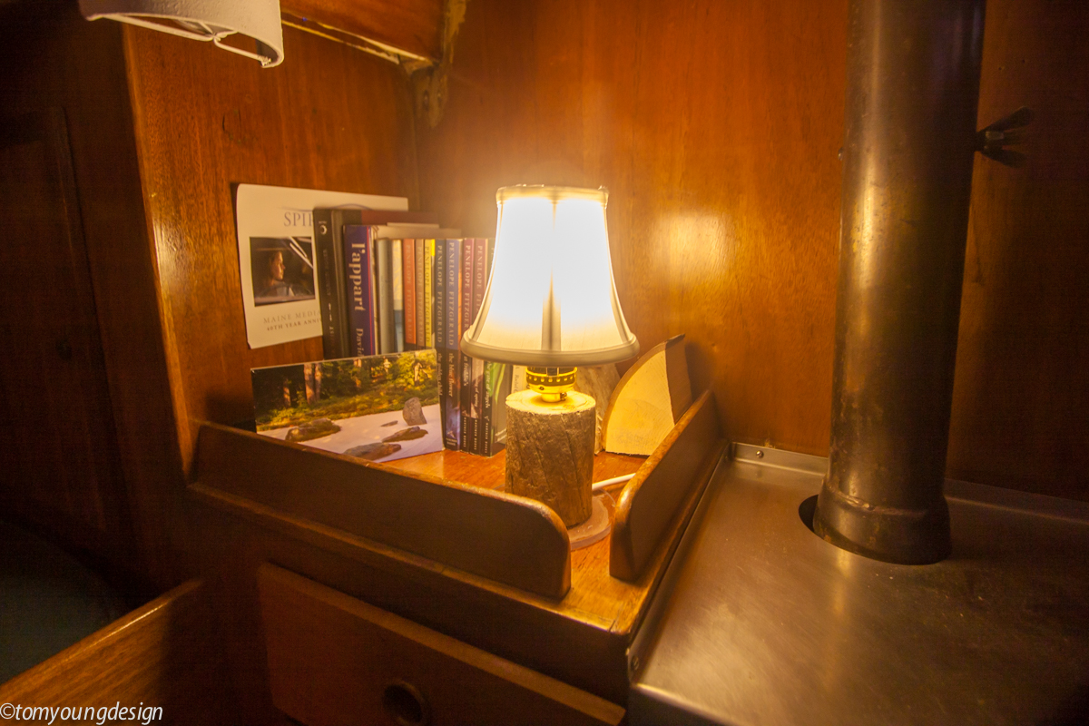

Thank you, Will. Sailing, boats, life on the water, it's all very inspirational. I've been 'testing' the $10 lamp and very happy with the warm light it puts out on these cool September evenings.

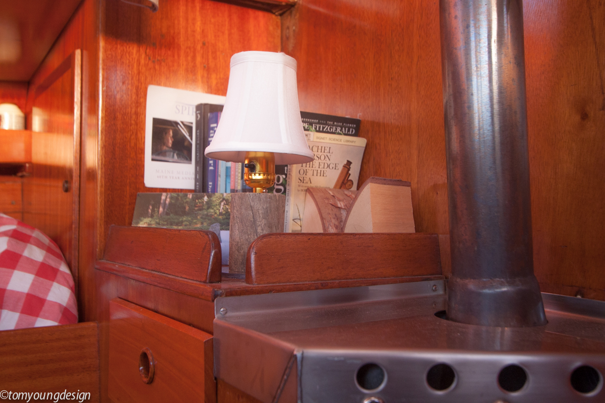

I put a simpler version together with a short cord and plug to be moved or stored.
A chunk of driftwood with a hole through the center. A short channel in the bottom to run the cord of 16-2 wire. To give it a stable base, a disk or Lexan created with a 4" hole saw is screwed through the bottom into the driftwood(that also captures and secures the 16-2). As with the stones, threaded lamp pipe is epoxied, not bolted(to allow 16-2 to exit base above Lexan).
Simple, cheap($20?), great light(choose your wattage and color)!
