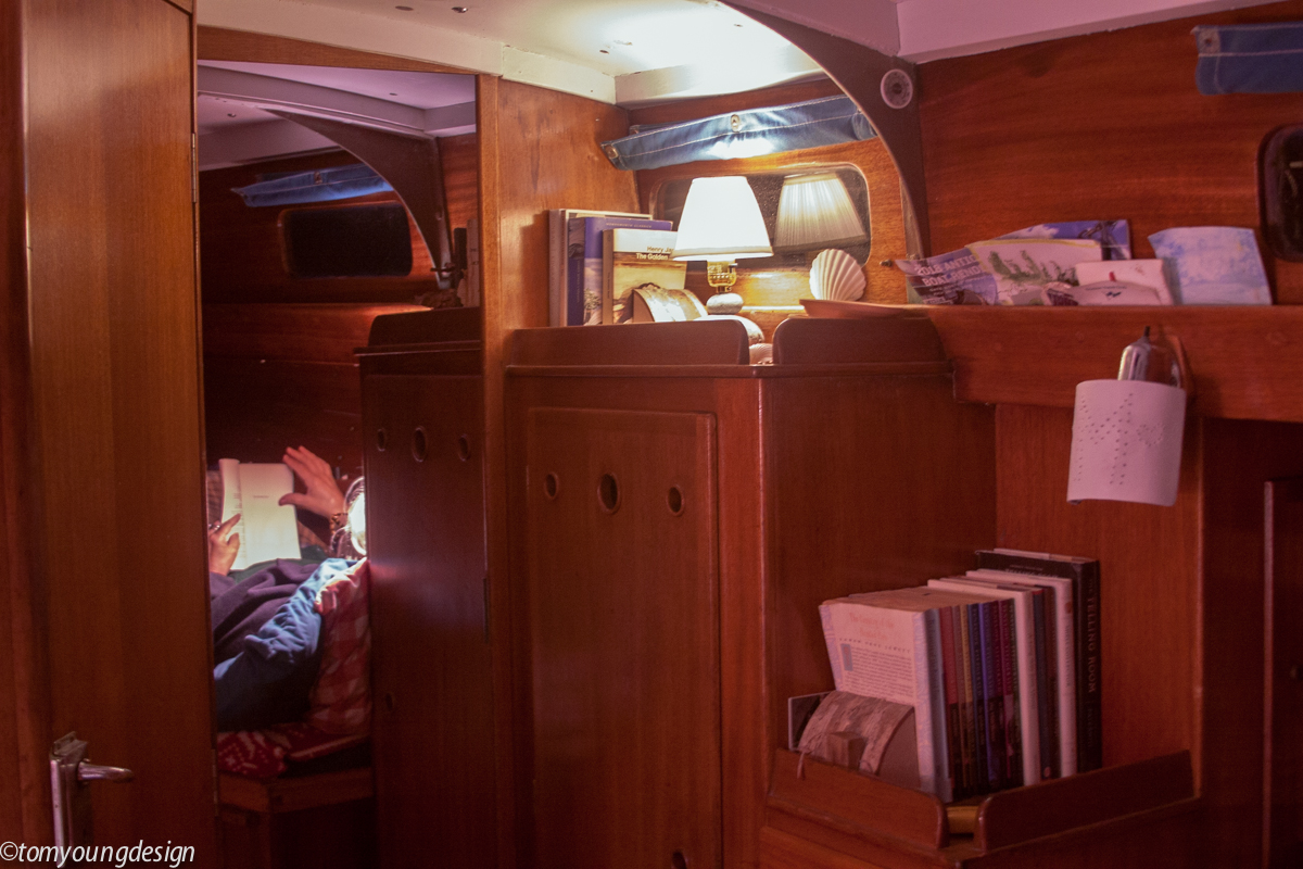

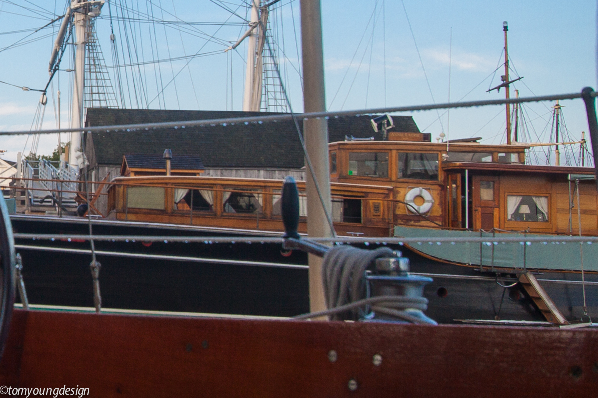

I was tied up next to this big old motor yacht this season for a few nights. I loved the curtains in the 'windows' and especially, this table lamp, in the aft port.
The cloth lamp shade cast a soft warm light inside the cabin at night and was also a welcoming light to those of us around the harbor.

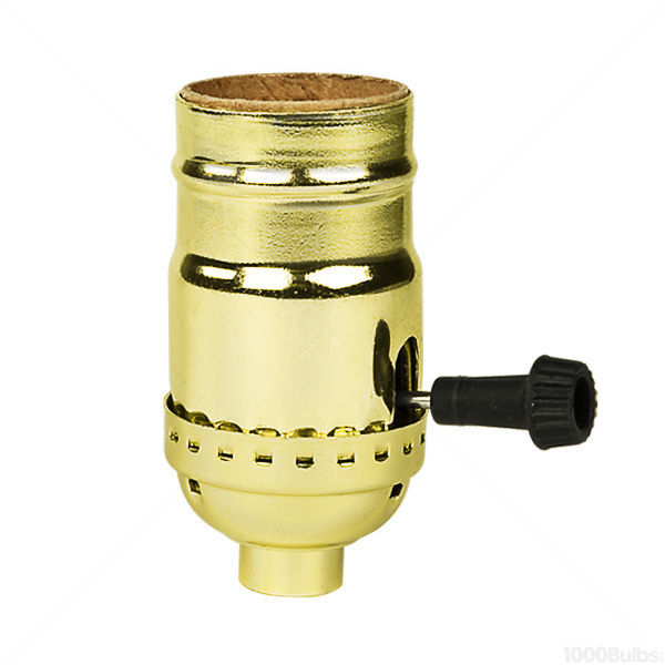

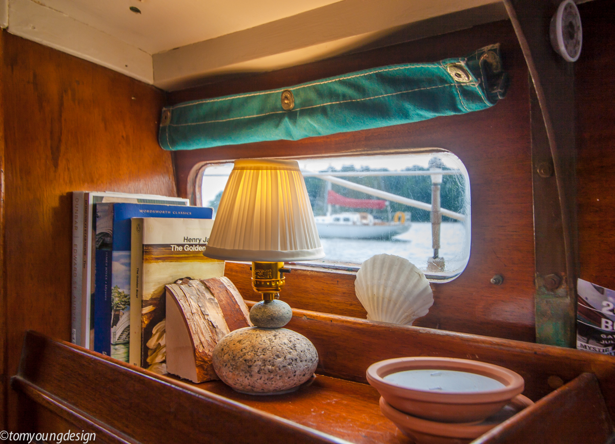

I had a couple of household base 5 Watt, 12VDC LED bulbs left over from converting all our cabin lights. I knew small lamp shades were available as 'Chandelier shades'. They clip on the smaller bulbs in typical household chandeliers which are about the size of the 5W LED bulbs I had.
The whole lamp had to be less than 10" high to scale into the small space. I needed something for a short, stable base. Several days, weeks,... I spied a suitable object: A rolled Maine beach stone.
My family collects found art out sailing, the stone was in the garden (and they are throughout our old boat).
The only hard part was pushing(sweating) a masonry bit through the stone (granite I think) on a drill press. I made the hole a snug fit on the typical threaded pipe for lamps. Not high enough so I added another smaller stone making it officially a Cairn. The tiny lamp fits right in with our 'decor'.
After setting my parts in epoxy I ran wire through the bottom of the rolled stone. For a base, I laid a thick donut of silicone around the stone and set it - plumb - on a piece of plexiglass sprayed with cooking oil(took a day and a half to firm up).
It's amazingly stable and the silicone grips tenaciously. As a back up, the wiring runs through a small hole and is tied below, to keep it put.
The soft warm light on the shelf nicely lights the passageway now. Mary Ann, who covets her beach stones, loves it!

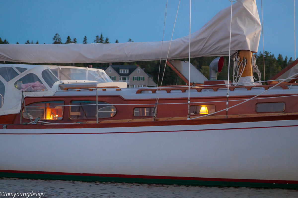

I was anxious to see it from the other side. Not bad. Another harbor light.

The engineer in me was thinking about ways to make it "bullet proof". I think you said you had already put a hole in the wood below the lamp for the wire. Does the threaded pipe go all the way through both stones? If it does (or it can with a little more sweat) how about a pipe threaded on both ends long enough to go all the way through the stones and the wood shelf below. Then put the wire through and a large washer and nut on the underside threaded pipe and it would be pretty secure, even when heeled over. Make sure to put some chafe protection on the end of the lower pipe so it doesn't wear the wire where it exits the pipe. Sorry, couldn't help the suggestion - the engineer in me comes out now and then.

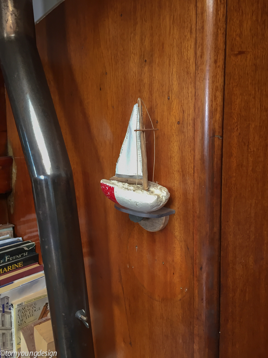

More than 10 years ago, my son made me a smaller version out of a small buoy. With his cherished Swiss Army knife he sawed it in half, fit a stone keel and carefully stepped a twig spar and mainsail of plastic. He used sail repair thread, duct tape. It sailed!
But it became too precious to me so I fit it on a plexiglass stand and mounted it on a bulkhead over the fireplace. It's been there ever since.

I didn't run the pipe through and bolt because I was tired of drilling and didn't want to get into cutting a larger recessed hole for a nut. So I epoxied it together. The silicone donut encases the wires which (you might see them) exit out the rear before ducking down the hole.
Your idea is the perfect solution as it eliminates the recess and through bolting the lamp, would make an absolute, "Blue Water Table Lamp" version. :)
