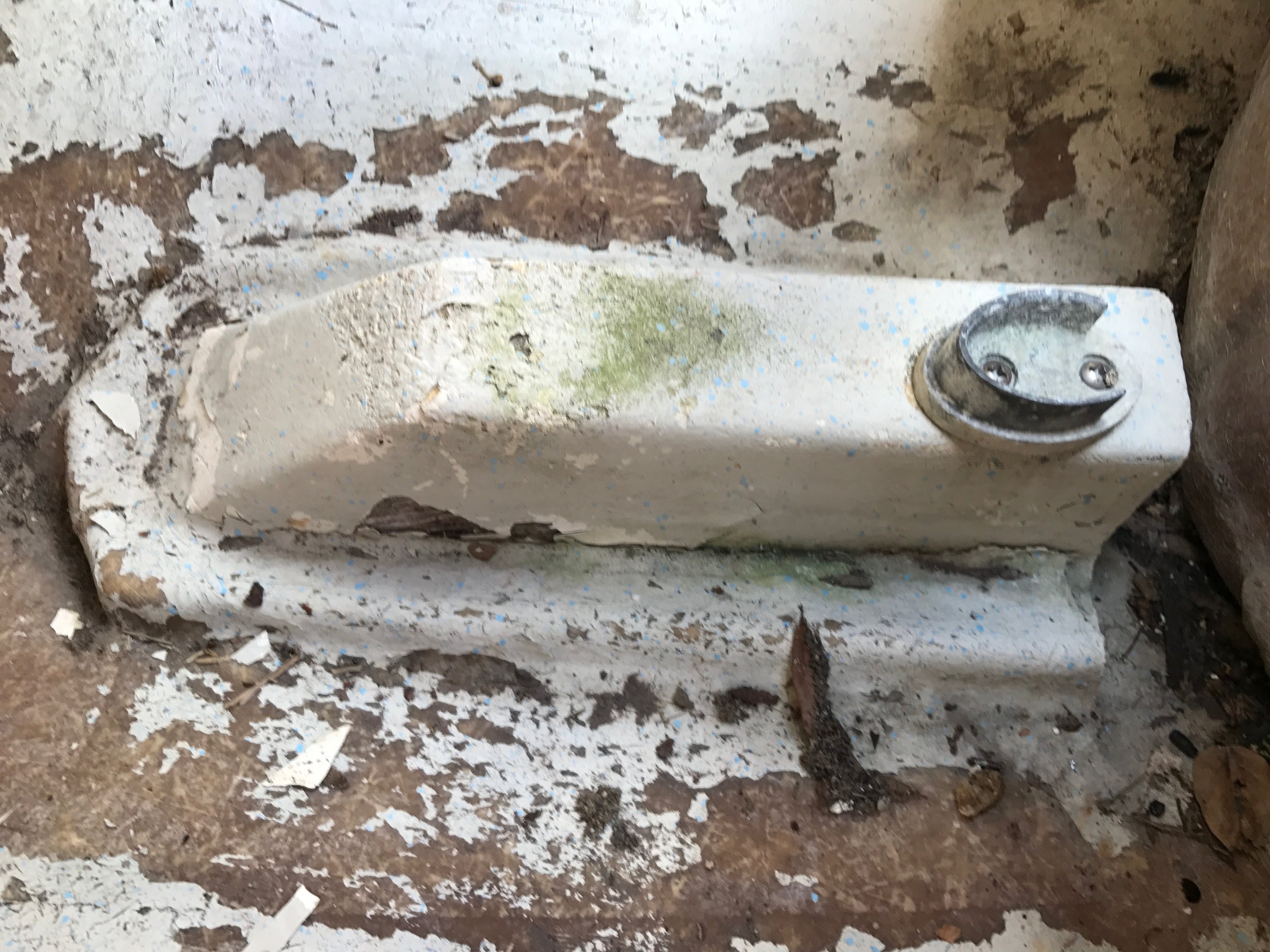

I'm returning a '77 Widgeon to seaworthiness as the first step in a long-term restoration. After inspecting the mast step, I found some play in the raised platform (~4-6" off the keel/hull?) that supports the mast socket. I'm wondering if anyone has repaired/replaced this area of a Widgeon before and has any advice before I tear into it.

When you say play, where is it? Is the whole thwart (what looks like a seat) moving or is the hole for the mast enlarged? Maybe a picture or two. I haven't been around a Widgeon in 40 years so I'm going from an old memory.

Thanks for the response! Attached is a picture of the mast step and the platform on which it rests. The mast step plate itself is firmly attached; it's the block beneath it that has "give".

Does the manual you got from Sunbird show that style of mast step? Do you think it's a solid piece of wood just glued to the hull or is it hollow and providing some function on the outside of the hull? I wonder why the step is offset. The Widgeon I had around 1977, was about 10 years older.

Nothing in the manual speaks to the mast step. But you are right about the curious position of the step on the block. The block appears to be organic to the boat but I can't imagine the factory just dropping the step and screwing it in like that. I wonder if D&R Marine (the company that bought up all of O'Day's parts when they shuttered) would look at the picture and be able to provide any input?

Rudy may know something. You might just remove it, may be rotted anyway, and glass in a new one that centers the mast step. I would level the boat and stand the mast up plumb (with rake the manual calls for) to find the location. Welcome to the forum. Lot's of good information hiding behind the occasional BS here.

O'DAY did some funny things after creating the DS II, Javelin II and Widgeon II........ Those are the "second generation" versions of those boats, only the DS II retained the designation for very long (maybe because the DSA made such a stink about not being consulted about the changes and insisting that O'DAY continue building the DS I as well as the DS II) but anyway back to the question at hand. On the earlier, 1963-70 Widgeons that fiberglass, box-beam that the mast step sits on joined the forward flotation chamber to the forward end of the CB trunk and was also glassed along it's edges where they met the bilge. That pretty much locked it in place and the work was done right because, well... you could see it and it was a very visible part of the boat. On my DS II this same box beam exists, but it runs from the remnants of the molded forward flotation chamber to just forward of the mast step location. The mast step is supported by a plastic pipe between the underside of the cuddy floor and the bottom of the boat. The box beam sort of floats ahead of this loosely secured by fiberglass tape just like this Widgeon. In reality the beam serves little purpose on the DS II, really just keeping a partial bulkhead in place under the cuddy floor which keeps the chunks of foam contained forward of the forward bulkhead in the bow.
OH yeah, back to the Widgeon, looks like a Monday morning or Friday afternoon boat! Box beam is hollow fiberglass beam, glassed in place in bilge. If your mast is fairly well centered, is: not leaning to one side or the other.... I'd try to secure it In place with thickened epoxy resin, possibly insert some kind of solid bock (epoxy-coated wood?) bracing the box-beam against the foam aft of it (or is that forward?) as long as the foam is solidly fixed. If mast is leaning to one side or the other, carefully unscrew the mast step from the beam (after beam is locked in place) then carefully re-step mast, adjust so mast stands plumb. Now trace around mast step and then unstep mast and resecure mast step In the new position (new holes will be needed and the old ones filled in most likely). This procedure is (believe it or not?) pretty much what O'DAY suggested in the original Rigging guide! I guess maybe this mis-alignment wasn't as uncommon as we would surely wish it was!
I'm still curious as to what Rudy may say about this photo....... hope he has some good advice. The Widgeons that he had built (1990-2005) had a different mast step setup.
