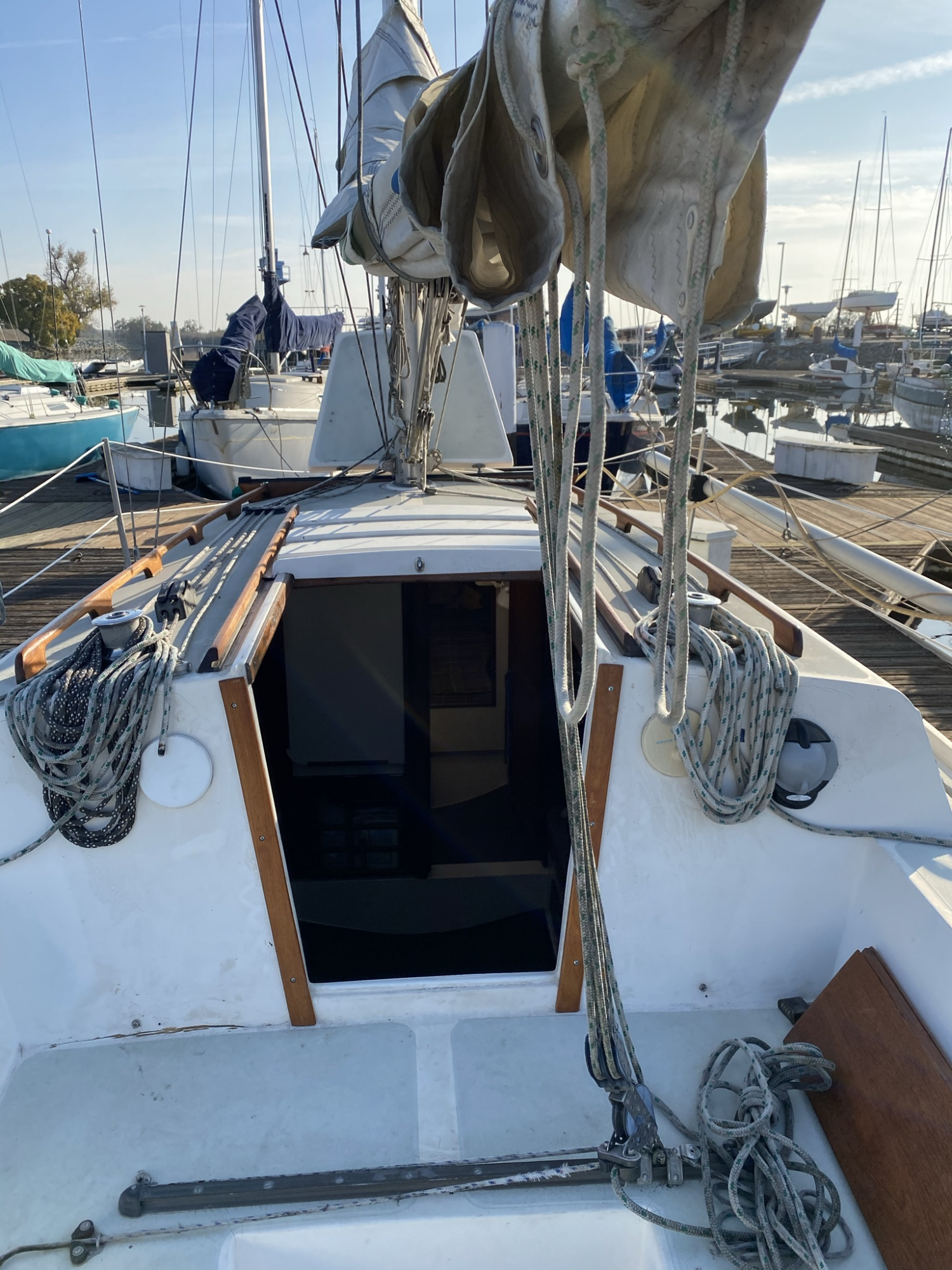

We'll work our way from the outside in -

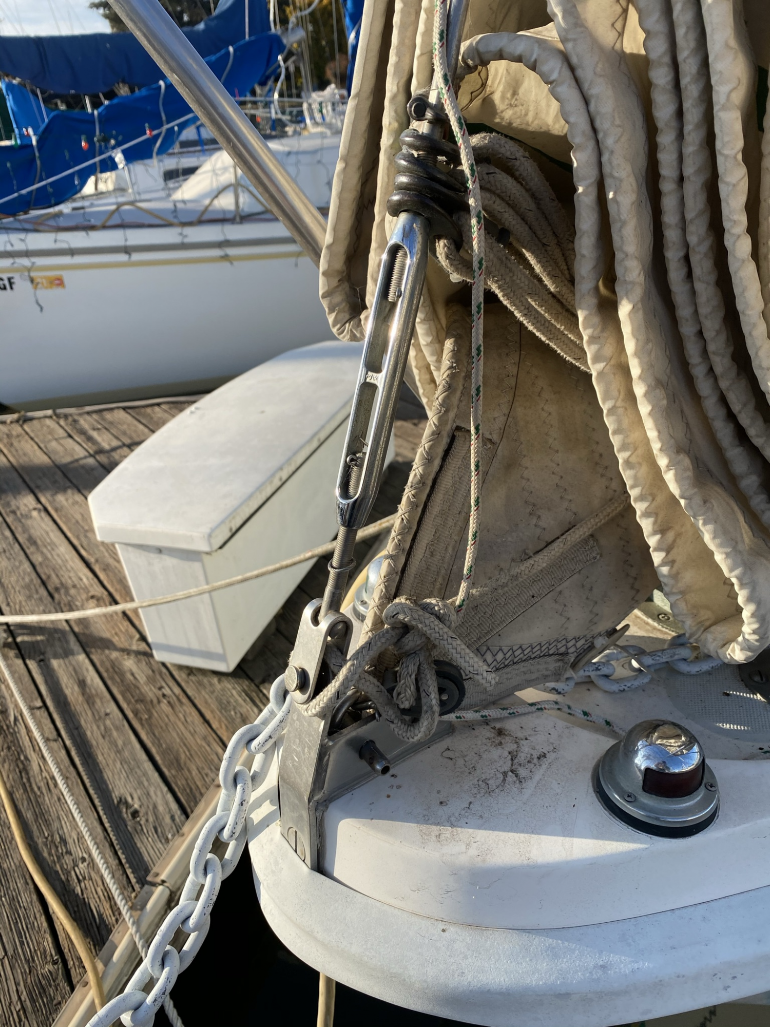

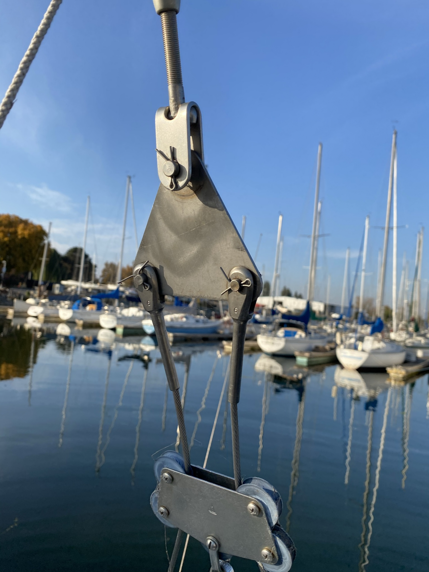

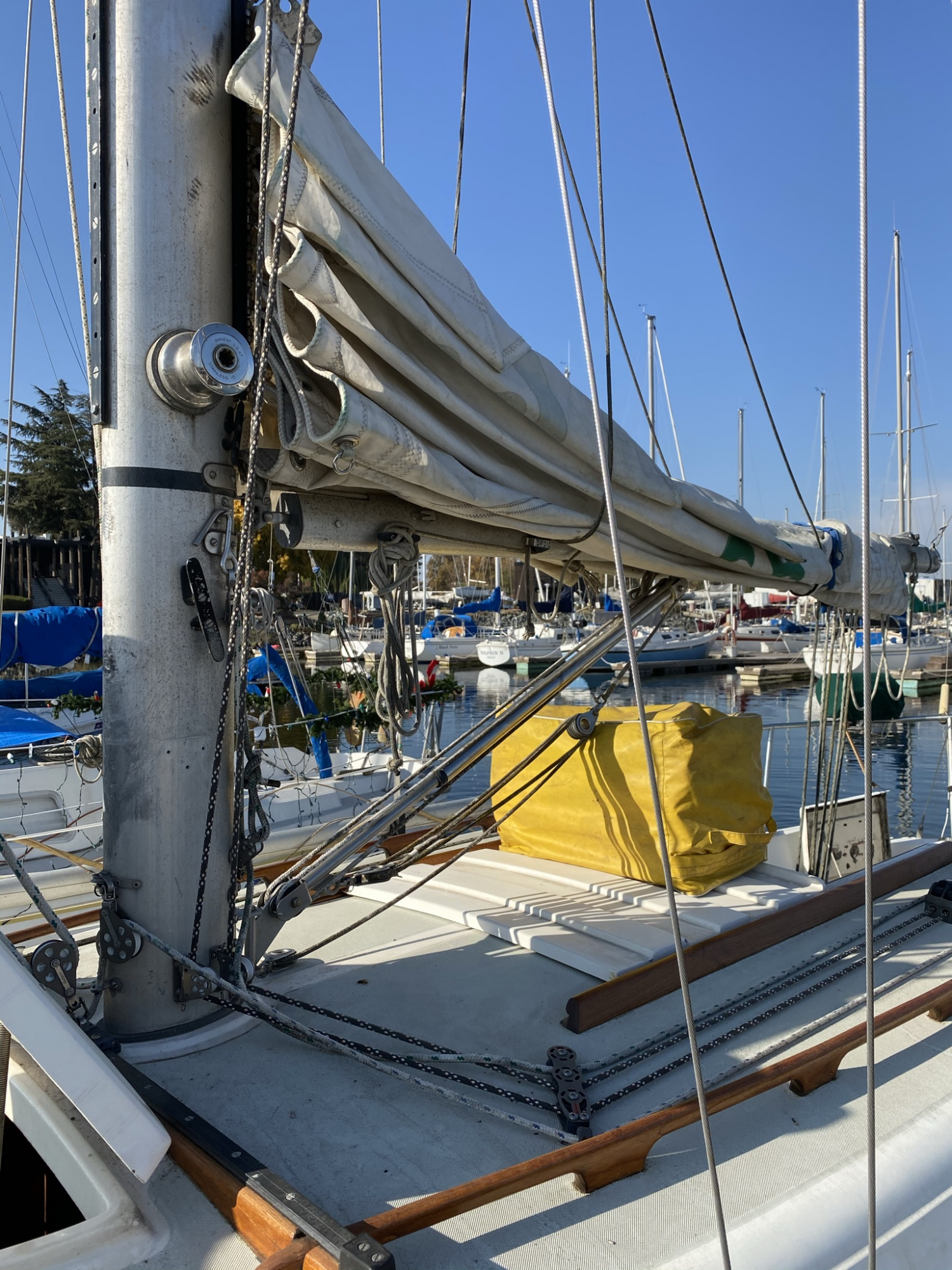

Sail covers off, standing rigging, running rigging
  • Sails are crisp North Sails with custom green lettering
  • Standing rigging looks good and feels beefy, not amazing but appears to have been upgraded relatively recently
  • Some running rigging is ready to be replaced, but has all been run to the cockpit
  • Sails are - Full batten main, standard size jib on jib boom, spinnaker
  • There is a self-tacking jib boom
  • Original wood spreaders I think?

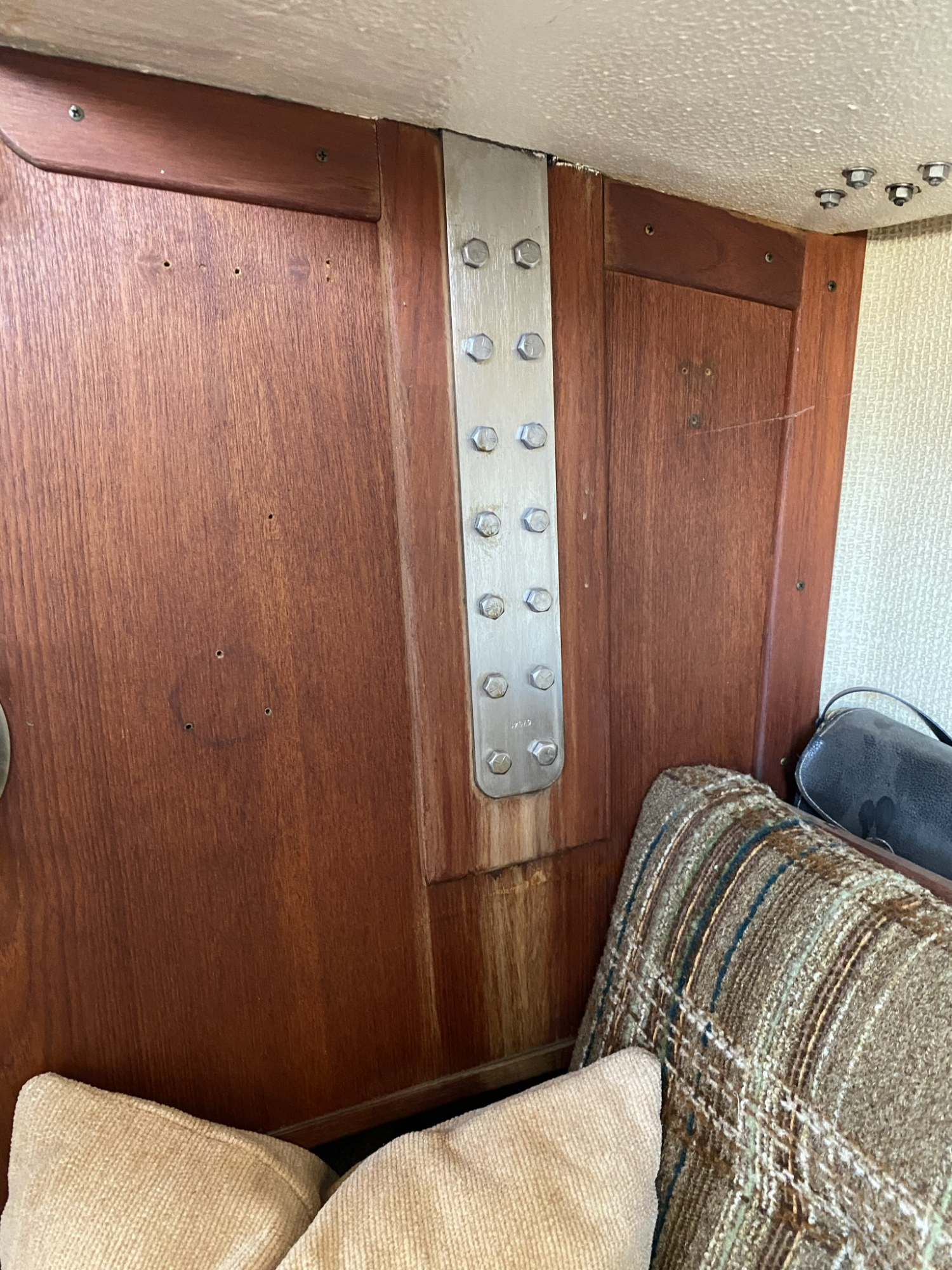

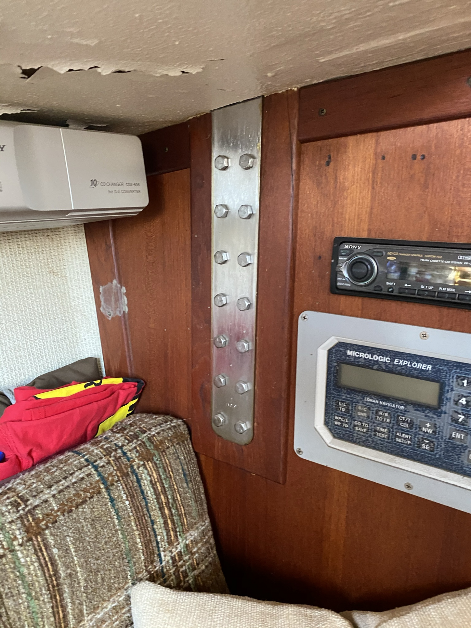

  • Completely dry around chainplate with discoloration, looks like this was addressed by the PO
  • Forestay and backstay look solid, no rust, definitely not from 1977
  • Decking felt solid around shrouds and kleats, so solid I think it may have even been replaced or something at some point

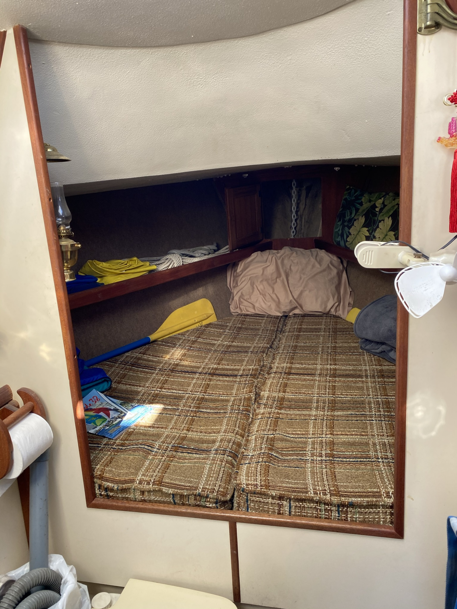

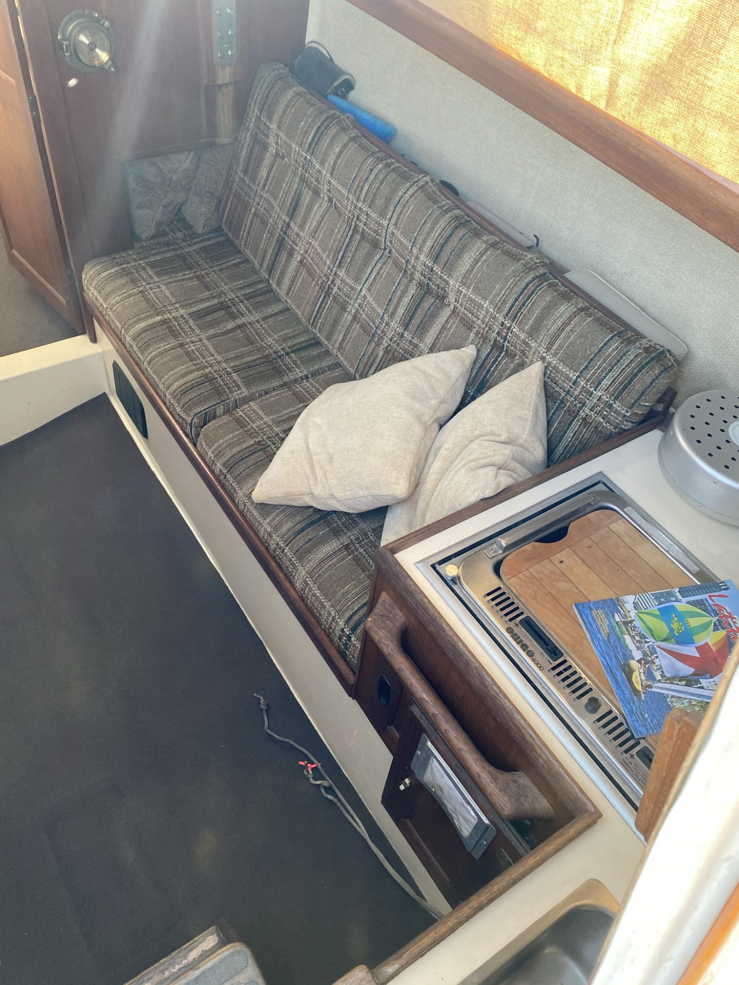

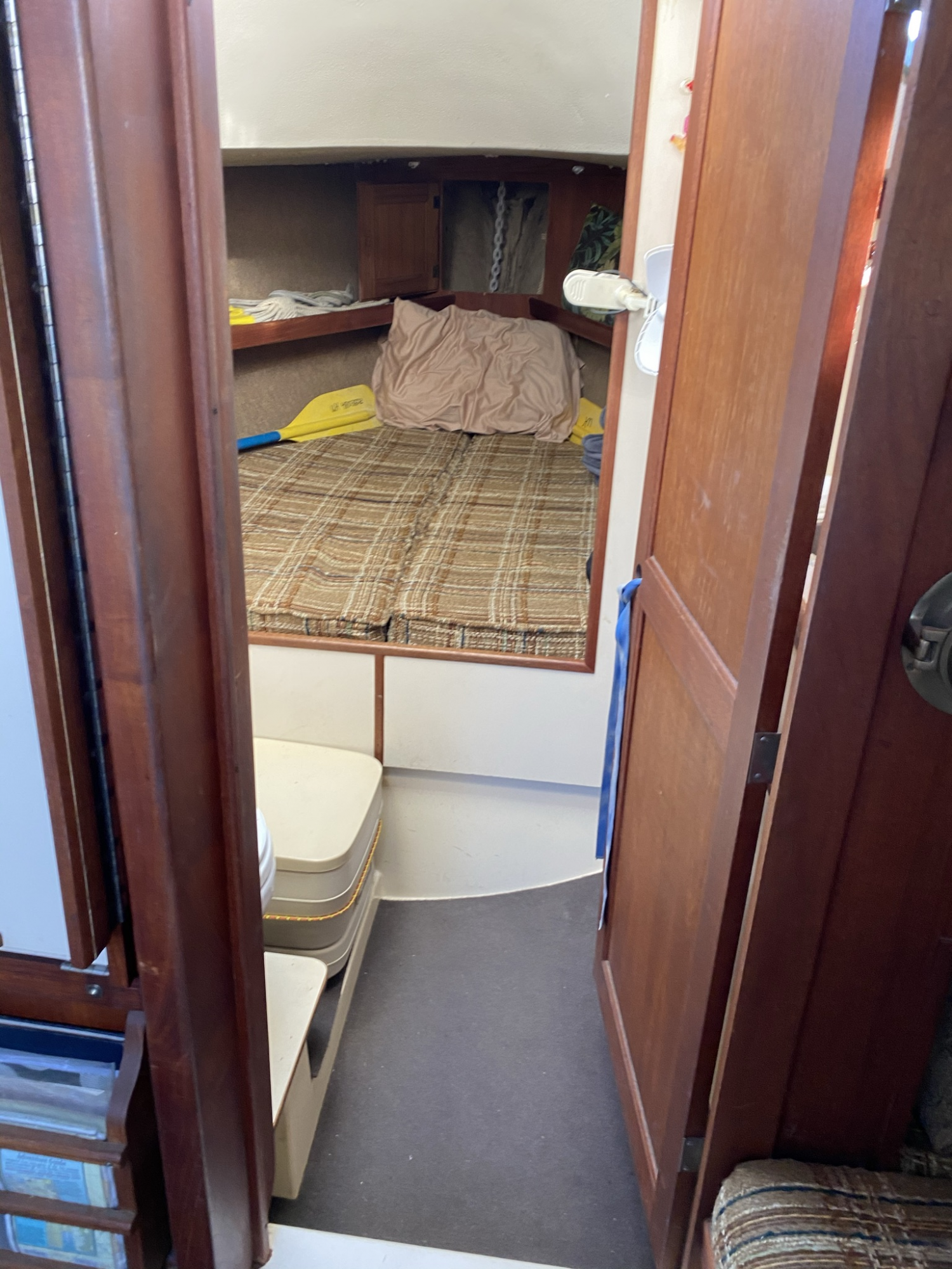

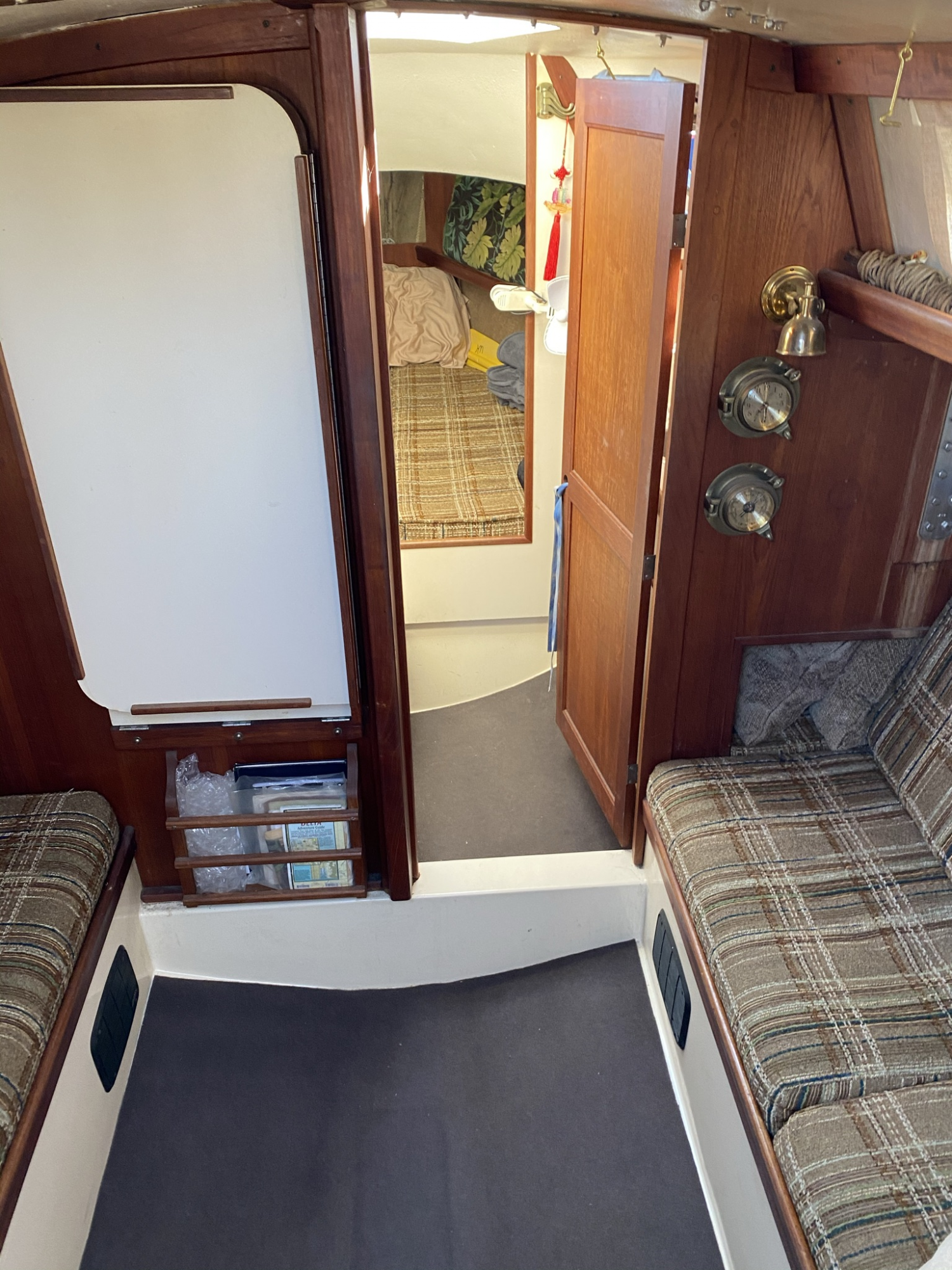

Down Below/ cockpit
  • New head, but has 'illegal' straight through the hull connection. New porta potty just in case
  • Smells clean down below, especially for a 44 year old boat with original cushions
  • Built-in speaker system with remote controlled head unit and cd changer, works
  • Window seals are decent
  • Generally clean, can use a coat of paint and varnish here and there, as expected
  • Plenty of room for a few adults to hang out comfortably
  • New VHF radio, somewhat new refrigerator unit
  • Everything works

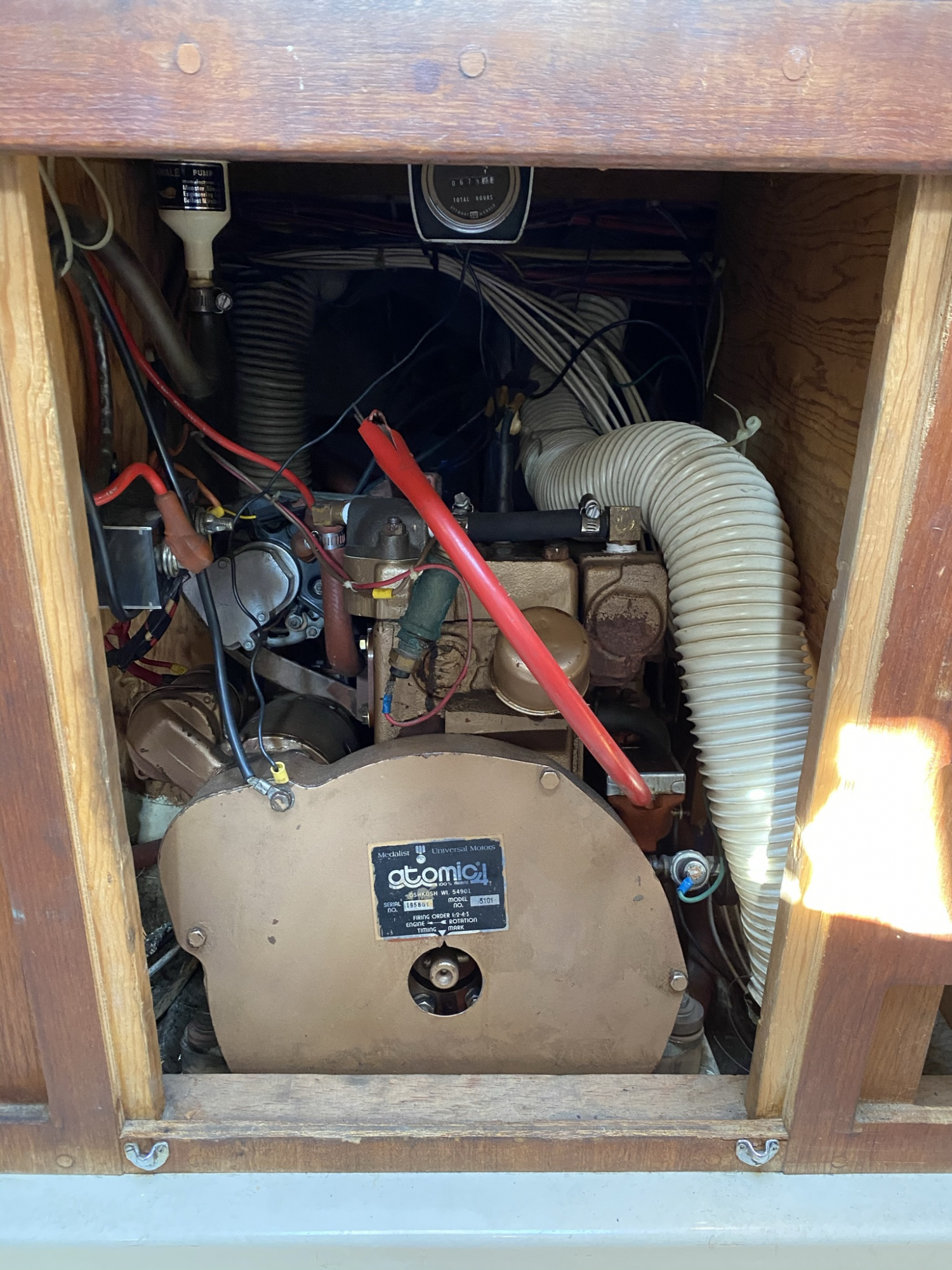

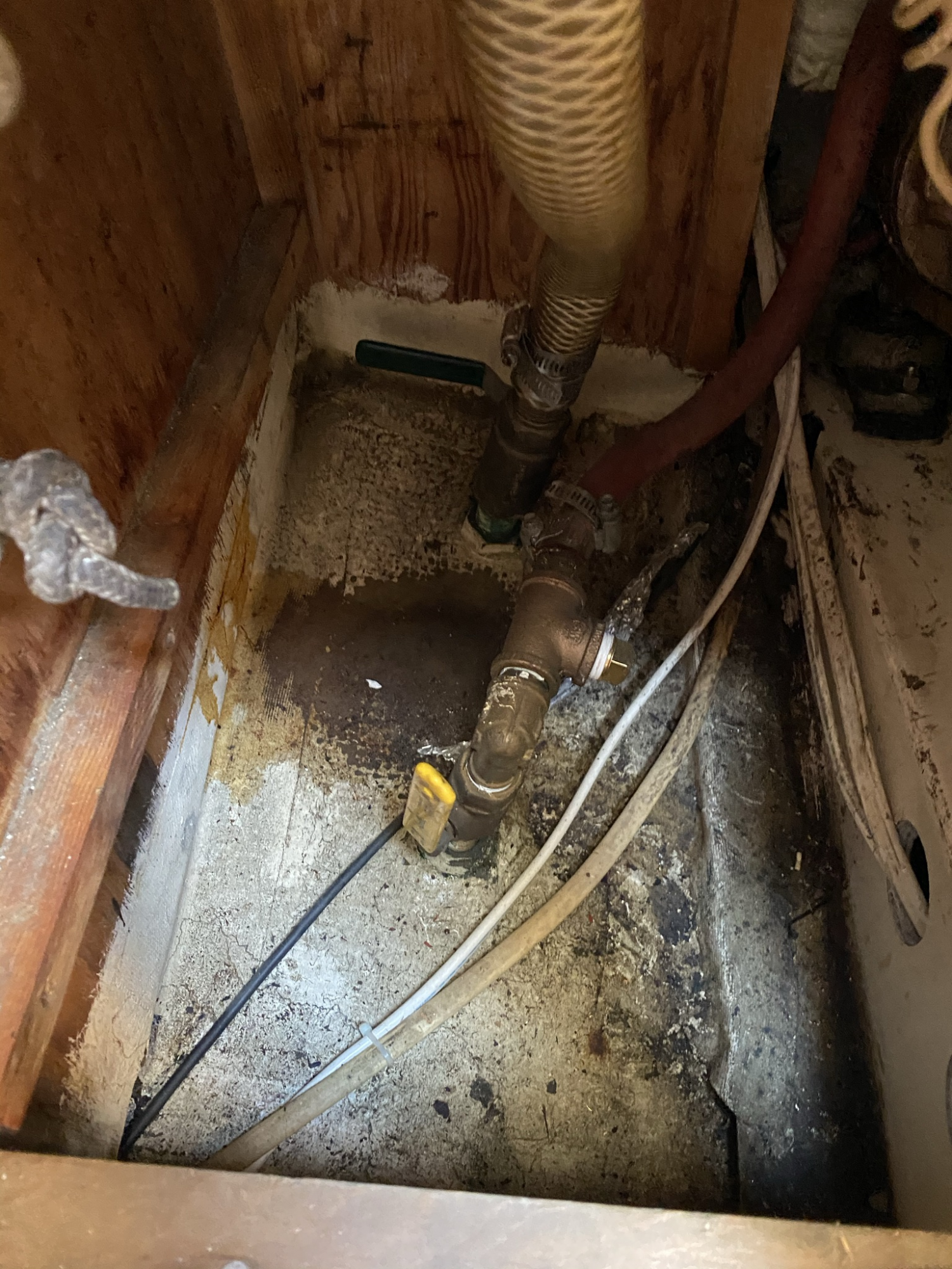

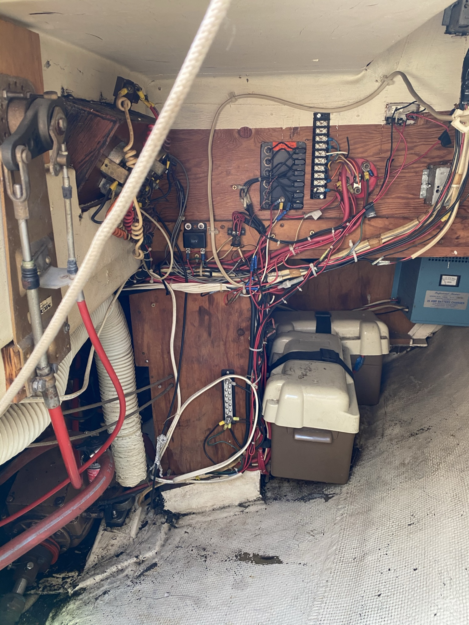

Engine, engine compartment, and bilge

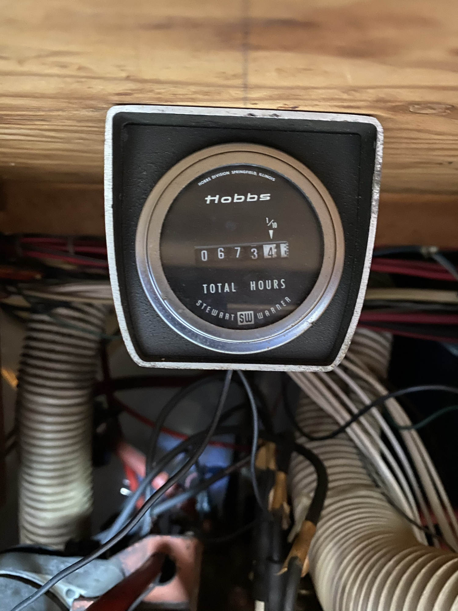

  • This is where I'm where really hoping to hear some feedback since the engine is obviously critical to safety
  • This'll be my first inboard so I've got a lot to learn
  • Original Atomic 4 engine (I think)
  • Hour meter says 673 hours - is that low?
  • Some corrosion on engine, but starts right up and has been maintained
  • Decently organized engine compartment, will be cleaning it up over time
  • Exhaust looks clean, clear water coming out of pisser
  • Plan on testing compression
  • Raw water intake > have been reading about options for upgrading this, luckily its been in fresh water
  • Newly upgrade auto bilge pump
  • 3 gel batteries with less than 1 year, charging system for when at the dock
  • Bilge looks decently clean, I think...
On the topic of the survey, I really appreciate everyone's input, valid points on both sides. I've decided to hold off on the survey for now since my current marina doesn't require it, but I plan to get a thorough inspection of everything including the rigging sometime in the next year once I've sailed her back to the bay. I feel confident in the safety of the vessel as is, which was really my main drive behind the survey initially.
Let me know if you see any major red flags!

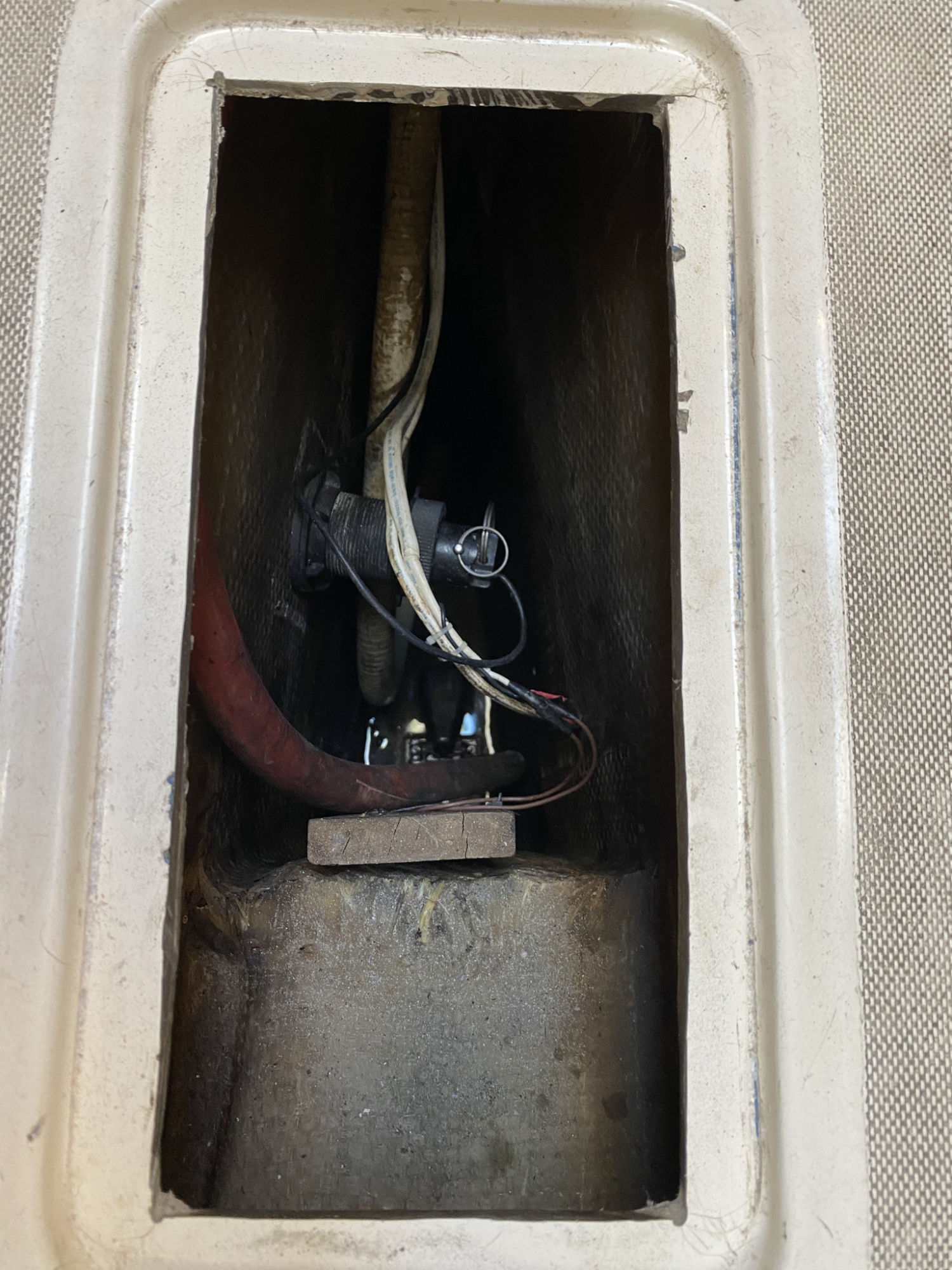

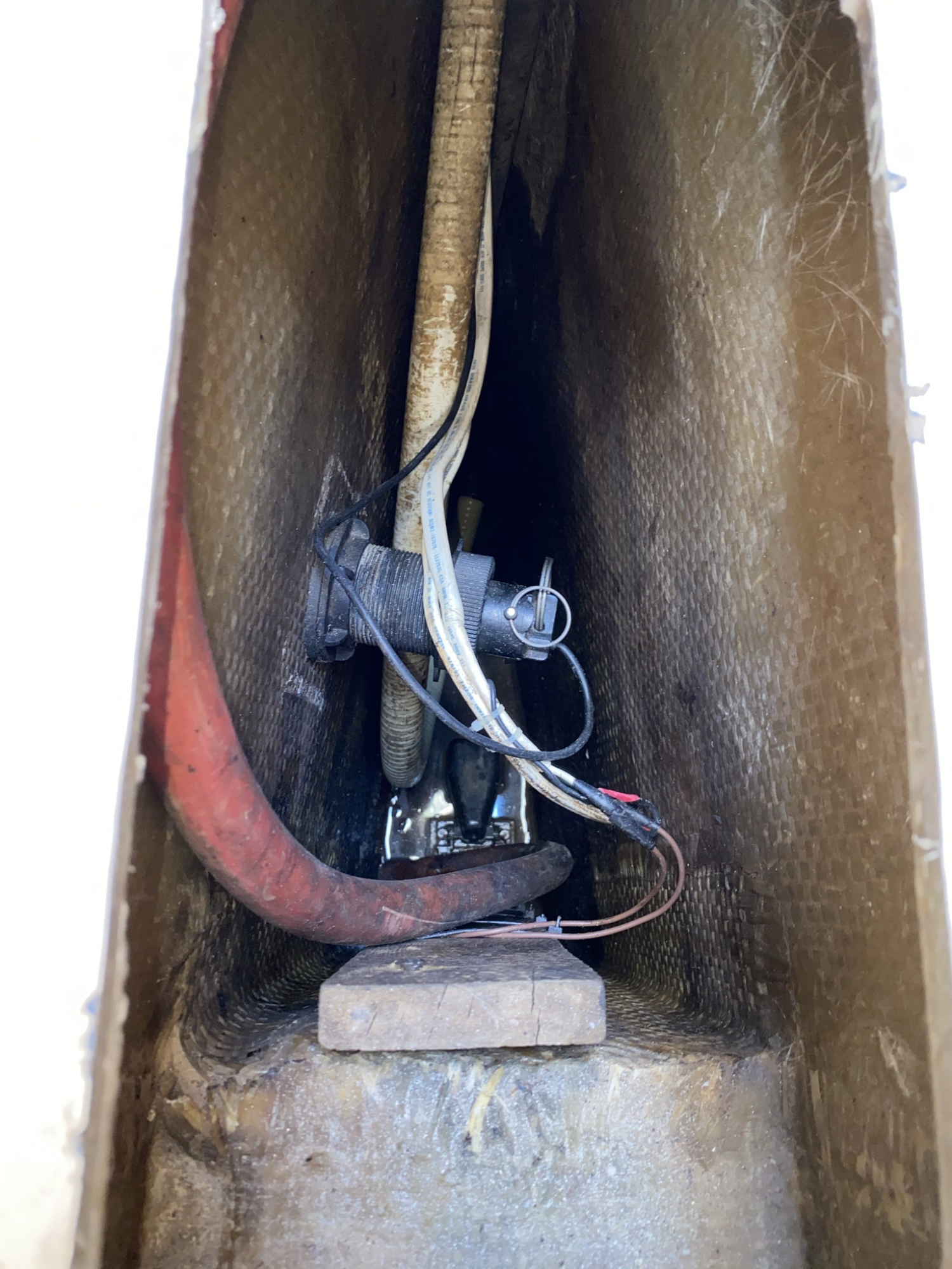

It's really hard to say from the pictures but it looks fairly good. The crack at the forward port side of the cockpit is a little concerning. The exhaust looks like it will need to be replaced fairly soon. Other than that the engine sounds to be in decent condition. If it starts easy, doesn't have black smoke in the exhaust then the rest is fairly easy to fix. Some of the wiring looks a bit sketchy such as the electrical tape on the water pump wiring but I'm starting to realize that is not too uncommon, still not safe. Flaking paint is a pain to deal with but not a huge deal.
The Loran is a nice artifact :)
The negotiated price seems fair.
Paying 20% of the price on a survey doesn't seem like money well spent. One thing you may not catch that a surveyor would is moisture in the deck. Keep an eye on the stained bulkhead.

a lot of things look good, for sure. being that you asked. the last photo in post #23 shows peeling paint on the overhead. prolly a moisture issue. that and a full look at the crack in the cockpit. look inside and underneath.

Thanks for the words of wisdom @jon hansen, the peeling paint definitely caught my eye as well, hoping that's not the result of anything too serious. That is a really good call to check underneath the cracks in the fiberglass, I'll put that toward the top of my list of things to check in case any water is getting in there.
