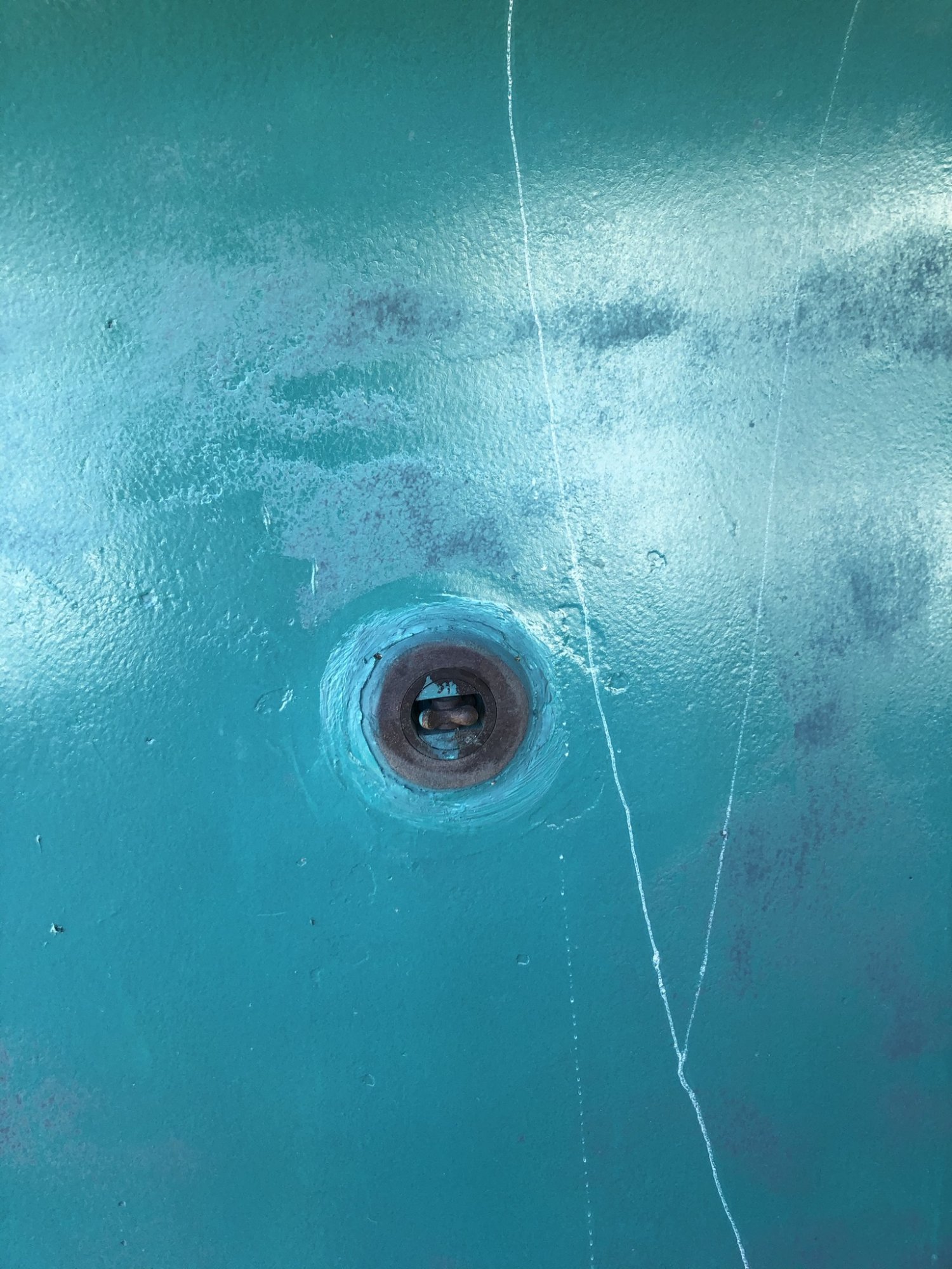

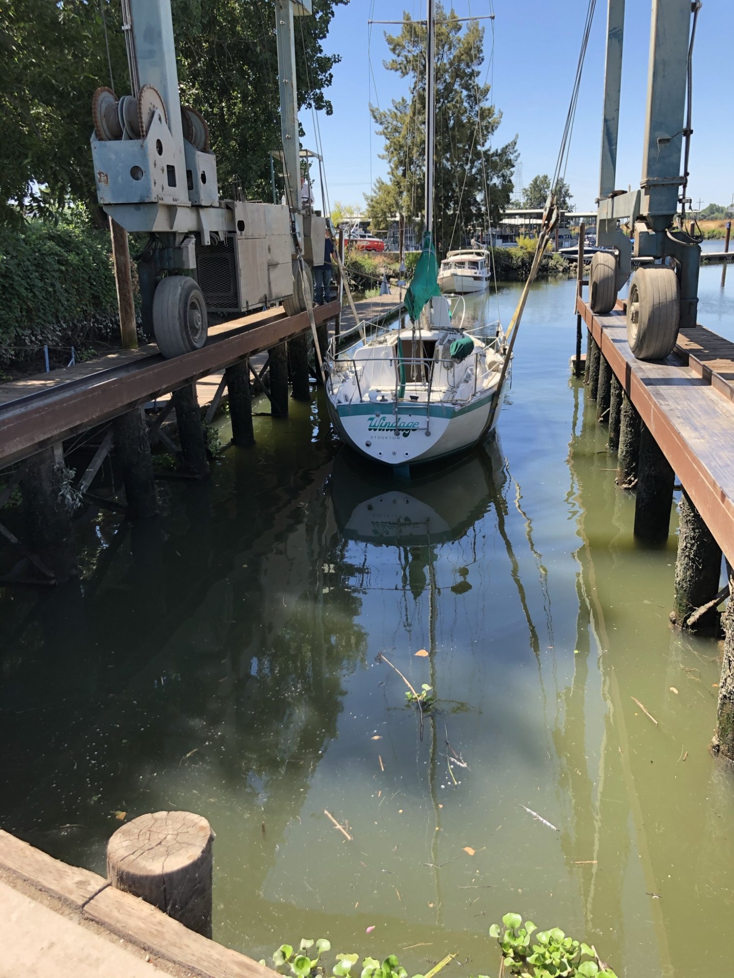

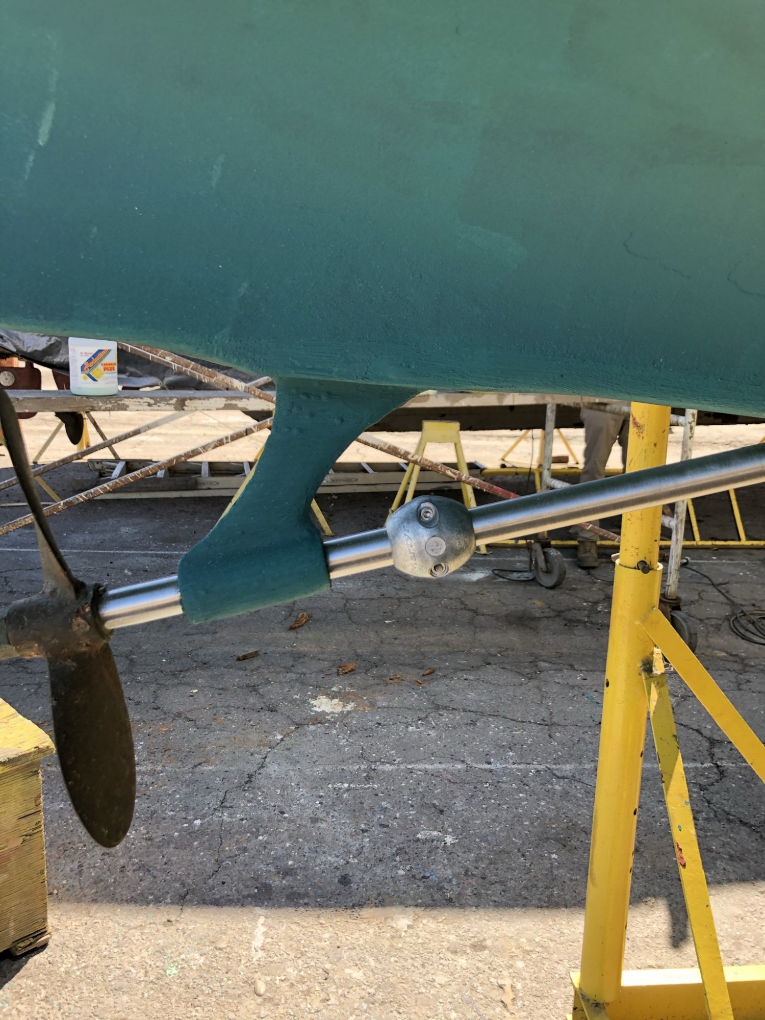

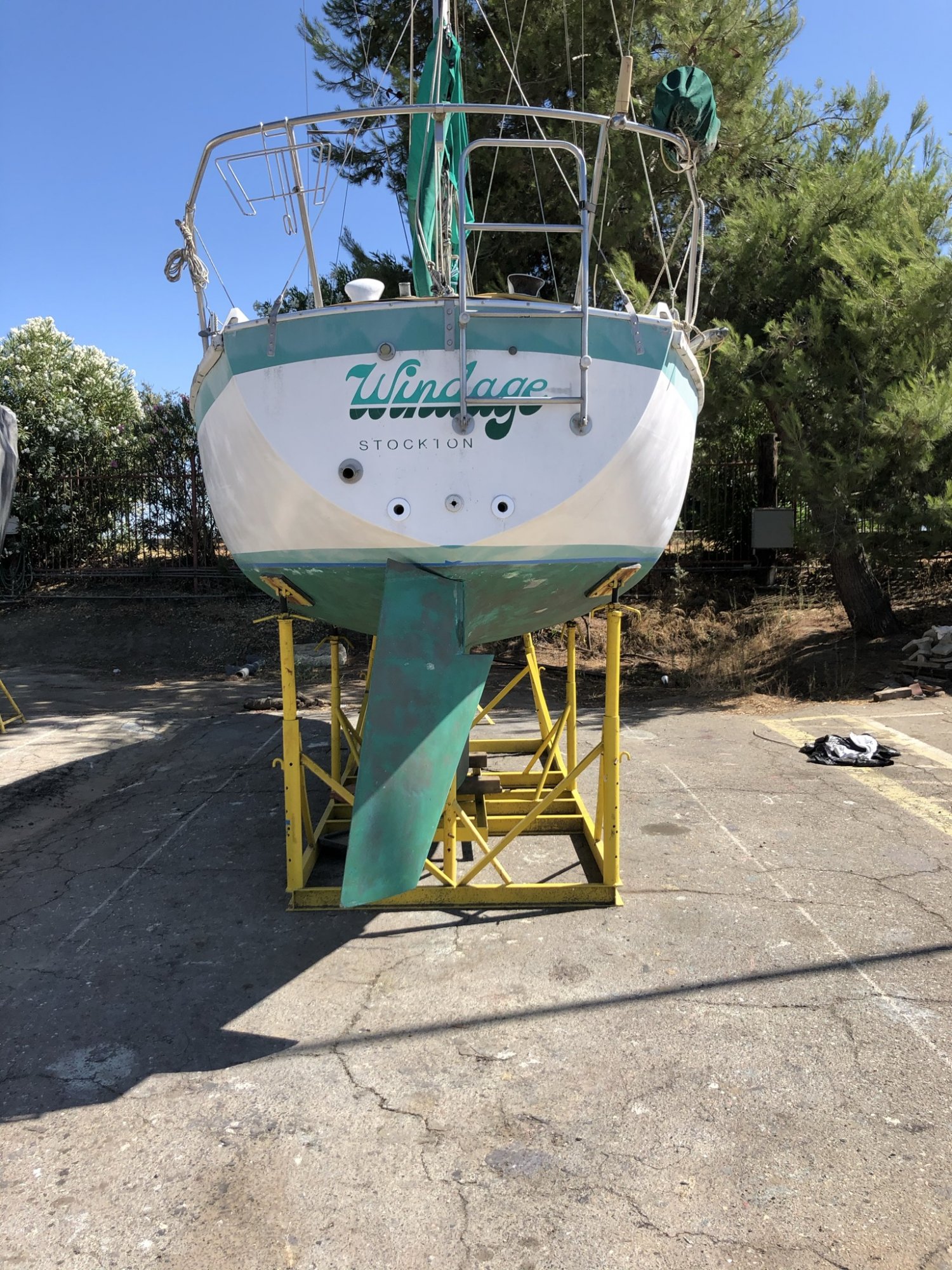

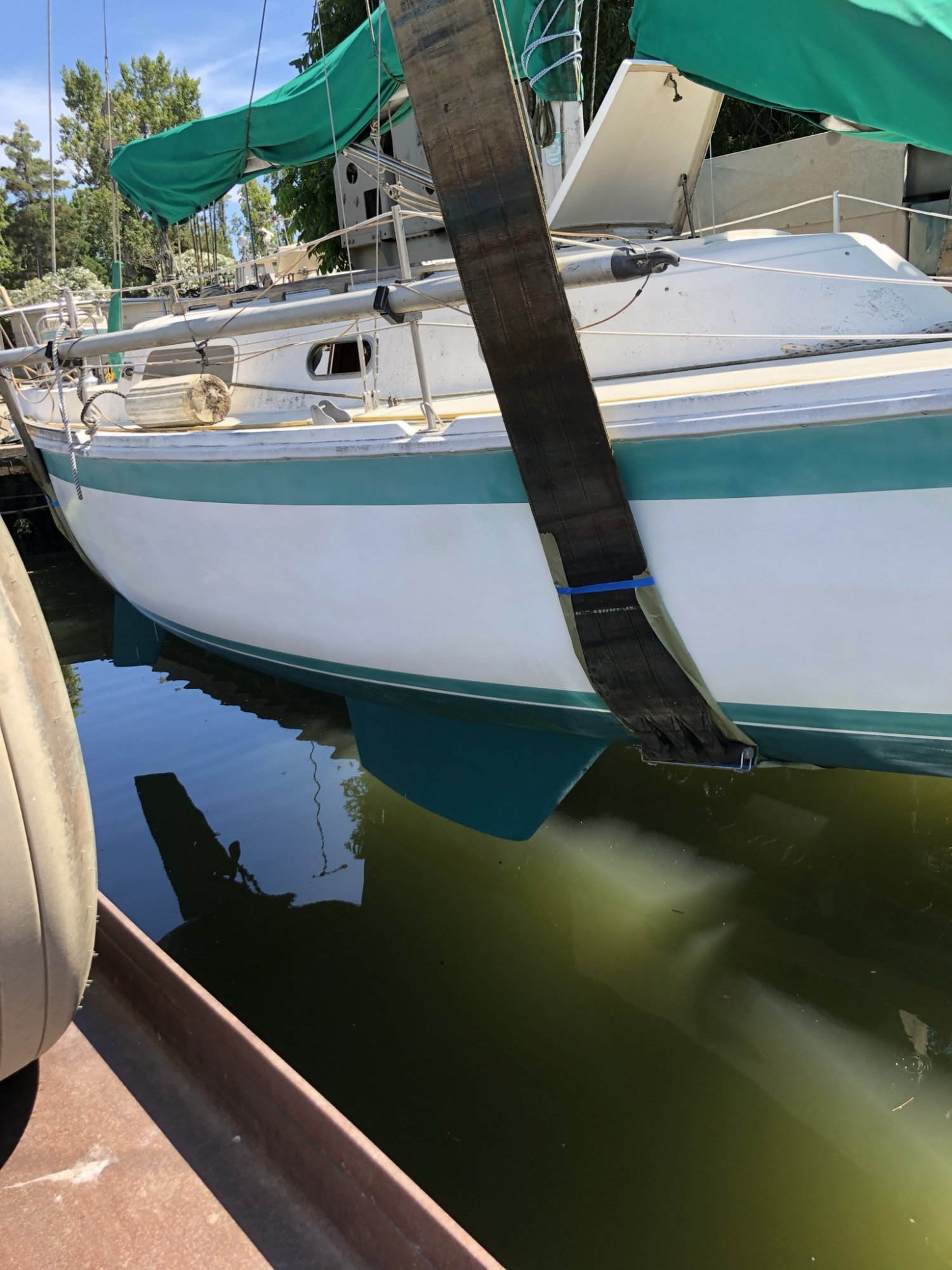

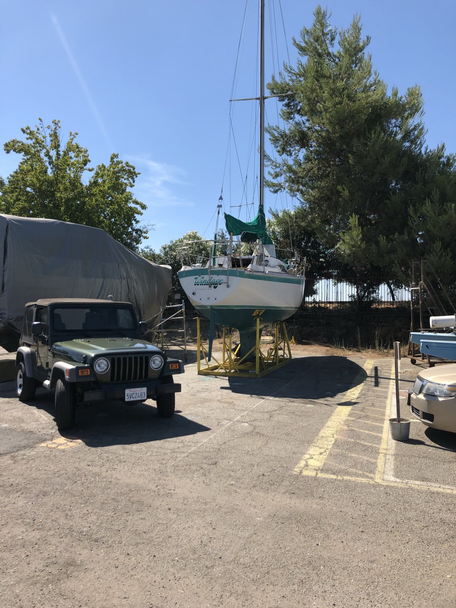

A little update - Talked to the guy today, he is 70 years old and is selling this after the recent passing of his wife. He is very kind and seems like a stand up guy. Apparently they loved this boat though and used to sail/ race it every weekend for years with folks from their sailing club. I am going to take a look at the boat tomorrow so I'll get to take a closer look
Here are some photos from Aug 2019 when the boat was out of the water last, currently berthed in a fresh water river:
Kind of funny how stuff works - I have a little 2dr green jeep too, and we are both named Mike...
Will post an update here tomorrow after seeing the boat in person, hopefully with good news!
