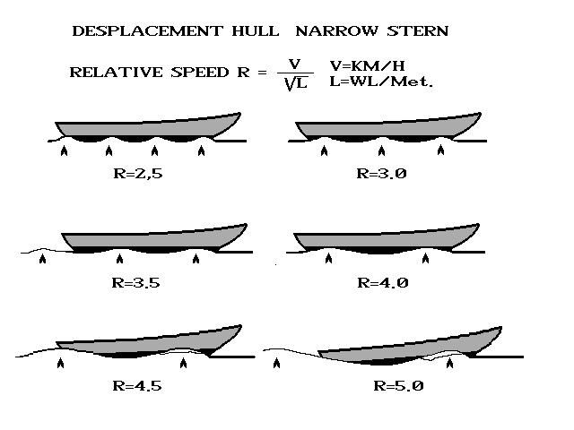

How is it that a boat with a longer longer waterline (and more wetted surface) has better performance?
Here is a picture that illustrates hull speed. Basically your bow pushes water away. That water rushes back in to create another wave. If your stern can ride that wave like a surfboard, you can keep going faster. At some faster speed (hull speed) your stern has already passed the point where the water rushes back in and now you are stuck simply pushing more and more water away with no stern wave to surf on. The longer your boat is, the faster you can go before your outrun your own stern wave.

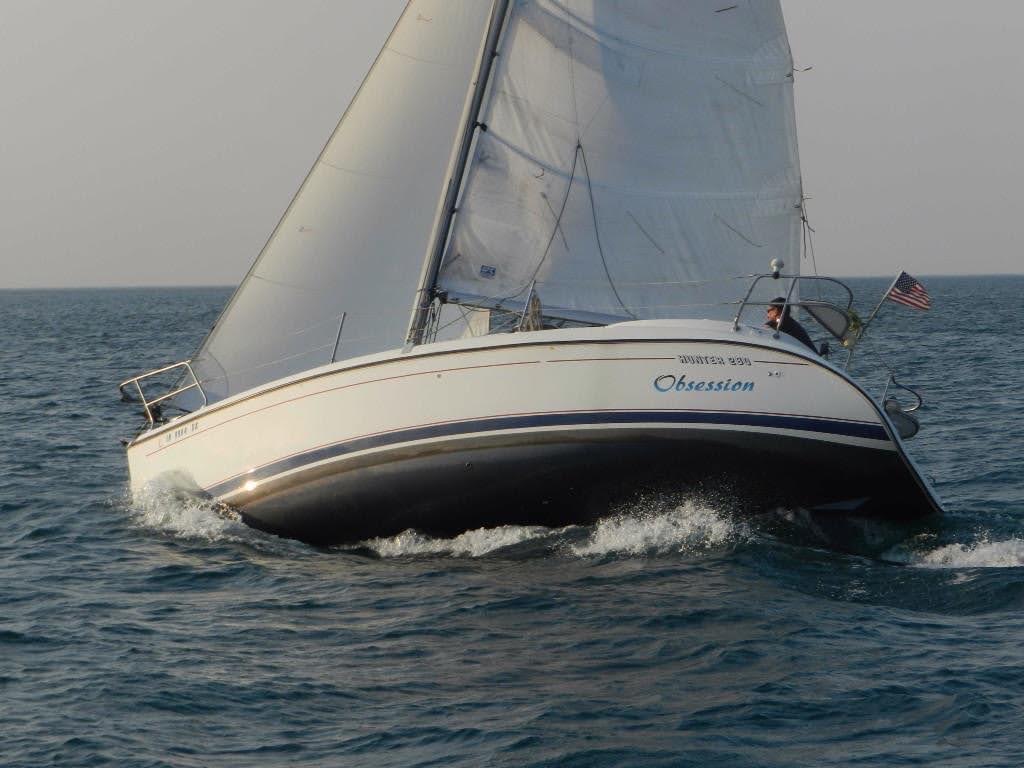

I had a Hunter 280 on Lake Michigan…it was a fun boat, checked most of my boxes….wheel steering, inboard diesel, enclosed head…and she sailed ok…
But the boat was a little light for me, lacked a decent galley, and was the epitome of a “plastic bottle”. No character at all. She was my first boat, and she needed very little maintenance…so from that perspective, she was a good first boat. I actually saw Obsession for sale recently…
