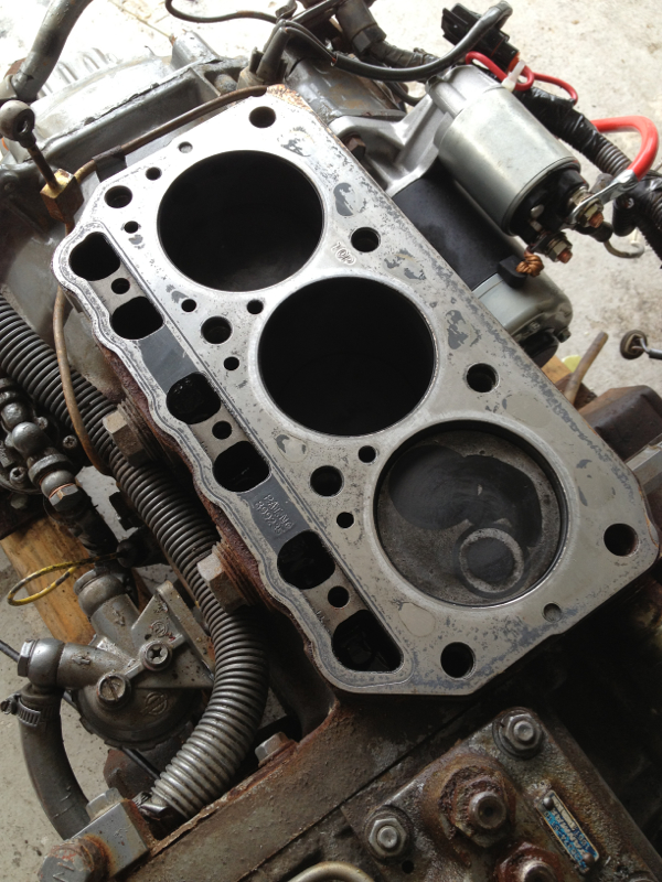

May 7, 2011
45
Hunter 34 Long Beach, MS
Head is off! Cylinder #3 definitely has problems. Here are some photos
I noticed as I was wiping the piston/cylinder clean that I could push the piston down an eighth to a quarter of an inch. The other 2 would not push down on either up or down stroke.
Any ideas? I'd rather not go into the bottom end, I've never done it.
I'll be bringing the head and injection pump in for a rebuild on Monday.
Thanks again for the help!
Sep 4, 2007
795
Hunter 33.5 Elbow, Saskatchwen, Can.
If you can push the piston down. I think you could have a wrist pin problem or connecting rod bearings. Looks like you have it sitting on the ground so not to bad to pull the oil pan. If you pull the pan you can put an oil drain in while it's out.
May 21, 2009
362
Hunter 30 Smithfield, VA
Yup, you need to go into the bottom. Pull the pan and pop the bearing cap off for that piston. Mark bolts/nuts/rod for orientation so that everything is reassembled in the exact position it is now. Hopefully the crank isn't damaged. Check rod bearing clearance with micrometer or plastigage. Might be wrist pin. Let us know what you find. Glad you posted pictures.
May 27, 2012
1,152
Oday 222 Beaver Lake, Arkansas
Woah woah woah. There is no possible way you have 1/4 inch play in the bottom end. First, the rod bearing couldnt offer that much room unless it was not there at all. The wrist pin could have that much, theoretically, but the bottom line is that the engine would have made so much knocking noise they would have heard it clanking a mile away!
Turn the crank by hand until each piston, in turn, is half way in its bore. Now, carefully and slowly rocking the crank right or left without moving the piston will indicate if there is in fact any reasonable play. Note also, the rings will make some noise as the piston reverses direction, often a clicking/snapping sound. But as noted, if the motor is out, just drop the pan and look at the rods and main bearings. NAPA sells "plastiguage", ask for it by that name. Get two or three different sizes. You remove a bearing cap, place the string on the bearing, reinstall the cap and re-torque the bolts. The string is squished flat to a width indicative of bearing clearance. Now remove and read the scale on the paper envelope the string came in. It will indicate oil clearance and is a very good indication of bearing wear as well as taper (wider or narrower across the face of the bearing).
It doesnt look like the tops of the pistons are wet with oil, so it appears it wasnt pumping oil past the rings. I would take a good look at the valves. Plain rubbing alcohol, carefully poured onto the inverted combustion chamber sitting on a bench so as not to spill, you should not see any leakage in the exhaust or intake ports through the valve seat. I am not sure what your seeing on that one piston, regarding play, but you may watch the crankshaft as you push and note if it turns. There should be minimal play at best. But if its out of the boat, now is the time to make it right, whatever that entails.
Apr 27, 2010
970
Beneteau 352 Hull #276 Ontario
Just an observation, What are those marks on the top of the piston head. They look like marks or stains caused by the Valves. These marks are absent on the other cylinders. Do you have photos of the heads?
