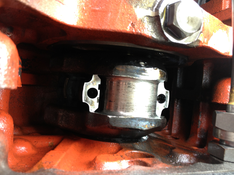

Well. Looks like there is NO Crank pin bushing on the connecting rod! I mean its sitting in the bottom of the oil pan....

Only a place that actually works on crankshafts will be able to determine if its got any life. Engine machine shops generally do not have that kind of equipment, and those that do, should often be avoided simply because they don't do enough work to be really good at it. When I lived in Minnesota, Crankshaft Supply, in Minneapolis, was known all over the 5 state area, they were that good, and quite reasonable. Even down here in Arkansas, I would not hesitate sending them a crankshaft.
All of that said, what I see in your pics, its doubtful that crankshaft can be saved without welding. The radius areas are totally gouged. Even without that, its simply to rough and if you found a bearing it would fail immediately. Its needs a lot of repair to ever hope to run it again.
Also, diesels, as a rule almost always have crankshafts of forged high grade steel alloy which are then heat treated and nitrided. Its a hardening process to the bearing surface that makes its extremely hard and long wearing. But that hardening is only about .010" thousands of an inch deep, and yours is clearly gone.
I would send the crank off to some reputable crankshaft service company (do this yourself/avoid the local machine shop), and have them inspect it. In the meantime I would try and locate a replacement, if one even exists or is affordable, and wait for the verdict. Welding a crankshaft is not the best option, it defeats the whole purpose of having a forged steel crankshaft. But on an expensive or hard to find crankshaft its often the only affordable option. Done properly its not generally a problem, in fact some companies have actually sold it as an improvement. They grind the surface down much smaller, then build up the surface back up oversize with weld metal of Chromemoly, a very hard alloy. Then its machined back to new limits, oil holes are re-drilled and chamfered, then its heat treated and nitrided.
Also, that rods probably gone too. Those you DO NOT want to weld. The block is full of metal, needs to be thoroughly cleaned and flushed and oil galleries reamed with pipe cleaners. If the crank shop feels it can be welded and repaired, they will request you first have them test the crank for cracks. I would absolutely pay to have that done. They will not guarantee the crank without it.
I think I would spend a few hours on the phone seeing if you can find parts, first. See if you can find a new rod and good used or new crank, and what they will cost. You may find your so far upside down on this you might be better off looking for another motor. I know it sucks. I been burned more than once this way myself a few times.

Thats not quite correct. Your crank journal is FUBAR. If it can be ground without welding (which is doubtful), it still needs to be refinished to undersize. Micing it now is almost useless, other than to determine if it could be ground. And only after its on the cutting machine will they truly know if it will clean up.
Cranks start off at a standard size. Then the manufacturer sells standard size bearings, and undersize bearings. Undersize's are -010" smaller, and possibly (if offered), -.020 and in rare cases -.030".
Let be be clear. Your crankshaft will not work as it is, at the very least it needs to be ground. You need to remove the crank and have a reputable (highly reputable) shop inspect it. Further, most crank shops will ask you for specs on the cranks dimensions and journal sizes, radius size, etc., please provide it for them if at all possible. They also often like you to provide the bearings, and they will match the crank to them perfectly. But as you wont know what size youll be at until they start grinding, thats something you can figure out later.
Let a shop look at the crank before you proceed with buying parts. And they need it out to look at it. Whoever LaBorde is, you seem to trust them? Tell them you spun a rod bearing and tore up the journal real bad, that the entire bearing shell is missing, and the journal radius's are heavily damaged as well. Tell them it looks like it may not be repairable without welding. Also tell them the rod big end doesnt look so hot either and likely needs to be replaced. Anyone who truly knows engines will understand what your talking about if you say it that way.
If you can find a good used crank and rod/rods, depending on how the pistons and cylinders look, you may be able to hone it and new rings, put it back together. I had similar damage in a Perkins 4-108 some years back, and did exactly that. The crank was able to be ground as it still had a bearing, just was loose and knocking. We had to go down to undersize on the rods and on one on the mains, and I had to find a rod because it had turned blue.
Most likely your engine was run out of oil. Look for blueing on all your rod big ends. If you see any they should be replaced. On the Perkins it had blown an oil pressure sender and emptied itself of oil. I bought it in a skid loader that way, what a mess.
