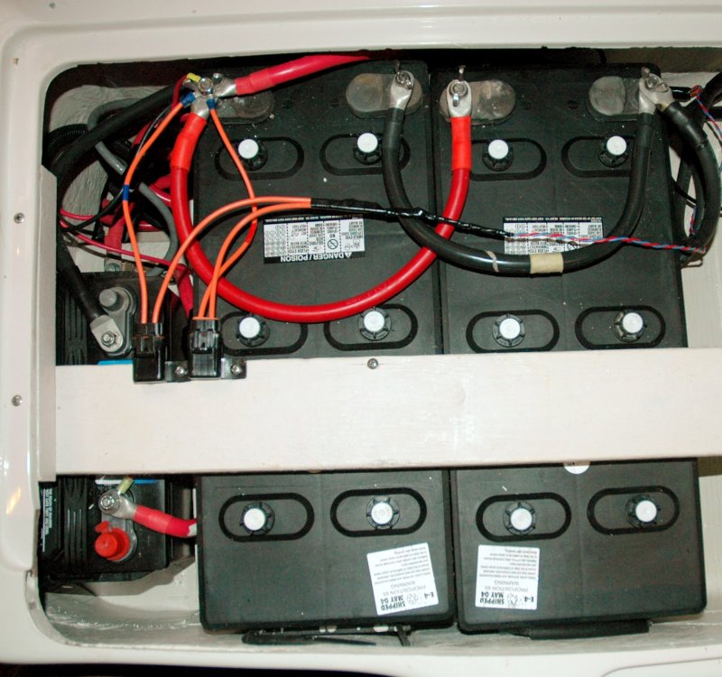

Mine were Exide Nautilus Gold deep cycle 4D's @ 160 ah's each for a 320 ah bank.
If you replace them please do yourself a favor and go with 4 6V batts instead like the Trojan T105's, US Battery 2200's or similar. Easier to move, longer life and more amp hours. They will fit the same foot print as the 4D's yet last longer and give you 450 ah's vs. 320..

P.S. Here's how I buttered my batts up and slid them in on my old 310. This was during the test fitting. I was able to get a battery box in around the start battery..

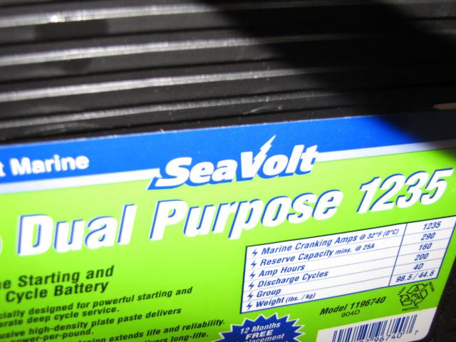

Does anyone know the name/type of lead acid batteries on the 310. Also is there any information out there on them. I may replace my batteries this year and would like to know more so I can make an informed decision. I have the stock batteries.
