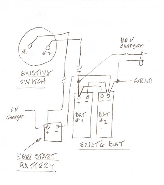

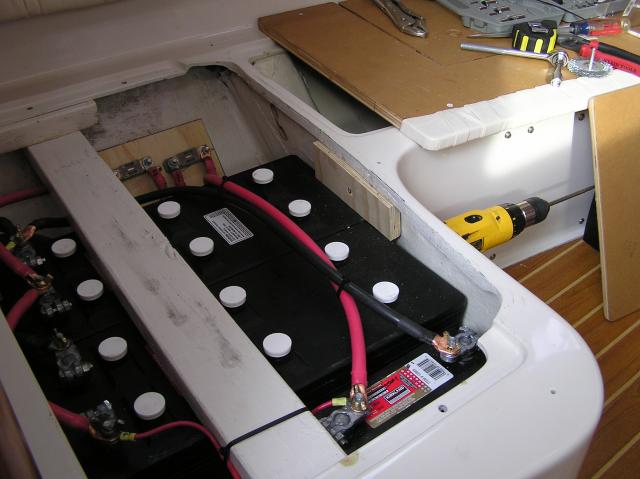

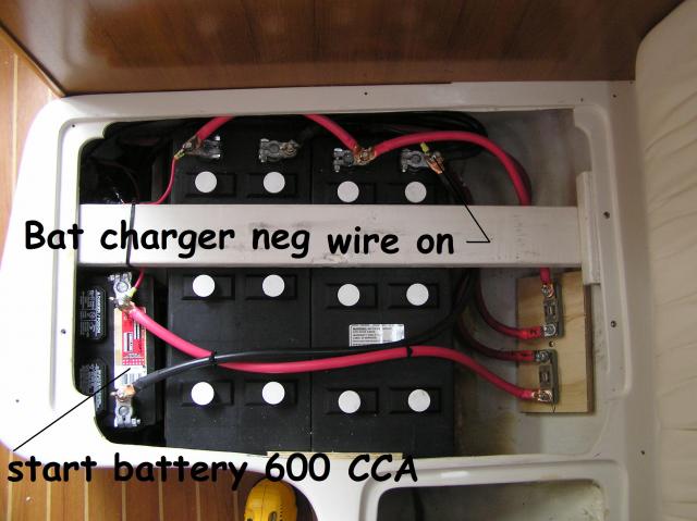

Tom,,, could you send me the information regarding the type of switch you installed for the batteriesand the automatic charging relay.I also have a 2003 model 310, hull #231, and I added a start battery circuit, much as Scott did. Probably one of the best upgrades you can add to your boat, especially if you are going to replace your batteries anyway.

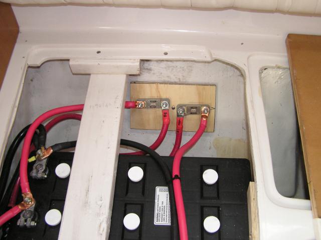

In addition, I replaced the 1-2-both battery switch with a switch that isolates the house bank from the start battery. Then I installed an automatic charging relay that first charges the start battery from the alternator, and then automatically charges the house bank. Upon engine shutdown, the start battery is automatically isolated from the house bank. Works great!
My understanding is that the house bank should be connected to the alternator output first and then the reserve bank through the ACR. Running all the current through the ACR when the house bank is depleted is unnecessary. Also, the reserve bank is almost always completely full because it only takes the equivalent of about 2 to 5 amp hours to start the engine. You may want to consider making that slight change to your wiring. The downside of the dual circuit switch is that you do not have the operational flexibility of the old 1-2-B switch (like Paul's setup), in that you cannot use the new switch to run (limited) house loads off the reserve bank if your house bank fails. Otherwise, nice upgrade.Then I installed an automatic charging relay that first charges the start battery from the alternator, and then automatically charges the house bank. Upon engine shutdown, the start battery is automatically isolated from the house bank.
