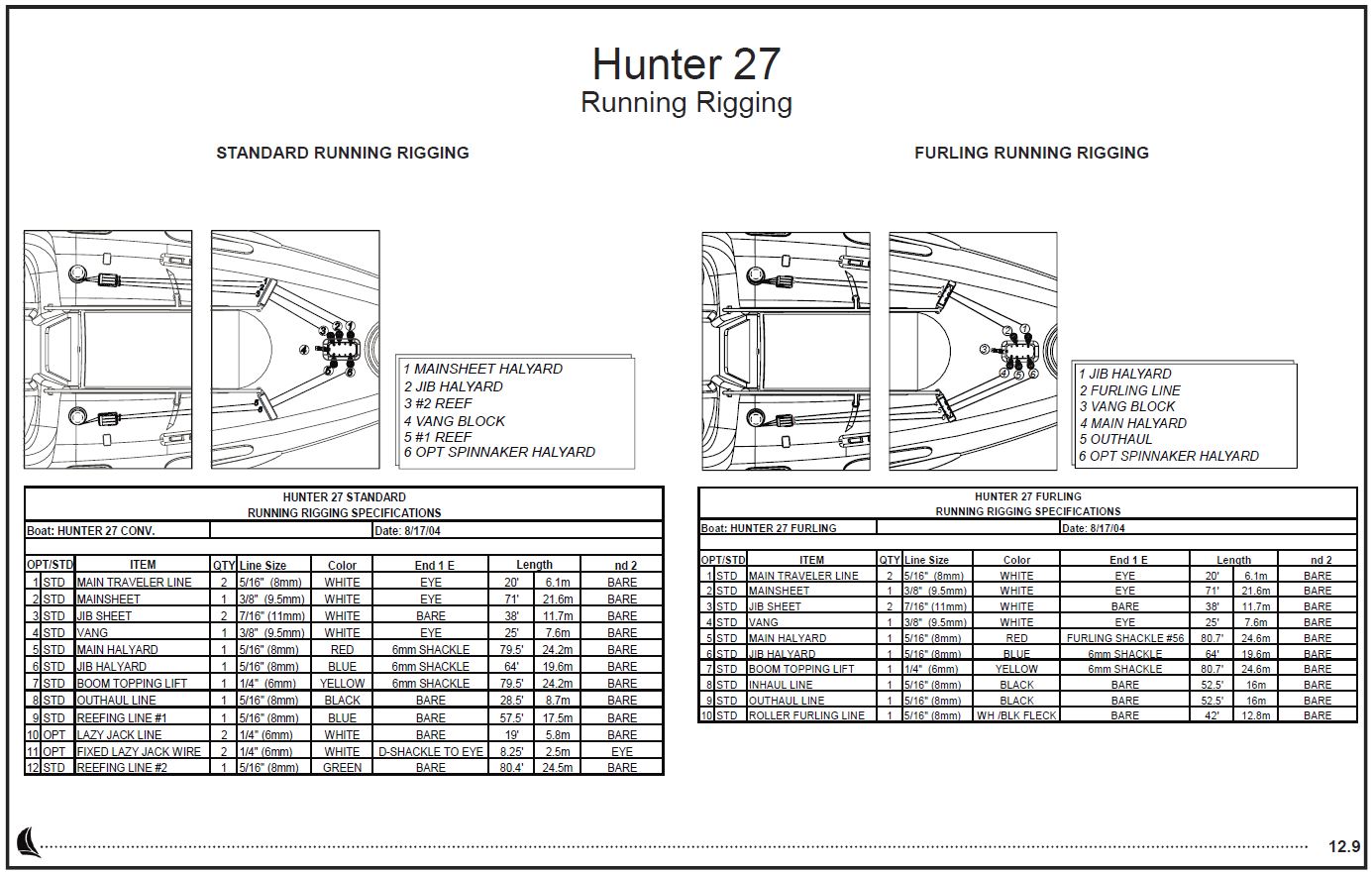

Or you can use a rigging calculator to get a real good estimate
https://shop.hunterowners.com/cu/detail-rrc.php
How accurate is that calculator?

The running rigging chart is dated 2004. I don't think it is for a Hunter 27 Cherubini.
Look at the rigging layout is it that dissimilar not to use it as a guide?
And if you follow the link and see what you can find you just may find what you are looking for sure beats having no direction at all!
