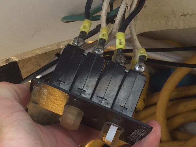

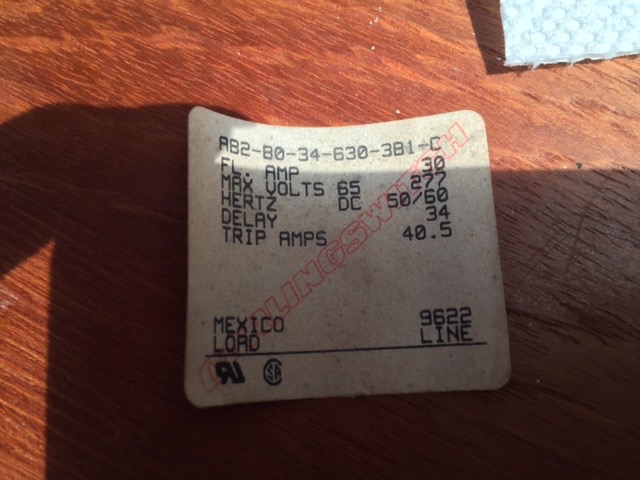

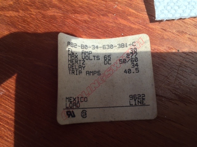

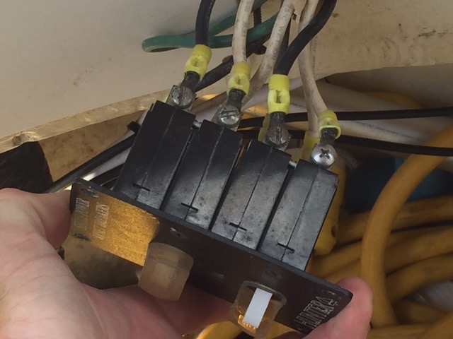

JamesG161
Feb 14, 2014
8,111
Hunter 430 Waveland, MS
After 14 year, I had to replace those weaken breakers. Dual Breaker for A&B.
This is my Lazaret Breaker Pair.
The Label I used to find the Replacement.
Only the B input was tripping like yours.
As you might see, you buy the Pair.
380 breaker
______
I'm also going to check the air conditioner cooling water filter
I think you mean Strainer.
How will you start your AC system without power?
No power, no AC cooling water flow.
Jim...
