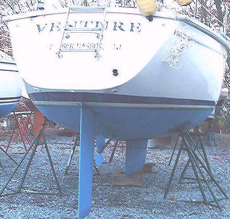

I was actually on-board a friends 33-2 last night and found no signs of core and even sapped a few shots and looked in the locations you indicated. I have a guy interested in one and this one may be for sale so I was there for other reasons but did get to poke around quite a bit.
My friend installed an Airmar transducer forward of the keel and found solid glass in a freshly drilled hole. This I would not suspect odd even in a cored boat as usually the center-lines are solid glass. My guess is that they either hid the core very well or some of these may have been built core-less hence the confusion? I can't imagine they built cored and core-less models of the same hull as a production builder. Morris does that, they'll do what ever an owner orders, but I doubt, as you do, that Pearson would have.
I found no core transitions/humps that are indicative of a core sandwich nor any visible core through the greenish/semi-translucent fiberglass below water.
I forgot to ask what year his boat was but I recall it being a 1990? I have also seen a 1990 P-31, same vintage hull design, that nearly tore the keel off and there was no core in that boat either, at lest within a foot or two of the keel, but perhaps they started in the 33-2 and the 31 was solid?

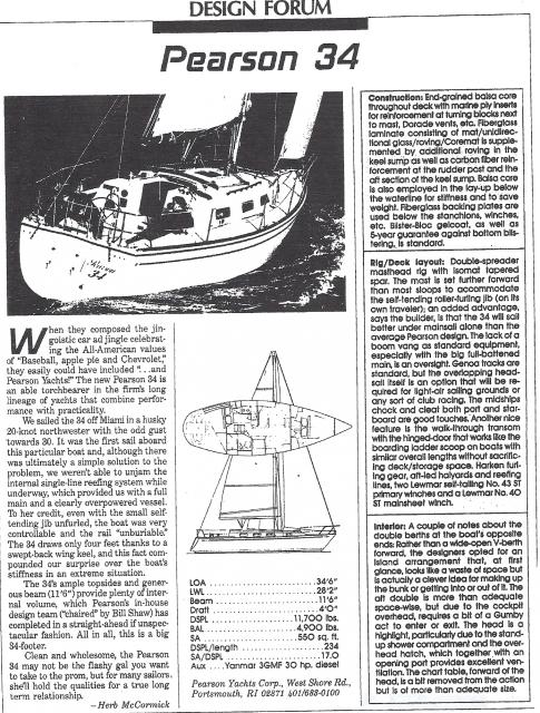

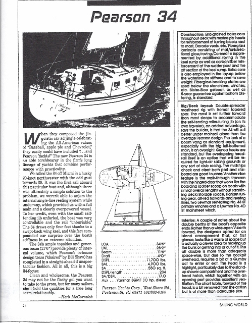

Pearson Mark II series
With the help of Maine Sail, I will be posting the article written in Sailing World by Herb McCormick in the "Design Forum" stating the Pearson 34-II is cored below the waterline. I hope this sheds light on the ubiquitous confusion concerning the Mark II series of boats produced by Pearson shortly before their demise. Best, Ron
280
Hunter 25_73-83 NORTH POINT MARINA/WINTHROP HA IL
In spite of the amazing amount of confusion concerning the Mark II Series sailboats manufactured by Pearson before their demise, there is a definitive source published by Sailing World in their Design Forum by Herb McCormick announcing the introduction of Pearson new series of sailboats. The majority of owners of these boats believe they have a solid fiberglass hull when in fact it is cored below the waterline. When I bought my boat in 1995, it was represented to me as a solid glass hull even though the seller of the vessel told me it was cored. There was no mention on my initial survey stating the hull was cored and it was not discovered until I had a second survey for insurance purposes several years later. Pearson, at this time, did not make "one of" sailboats and repeated this build process until their unfortunate end. I have never been aboard a Mark II series boat that was not cored from the waterline down and I have inspected many over the years. I hope this ends the confusion and I would suggest those owners of the Mark II series to take a closer look at your vessels. You will be as surprised as I was. As a final thought, I have owned my boat for 16 years, have sailed it over 16,000 ocean miles and have had no structural problems with the hull or boat ever. As a production boat, it was well built and loves big water. Upload to follow as the article has exceeded the length for the post. Good luck and good sailing, Ron
