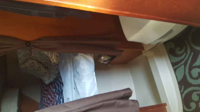

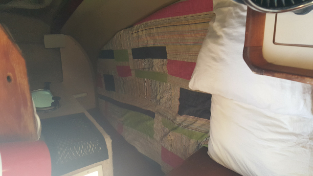

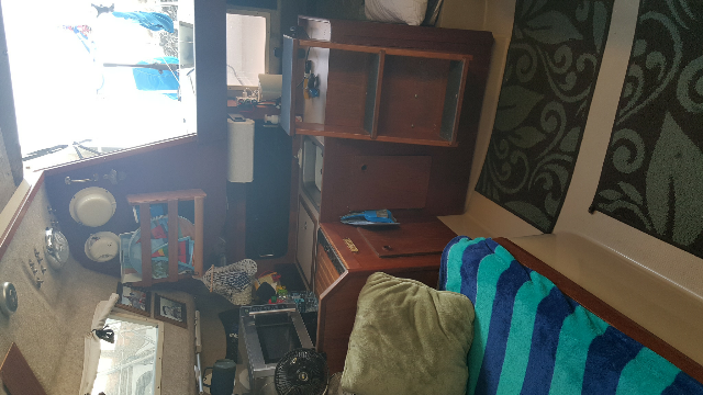

This is my one year review of my 272 I purchased exactly one year ago. My experience as a sailor is about 30 years and I have owned numerous boats the biggest being an Ericson 30+.
I sail her about 3 to 4 times a week year round since I am in Ventura, California. The boat came to me in Great condition. She almost was never sailed because the original sails were in like new condition and no reefing system was ever set-up or a boom vang. The headliner had no effects of mildew or dirt. All I needed to do was add my electronics and cosmetic stuff and set the sails up to my specs.
The interior is roomy for overnight weekend romps to the Channel Islands. 3 people are safe but any more could be possibly be a little tight.

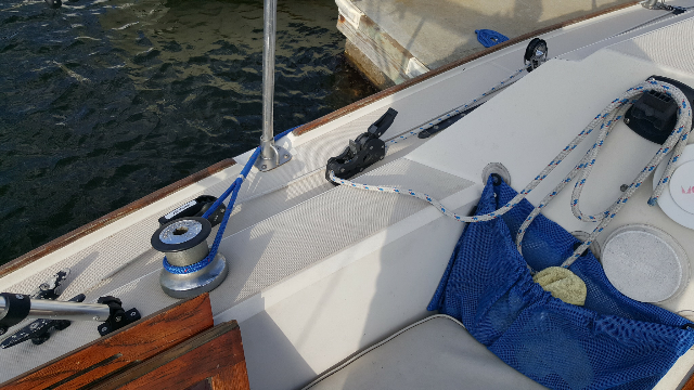

The sailing characteristics of this boat are very interesting. This boat is by far the fastest I have ever owned. This boat moves like no other I have owned. We had a little race this weekend with about 6 boats ranging from 25 Catalina to a Catalina 30 and Hunter 31. This boat won the entire race without corrected time. The winds started at 10k and ended at 18k. A lot of the other boats thought someone had done something to the bottom of the boat because the PHRF rating for this boat is high. I highly doubt that because I recently painted it and did not see anything abnormal. I had to reef this boat at 15k because it was heeling excessively. Tender because of the light ballast. This coming year 2016 I will race her weekly and see how she does. Spinnaker Assym being added to the inventory. Have no idea how she will respond to this. Maybe someone has some input on this.
Added fridge 12V/110
bimini
no dodger because I want to race it.
added rope clutches for jib sheets (excellent buy)
rope clutch for jib furler

Andrew I had that same system you have in the picture. I had to change back because the Cam Cleat created so much pressure it was difficult to release it. No one but me could release the line if the load was over 17k of wind. LOL! Probably because I can bench 450 pounds for reps. My wife weighs 105 and we were under reef, blowing 40k in the middle of Pacific Ocean. Had my wife go in the cabin and hang on the mainsheet to try and release the cam cleat. NOPE! End of that experiment... Maybe a bad cam but it worked fine under 15k. Harken! Anybody ever been on an ODAY 272 in 40k of wind for 18 hours? Not the most pleasant experience but she held up better than expected. Reminded me when I use to fish and waterski on lake Michigan and the northerlies were up creating big waves and we would jump them with our 22 foot Sea Ray. The explosion when you came down was unexplainable.

Well no wonder. That 4:1 mid-boom sheet is WAY undersized for a 27 foot boat.
Even with the 272's modest mainsail, in 15kts there is 620 lbs of load on the sheet assembly. Not even factoring in friction, that is 155 lbs at the cleat.

Jackdaw I changed that S@@T. You have to be able to control that mainsheet under all conditions.
Aug 3, 2012
2,542
I have sailed in 15kts, and that system opens with no hassle. Not heavy. Runs smooth. Never tries to get away. Oh well...
