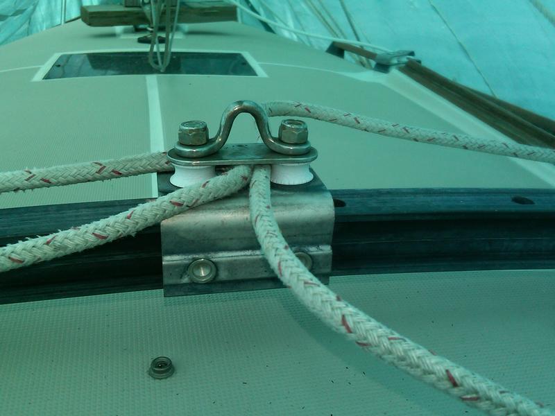

Home made traveler controls
Being the cheap a$$ sailboater I am, I made my own traveler control system based on what a friend did. Here's pics. Way less than spending $500. I don't race though, so I'm not sure if you'll get another 1/2 knot with the store bought brand!

That looks like it does the job. One thing that I wanted to do was get the traveler more flattened out which means changing the entire track. With that arc it messes with the main sail shape.
Nice job!

True. I also re-rigged my curved track to add controls. The darned car would bind under a load when I tried to bring to Windward. It may have been a matter of worn bearings, but the car would tilt and jam on the track trying to come over the top of the curve, so I changed to a flat track.

we did not totally replace the traveler, just put on good adjustable cam cleats on each end along with blocks w/bearings and lines long enough to easily adjust the traveler from the wheel when single handling...actually, all lines, halyards, sheets, etc.
are long enough to control from the helm...I did trip over a sheet while single handling a couple weeks ago while lowering the main I actually fell into the cockpit from the cabin top barely missing my forehead on the cabin bulkhead....Lucklly I have good cockpit cushions that softened the blow. I may not do that again this fall....single hand that is. I'm not certain what O'Day was
thinking when they installed a traveler with no adjustable controls. Pat
