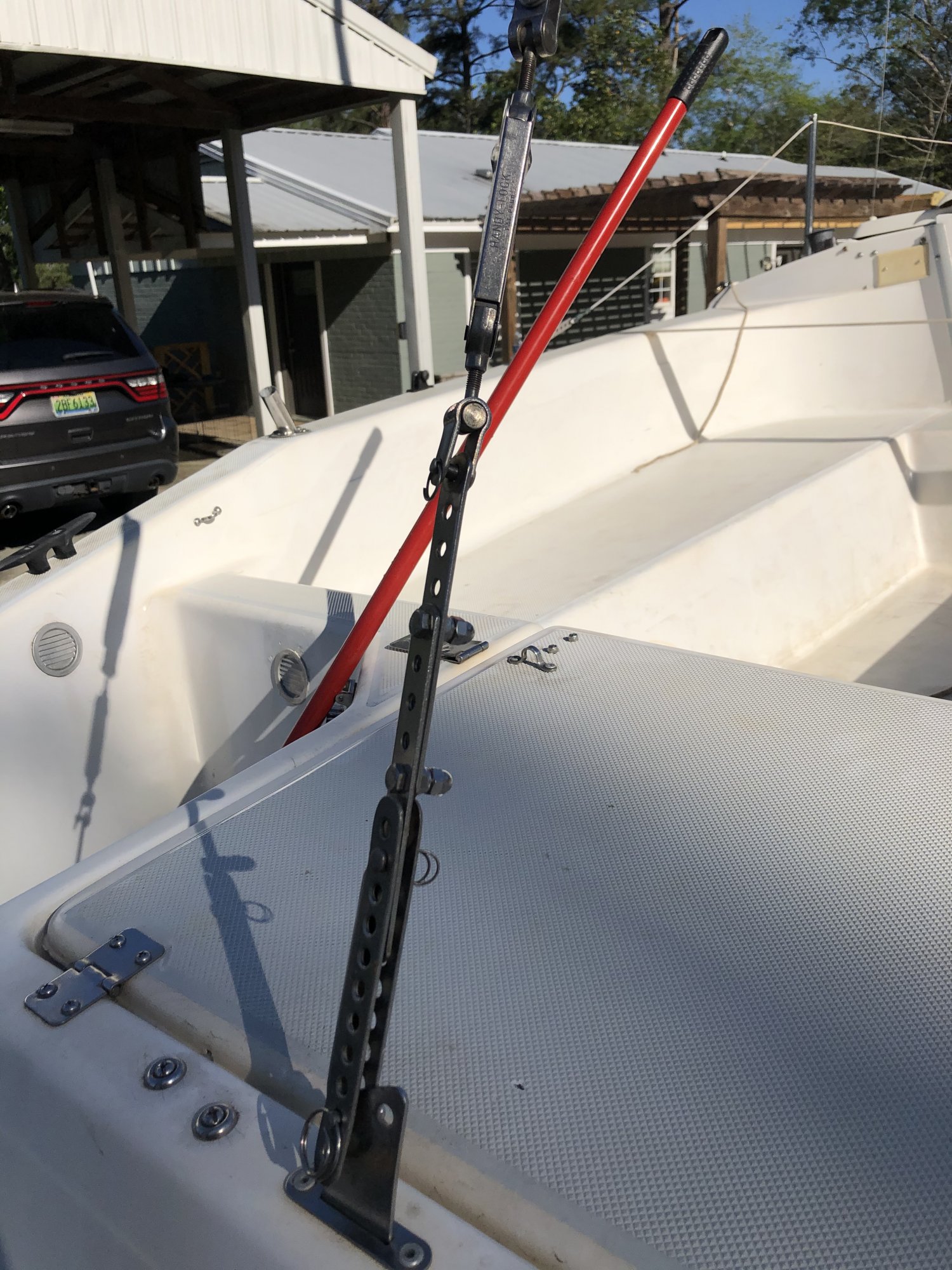

Here is my 1989 26D I just got on Saturday. It took most of the afternoon on Sunday to figure out how to raise the mast. The homemade rig was not working so we cannibalized it and built a new one to keep from spinning on the mast step. All in all under the dirt she was covered in I am still happy with my purchase. Although in stead of sailing her like she is I want to do a complete refit and restore. But before I tear her apart, here she is...

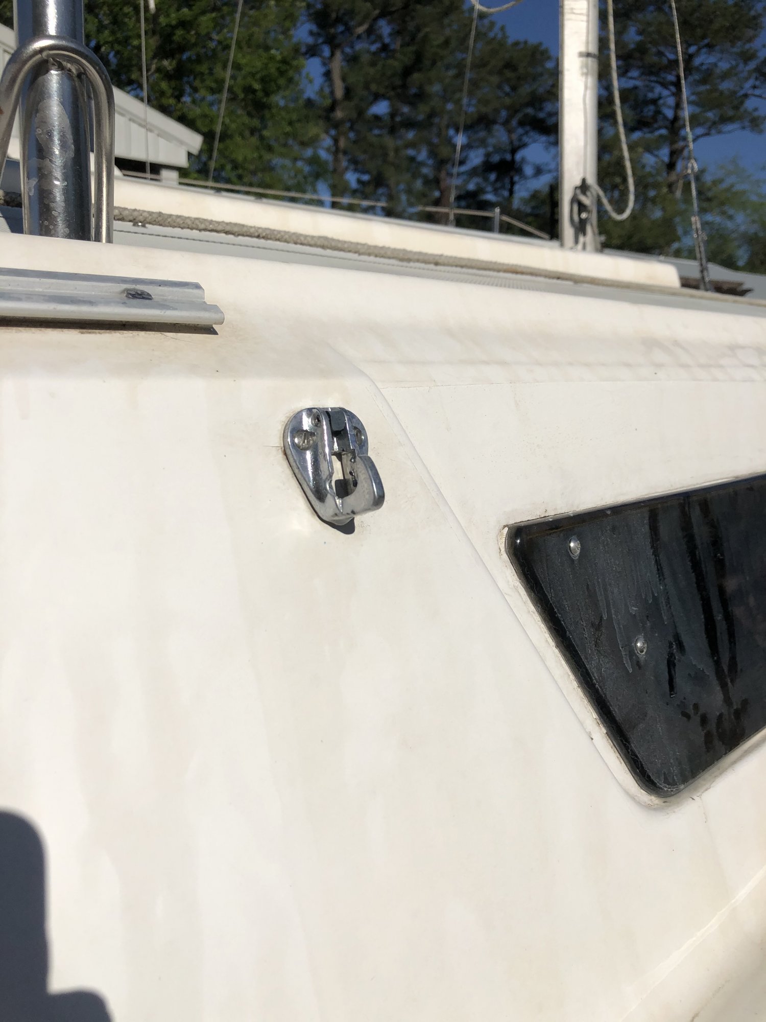

There is a metal "something" on the foredeck can someone explain what this is?

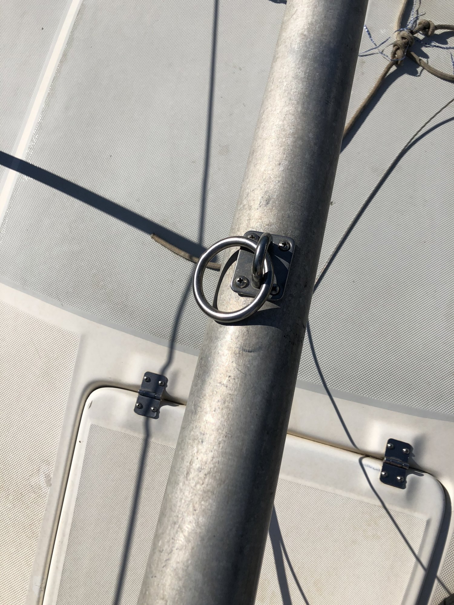

Also on the front of the mast there are two round rings and a black plastic part that is broke off. What are each of these?

Yep. Not OEM.
You sure you wouldn't want to just go sailing and prioritize projects from there?

Do you have access to the previous owner?
The fittings on the mast and deck could be jib or spin pole related. Just a WAG.

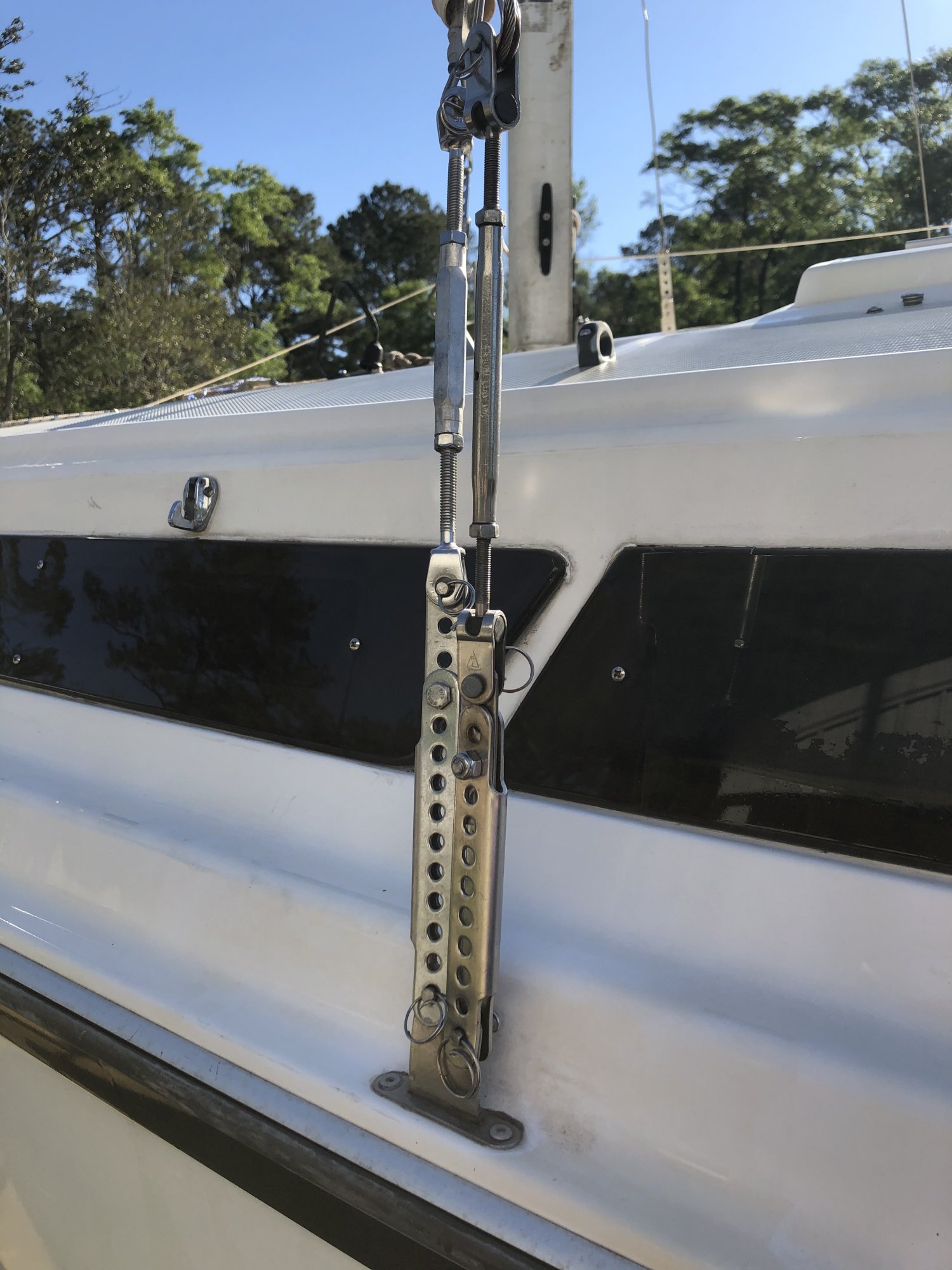

I worry about causing damage with water intrusion from any and all fittings. This boat has been stored dry for the last 4-5 years. If I were to use it as is and wait to start my restoration in the winter would I be causing to much damage? Or would it be best to wait?
The standing rigging is all smooth although the crimps have a green corrosion on them. I carefully slid my hand down all the stays and no meat hooks were found. Just silky smooth.
The spreaders don’t seem to fold properly and even on stay seems a little kinked right at the spreader.
Port stays use turnbuckles and starboard stays use turnbuckles and plates.
Rear looks like this.
I worry that if this is all wrong what else am I missing? And should it be best to just replace it all and start from scratch.

Sure looks like the PO had to compensate for short shrouds for some reason. I've never seen an arrangement like that on the backstay or the side shrouds. They come with a single pair of adjustable plates at every deck fitting.
That’s what is making me worry they are not up to the task.

I see what you mean now. Too many possible failure points. I wonder if Blue Water Yachts could fix you up. They specialize in Macs. I have bought several things from them in the past
Yeah.... definitly a little creative engineering. Back home we would say "Boudreaux got some money... every now and again".
The macs didn't use turn buckles but instead just the adjuster plates. And the standing rigging was not very taught. The mast would move a little and only the windward side would be taught. I think Justin's advice to contact Blue Water is the right thing to do.

There is some reason for the stay and shroud "lengtheners" If you can figure out why, I bet you can solve your rigging issues. Only the adjustment plates with the pins came from the factory.
