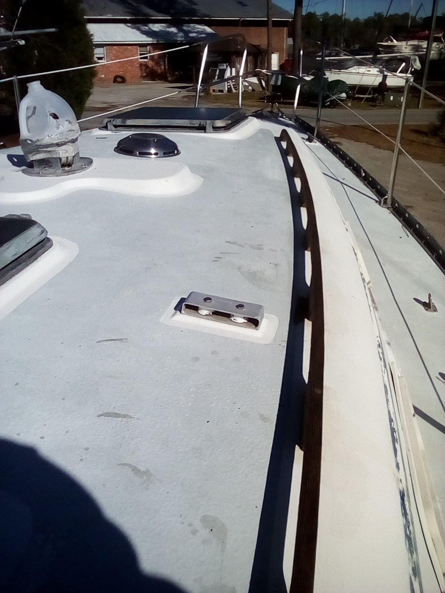

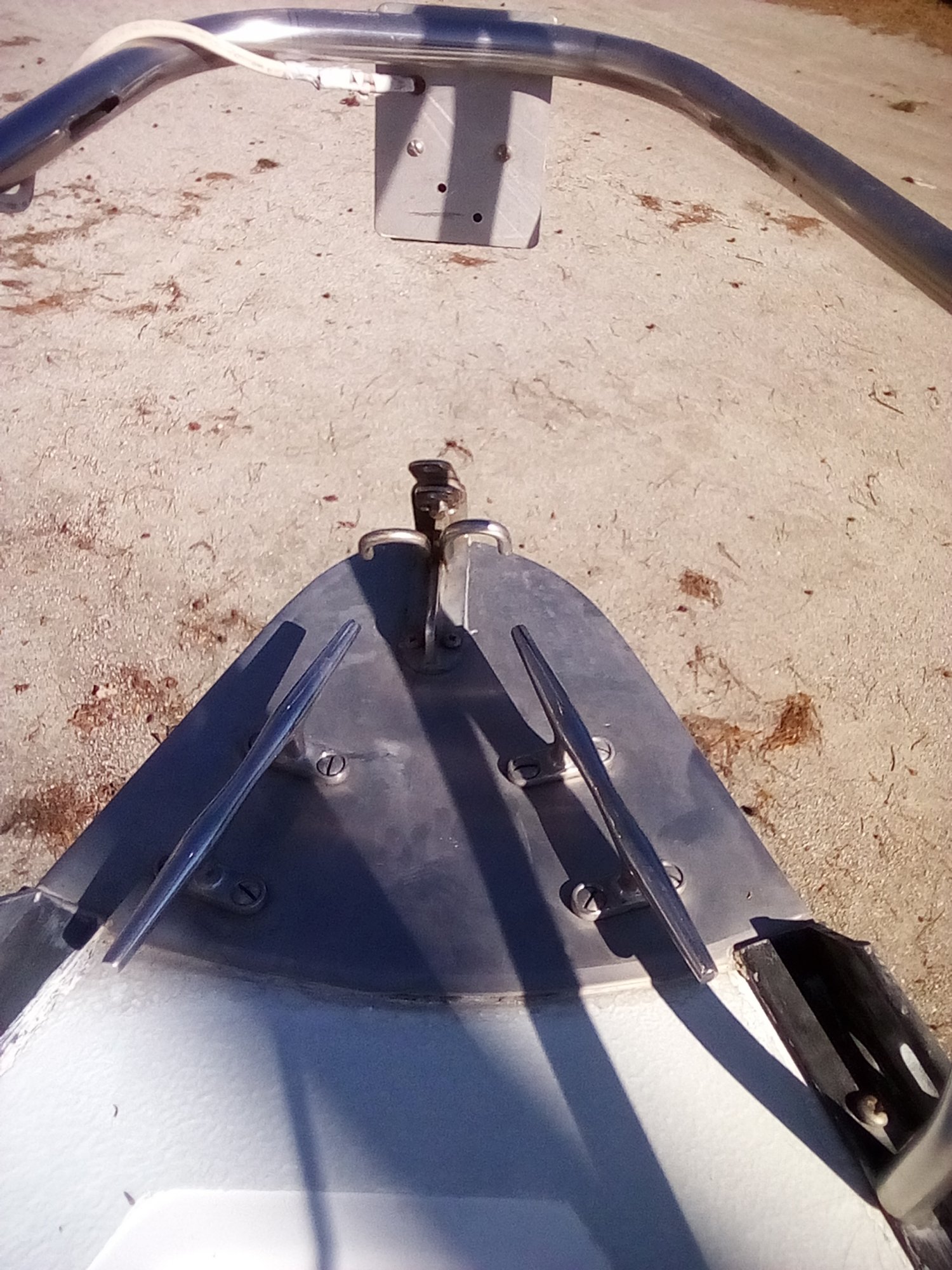

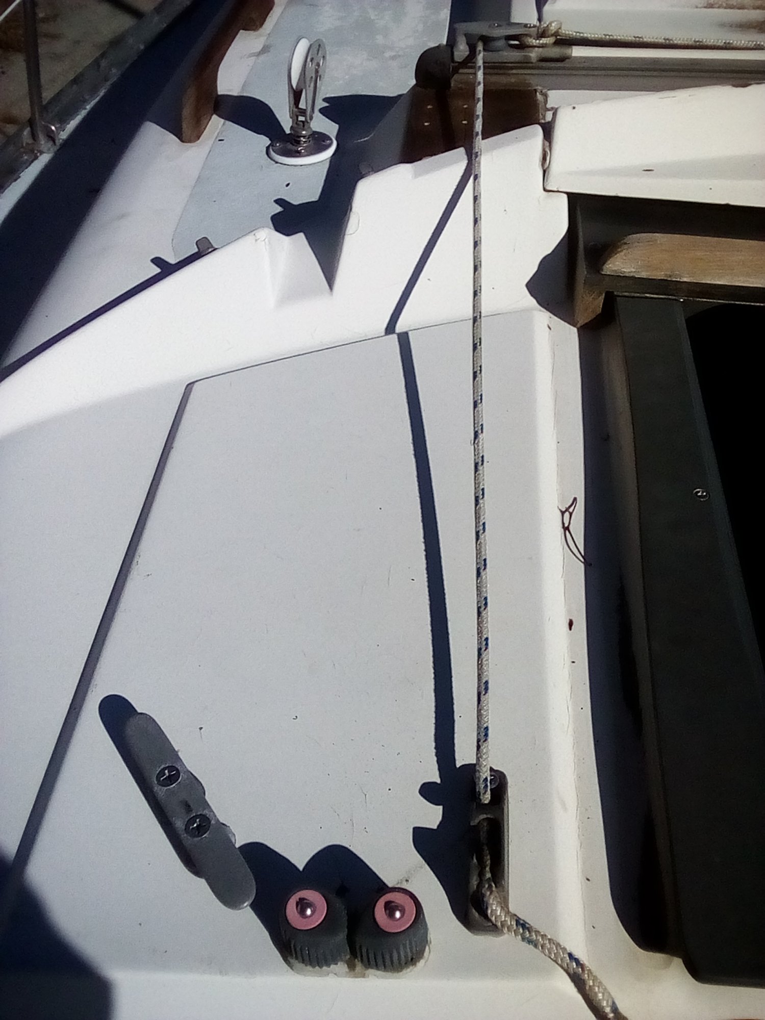

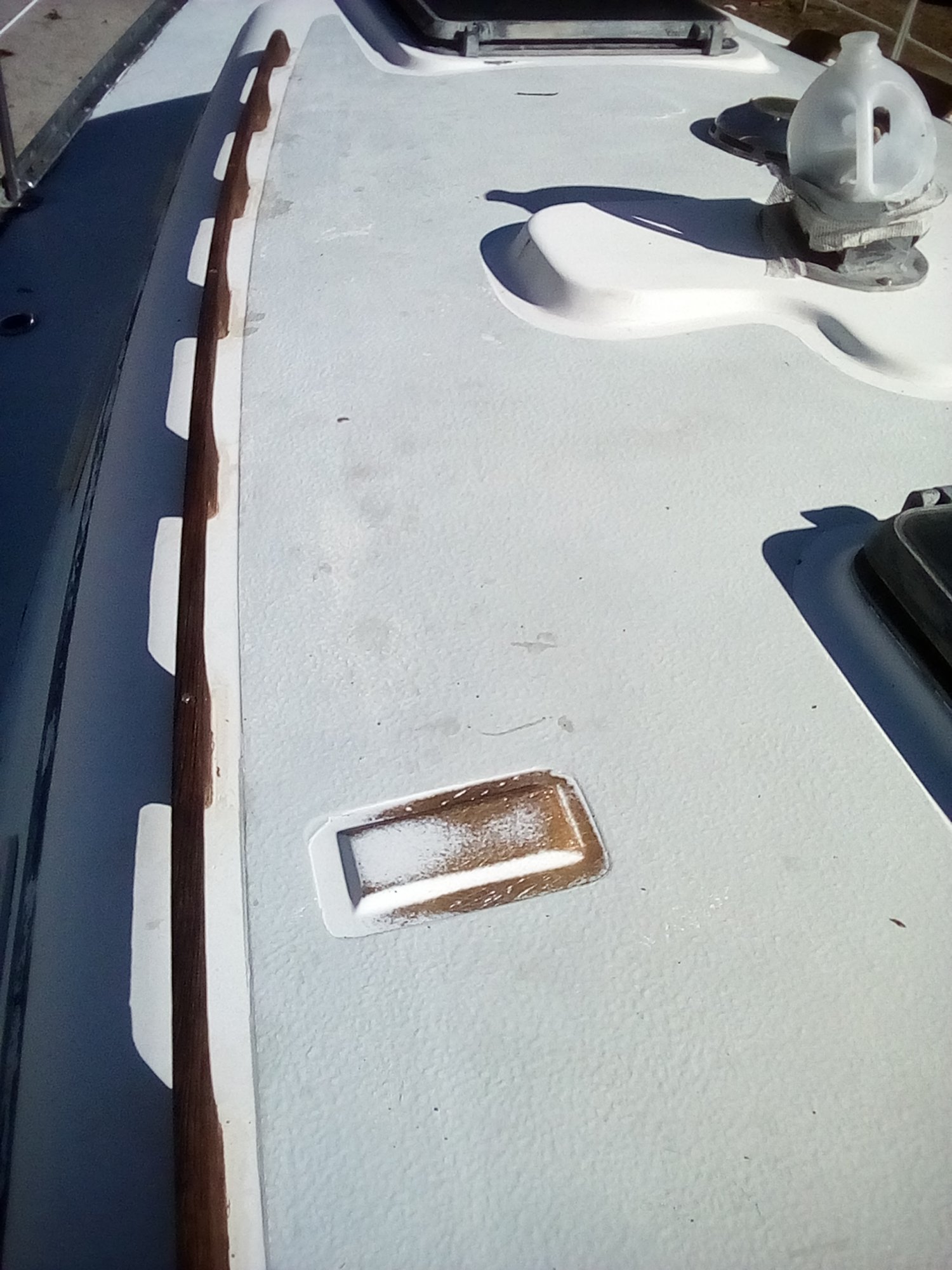

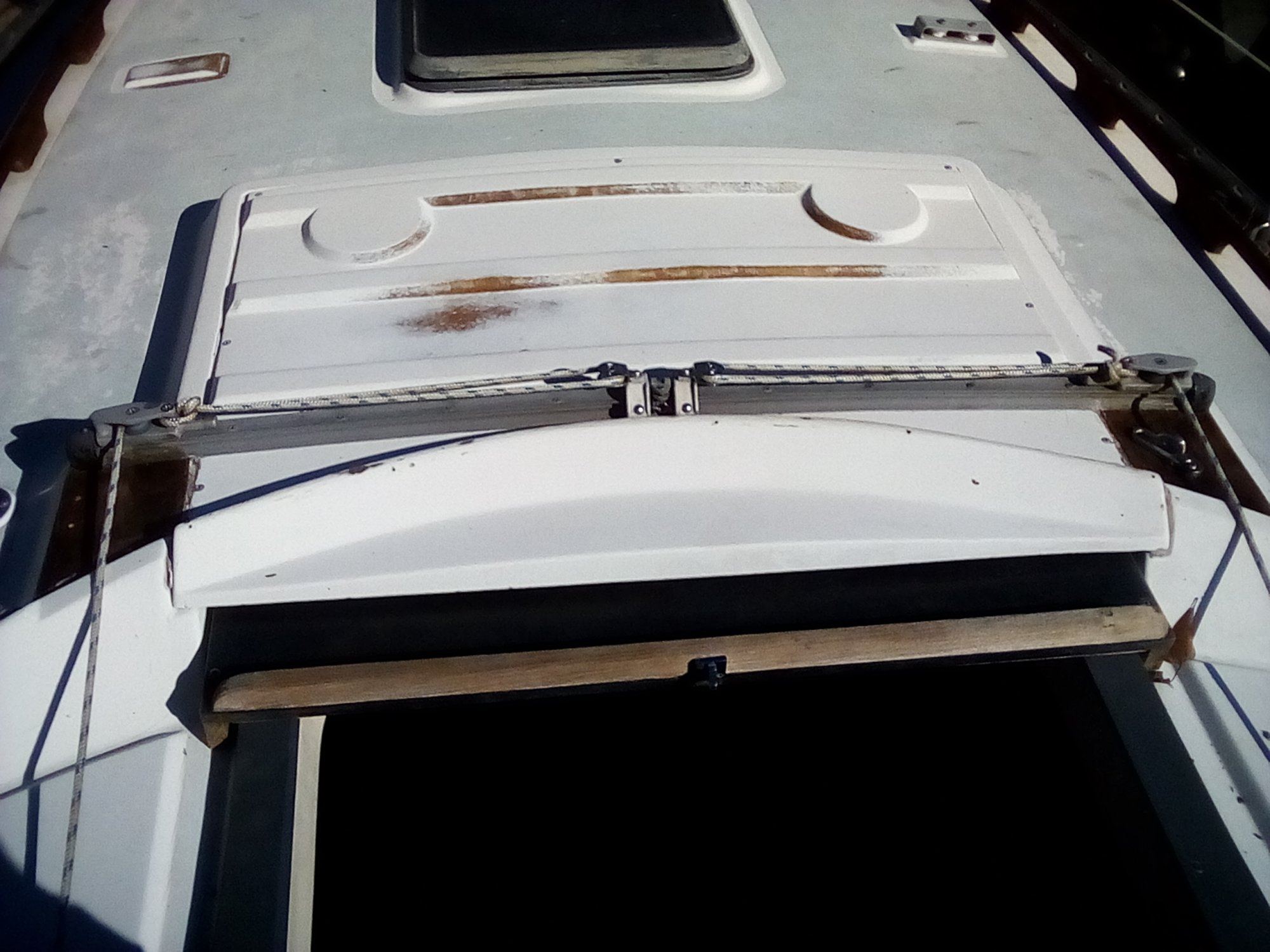

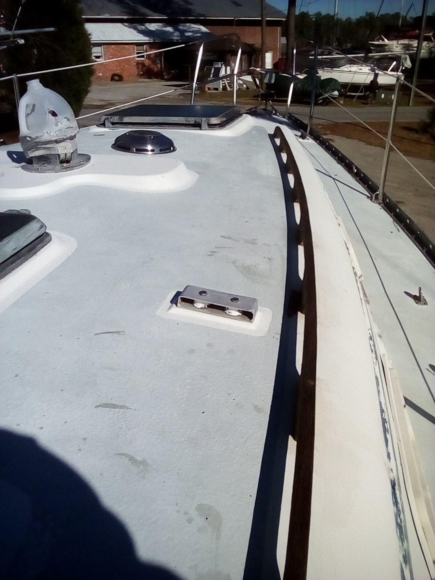

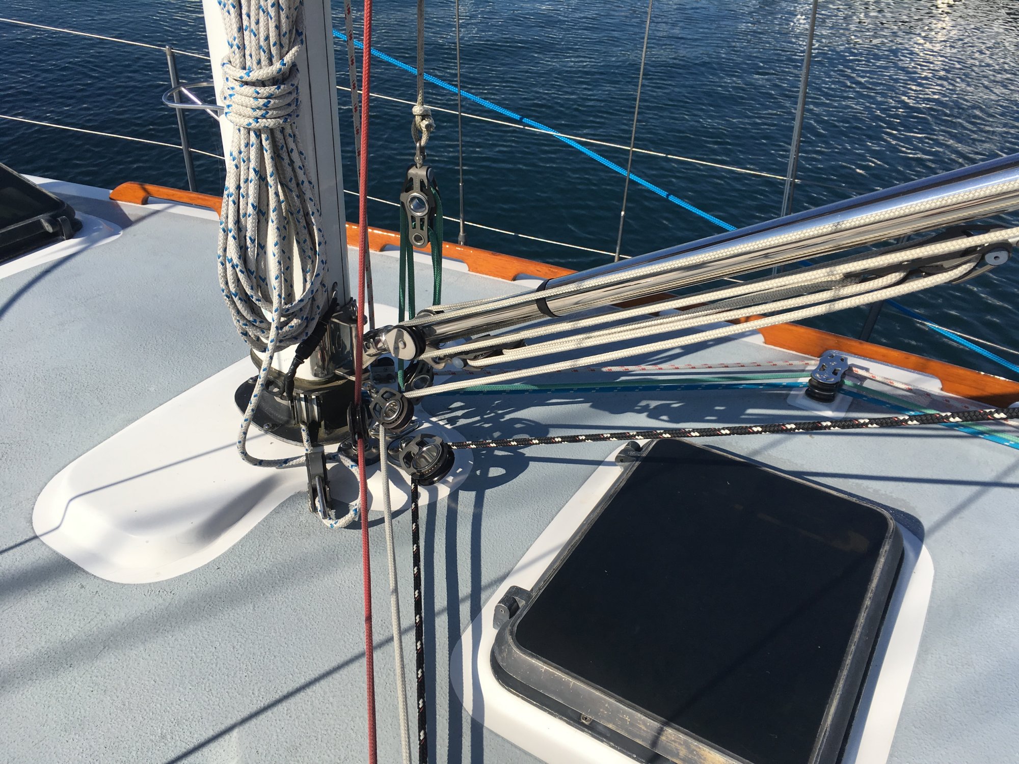

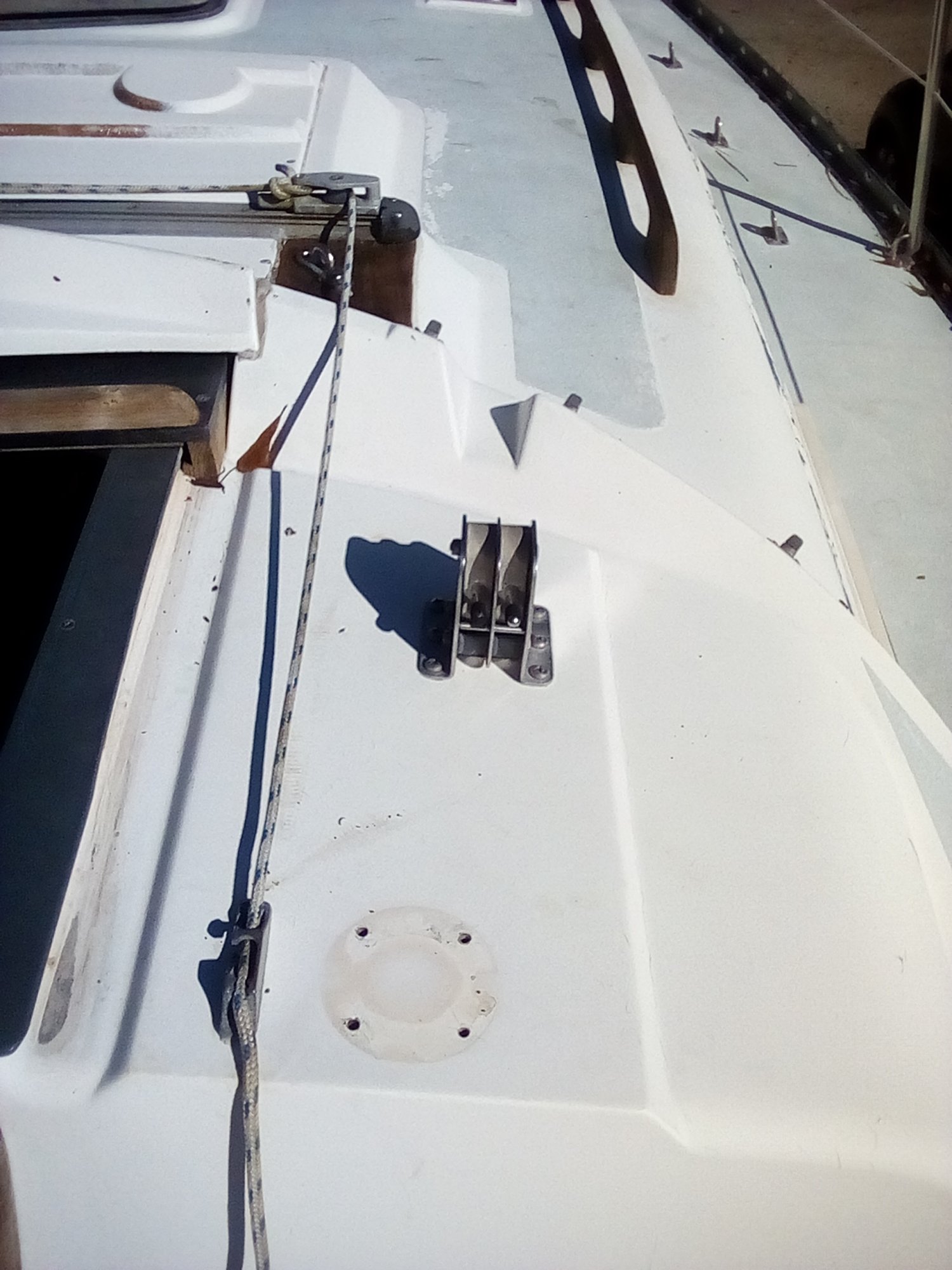

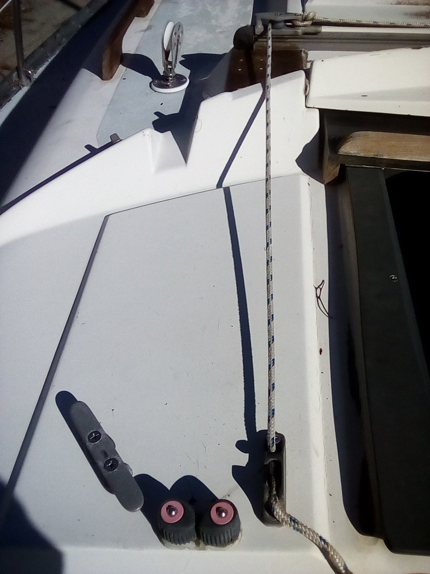

Took a few photos today. I am still unfamiliar with the traveler and main sheet rig and the routing of the lines. There are four sheaves in the base of the mast, two each side. There are two lines guided to starboard, into two clutches and a winch mounted there. (Took winch off to service it). There is no sheaved guide on the cabin roof to port. There is a raised platform there, but no sheaves. A single turning block about three quarters back to the companion way and then a cleat and a cam cleat there.

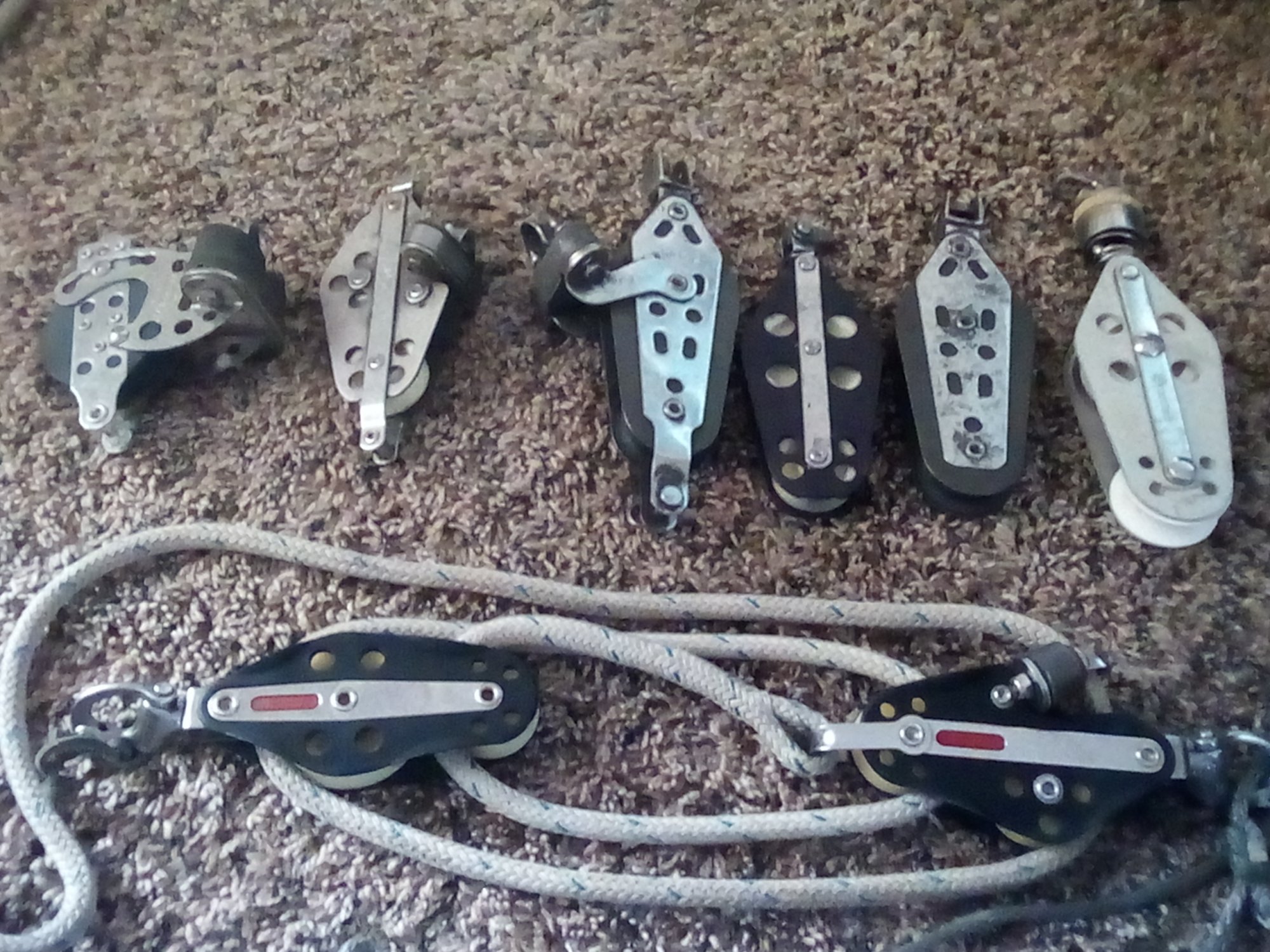

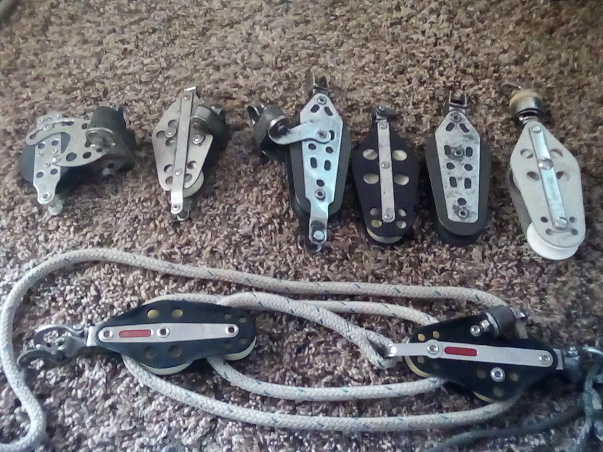

I have a number of blocks and then what I think is a set rigged for a boom vang, though I see no point to connect it to the base of the mast nor on the boom.
I have what appears to be an extra sheave in the top of the mast, with nothing in it. There is one pulley and sheave attached along side the jib furling shackle that I am pretty sure is for a genaker.
In the boom there appears to be one unused sheave and cleat.

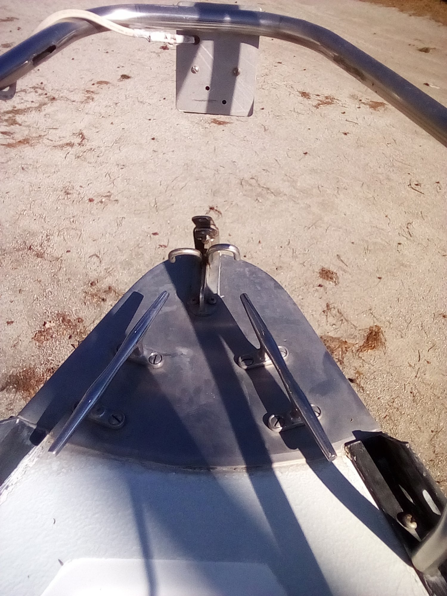

Also, on the bow, there appears to be a reefing hook.... never seen that before. Guessing the jib was set up to reef??
Going to be interesting to get this all rigged.

Glad to hear the 2x2 post in the bilge looks solid. The cross rib 2x2 tube is right on top of the post. You can see the ends of it, where the threaded s rods attach, on the port side in the locker below the lav sink and on starboard in the locker below the sitee.
FYI, on the cabintop, the raised white areas to each side of the companionway, at the two deck organizer locations and at base of the mast all have 1/4” aluminum plate laminated into the deck under the fiberglass. Hardware attachment at these spots is drill and tap, rather than through deck. Same at the ends of the traveler track under the teak trim.
The white plastic sleeves in the deck organizer are shot and need to be replaced. I would be wary of any plastic sleeves that age. The get brittle and fail under load.
As for how the boat was rigged, it’s a safe bet at this point that every one of these boats is a little different. Hunter sold them with minimal rigging and hardware, but with provision for easy additions, so they have evolved to fit owner preferences.

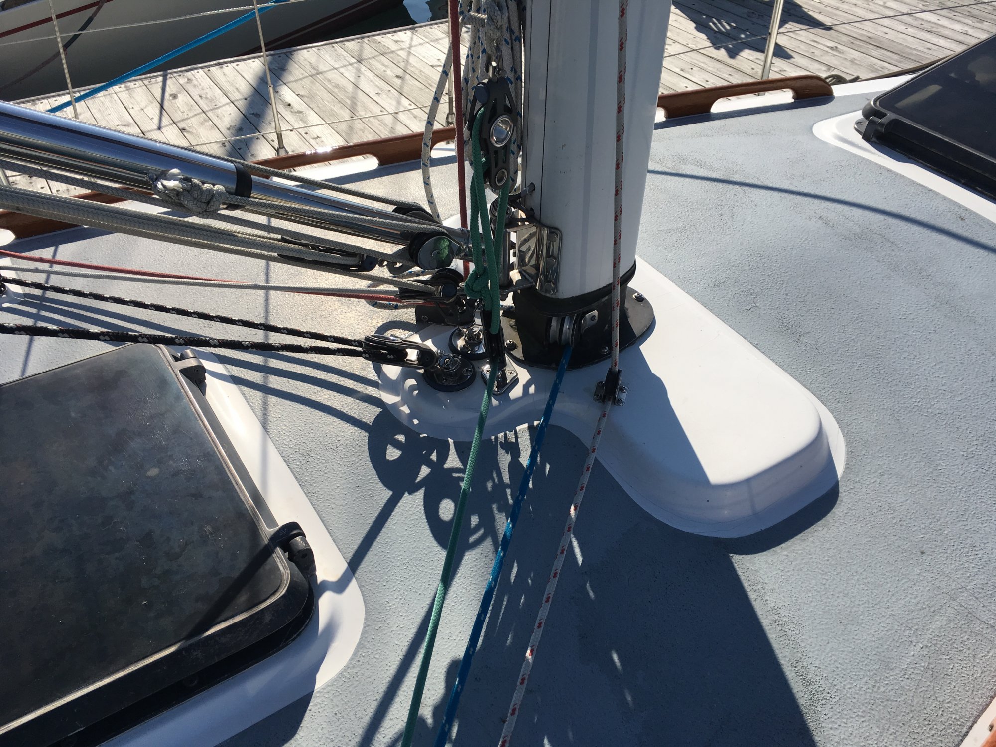

The mast base should have two sheeves on each side and the top of the mast has two at the front and two at the back. My guess is your halyards for the main and jib/genoa were run out the starboard side, through the deck organizer back to the cabintop rope clutches and winch.
Maybe the vang ran back to the turning block and cleat on the port side of the companionway. It should be attached to the underside of the boom and base of the mast, so the lack of attachment points suggest maybe it was never installed. Dalliance did not have a vang when I got the boat. It’s also possible that is a Cunningham rather than a vang, but you‘re still missing the attachment point at the deck. The vang is a more useful addition.

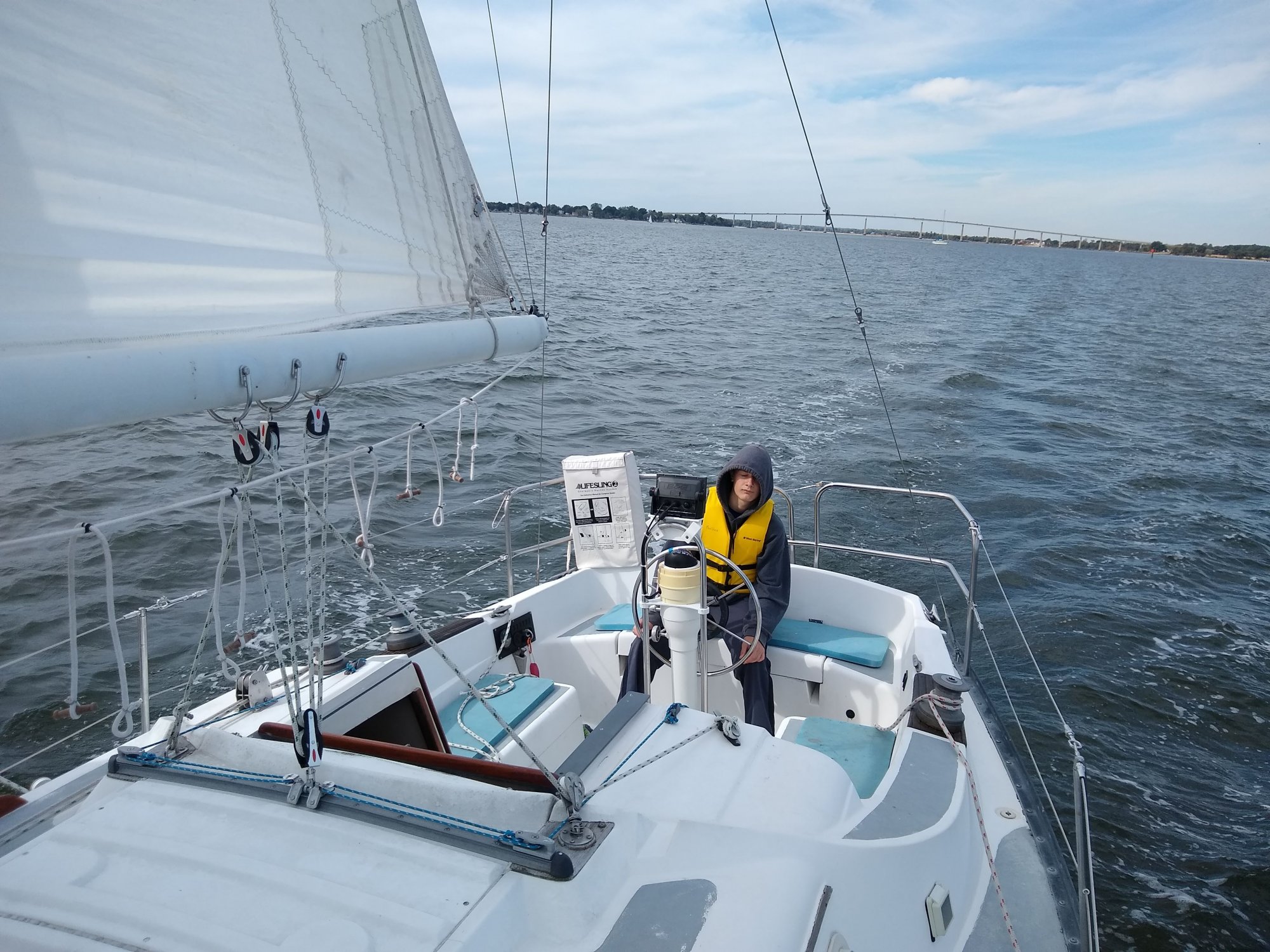

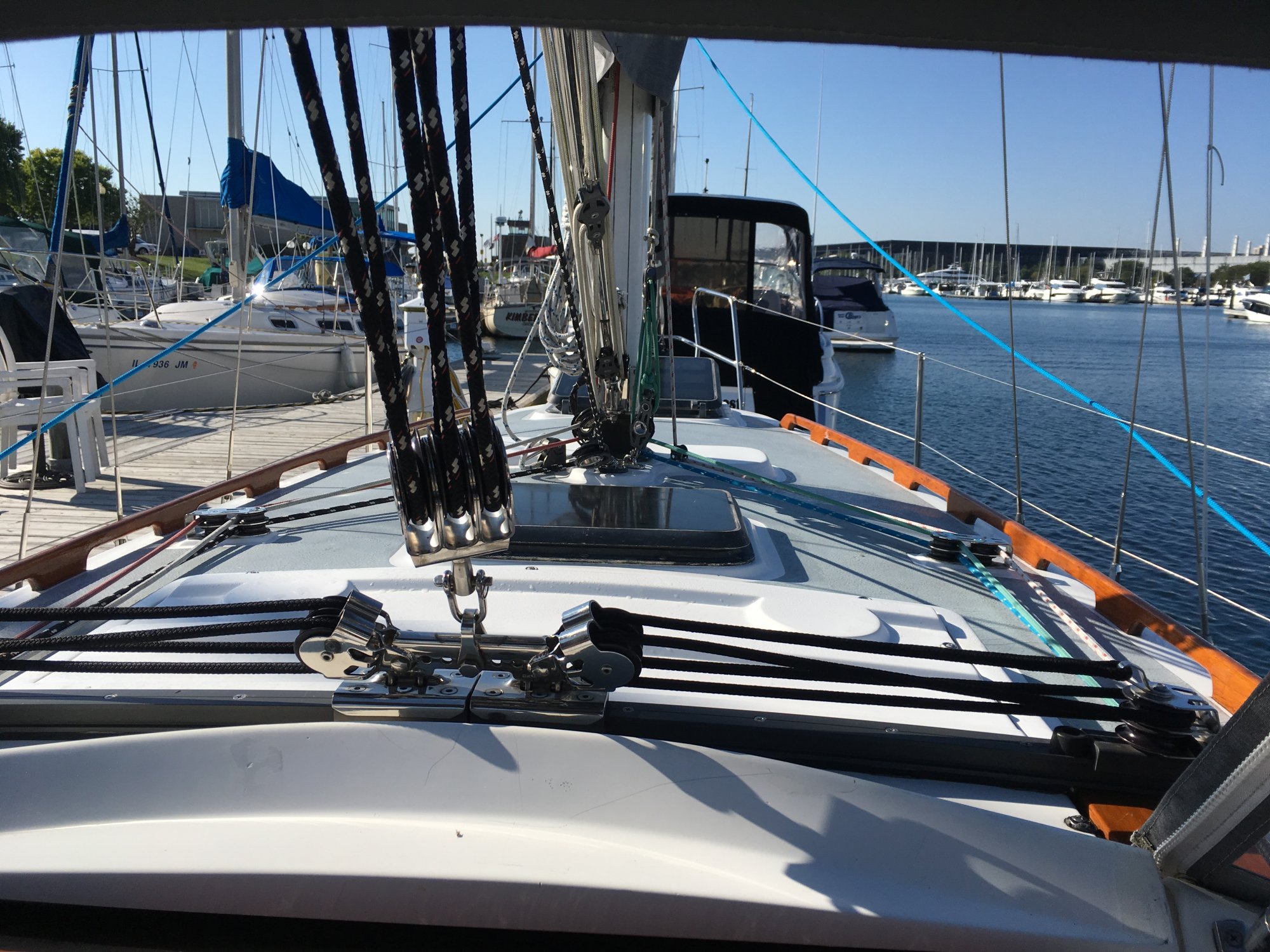

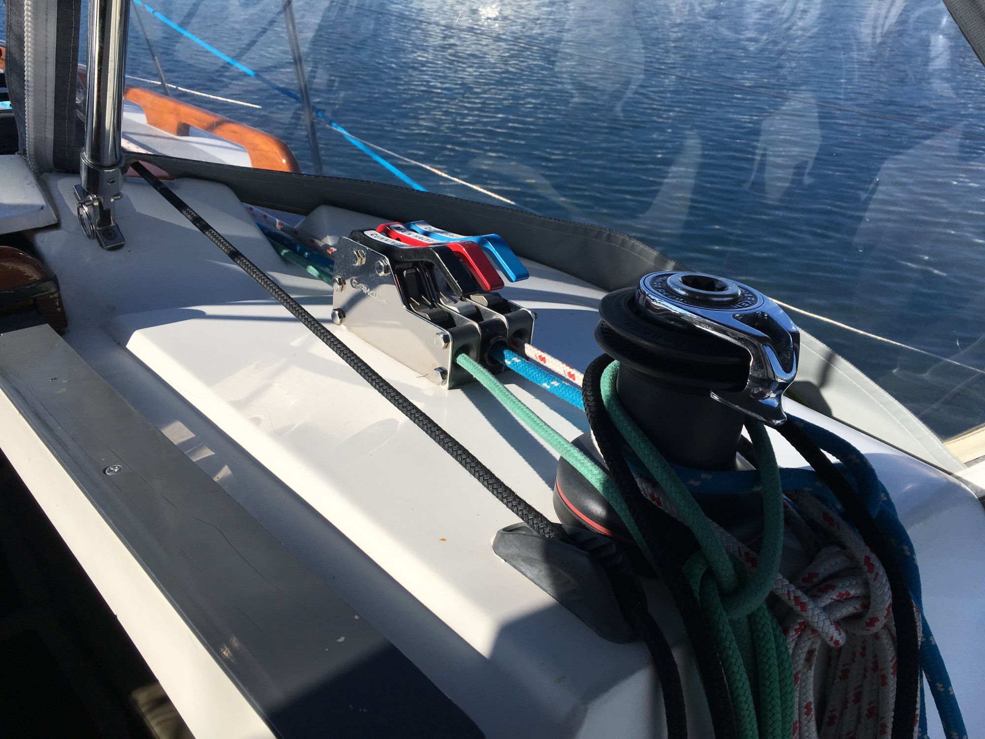

As for the traveler and main sheet set up, the traveler looks similar to what was on Dalliance, which I don’t think was original, and I have since upgraded. When I got the boat, the bitter end of the mainsheet was attached to the center boom bail, the sheet passed through the first block on the traveler, then up through the aft block on the boom, down through the second block on the traveler, up through the forward block on the boom, then forward to a turning block on the deck just aft of the mast base, back through the port side deck organizer to a cabintop rope clutch and winch on the port side of the companionway. I’ve since upgraded to three blocks on the boom and a triple block on the traveler for greater purchase
Since it appears that your mainsheet may not have run forward and then back to the cabintop, it makes sense to me that you would have a cam cleat on the blocks at the traveler. That only works if there is no dodger and windshield over the companionway. If you only have two blocks at the traveler, I don’t see how you get more than two blocks on the boom. Maybe your setup did not use all three boom bails(?). I’m not sure you have all the parts for your mainsheet.
I think you probably have an outhaul line in your boom which goes through blocks at each and to the cleat at the center of the boom. At least that’s what Dalliance had. Actually wire at the clew through the aft end block, with line and block inside the boom. I got rid of the cleat on the boom, ran the line through a turning block at the base of the mast and back to the cabintop through the port deck organizer.
Dalliance has two blocks at the aft end of the boom and two small clutches and the forward end for internal reef lines. Cheek blocks on the sides of the boom align the reef lines align them to the reef points on the mainsail.
Attached are a few photos. Dalliance went through a substantial refit about eight years ago. Boat Show discounts are a wonderful thing. All new Garhauer hardware, running rigging and Harkin ST winches. Everything except the two reef lines and genoa halyard is lead back to the cockpit cabintop. Hopefully some of this is of help.

Well... I have some hardware that I have no idea what it could be for.... see the picture of all the blocks above... I think maybe the previous owner just picked them up at a second hand marine store or something.
