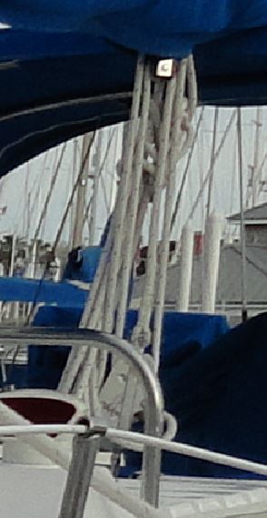

Here's a picture of my main sheet. I think it's the original set-up.
The Harken set up is what I would like :D
My 1983 is set up like the second drawing with the fourth boom Pulley. I need to replace two of my sheaves as they are falling apart. May just replace the pulleys.

Or you can change the traveller block set to a triple with becket and cam cleat to eliminate the friction of three blocks and add your advantage to 6:1.. Picture is of my setup

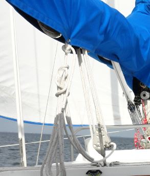

see pics of my 84 H31- 4 to 1 mainsheet. works great, even under load. hope this helps
So you have a double fiddle with cam swivel and becket on the traveler with a double fiddle on the boom at the central of the three outer boom attachment locations.
4 to 1 might be enough, but how hard is it to get the main sheet out of the cam to fall off under heavy wind loads?

I bit the bullet, and Changed my Main sheet set up to a triple with cam and becket to three single blocks on the boom.
It made a huge difference. main trim is much easier, and it freed up my deck block and clutch so I can add a spinnaker halyard.
