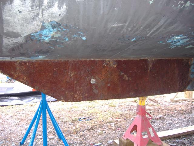

If you go to D&R Marine web site you will see parts listing for your boat and the swing keel. On my boat there two wear pieces on each side to guide the keel. maybe you have the same and you may need to remove them to get it free up! I save been with a hammer and long cheisel and chip away all the rust in that area from the cast iron keel and then took a small sand blaster to it.

Been working on my keel, find a large build up of scale in the back side of the swing area, using a hammer and long chisel i've remove alot of this along with rust. Like all the job it not done yet. i do see were the support was at one time so there is hope. Will keep you up dated

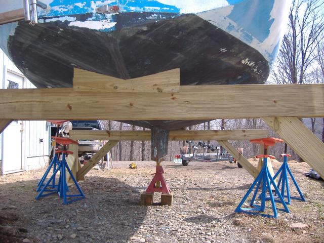

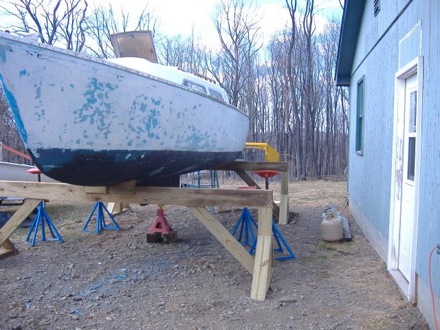

2 22 Kingston, NY
Good morning, spring is here i hope. Started to work on the boat and scraping paint, remove wiring and rusted parts. I have came back to the keel and what to do with it. It has alot of rust inside and would like to remove it before new centerboard go in. What do you think about unbolting the keel from the boat and working on to it that way? By doing this i will be able to reseal the joint. So has any one done this or have any through about this? :confused:
