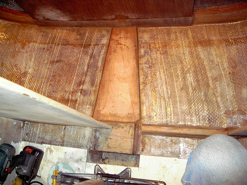

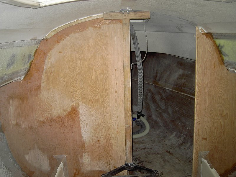

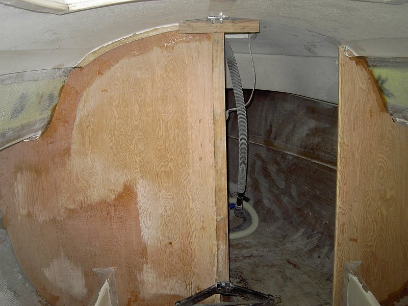

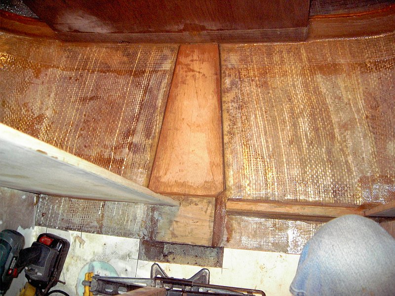

I ended up getting mine from onlinemetals.com
New bulkhead

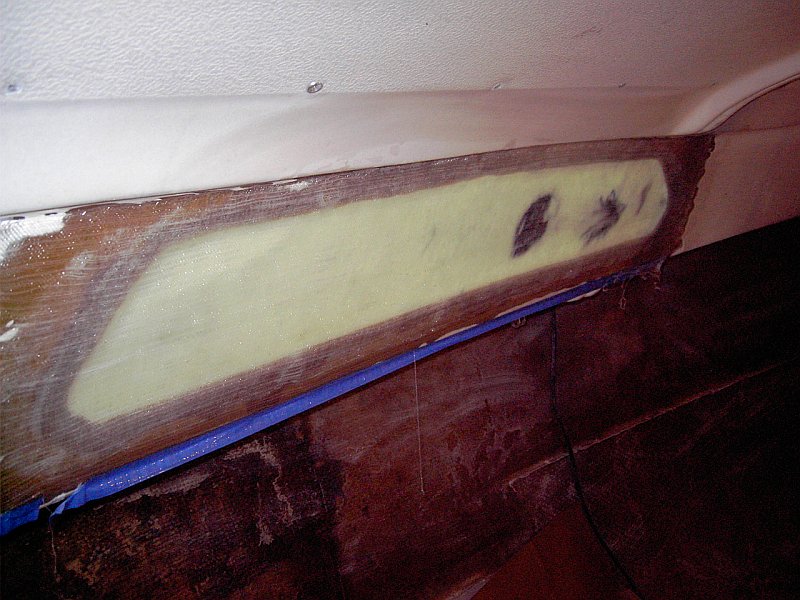

Window filled in
Little square is buildup from keel

Hi Louden,
Question about the v-berth replacement. I like the supports you built to go in the hull. You used these to hold up the plywood of the v-berth. Is that correct? Did you also tab the berth plywood pieces to the hull where they used to tabbed?
I’m hoping you will say the new supports were sufficient to hold the berth plywood.
Thanks,
Randy

After multiple tries at sealing the original windows I did decide I had to change course. I was thinking of trying to fit 4 portholes on each side but I didn't see a practical way to do it without making them look crowded.
Plenty of light provided by the hatch.
