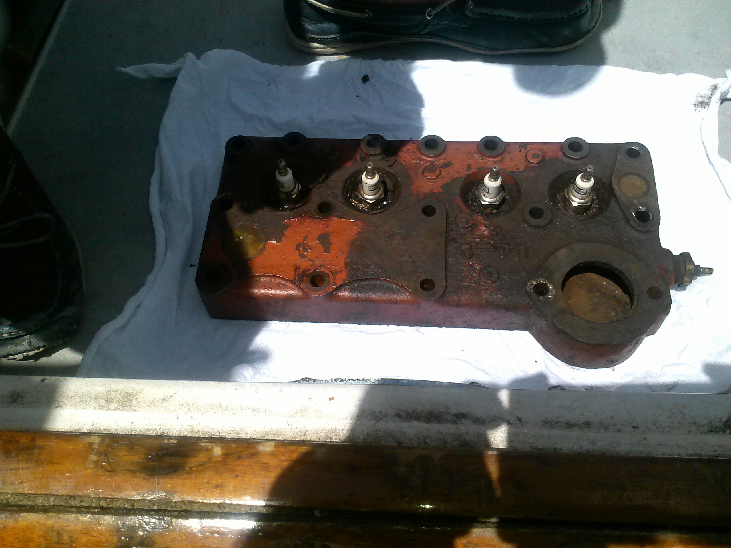

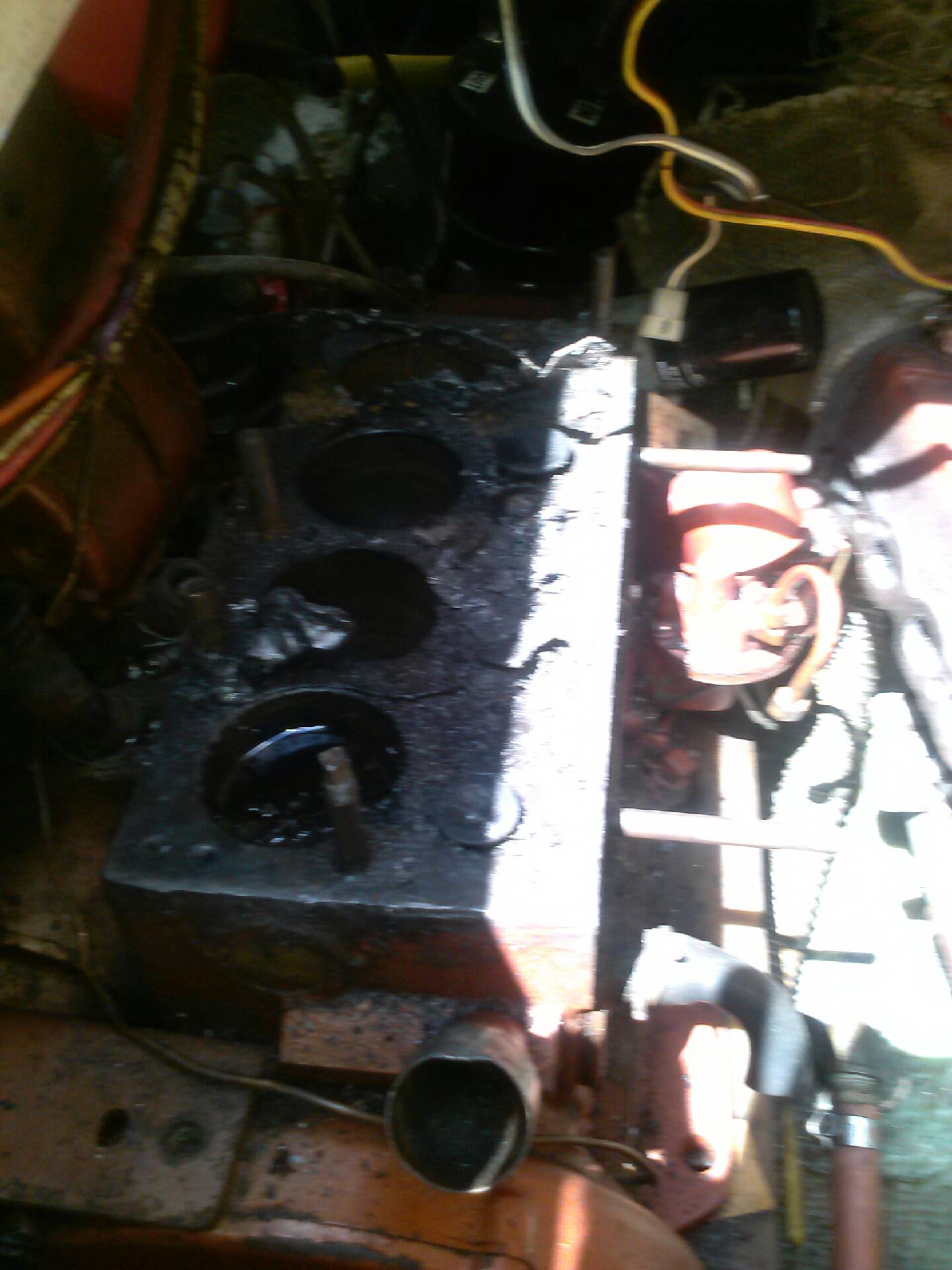

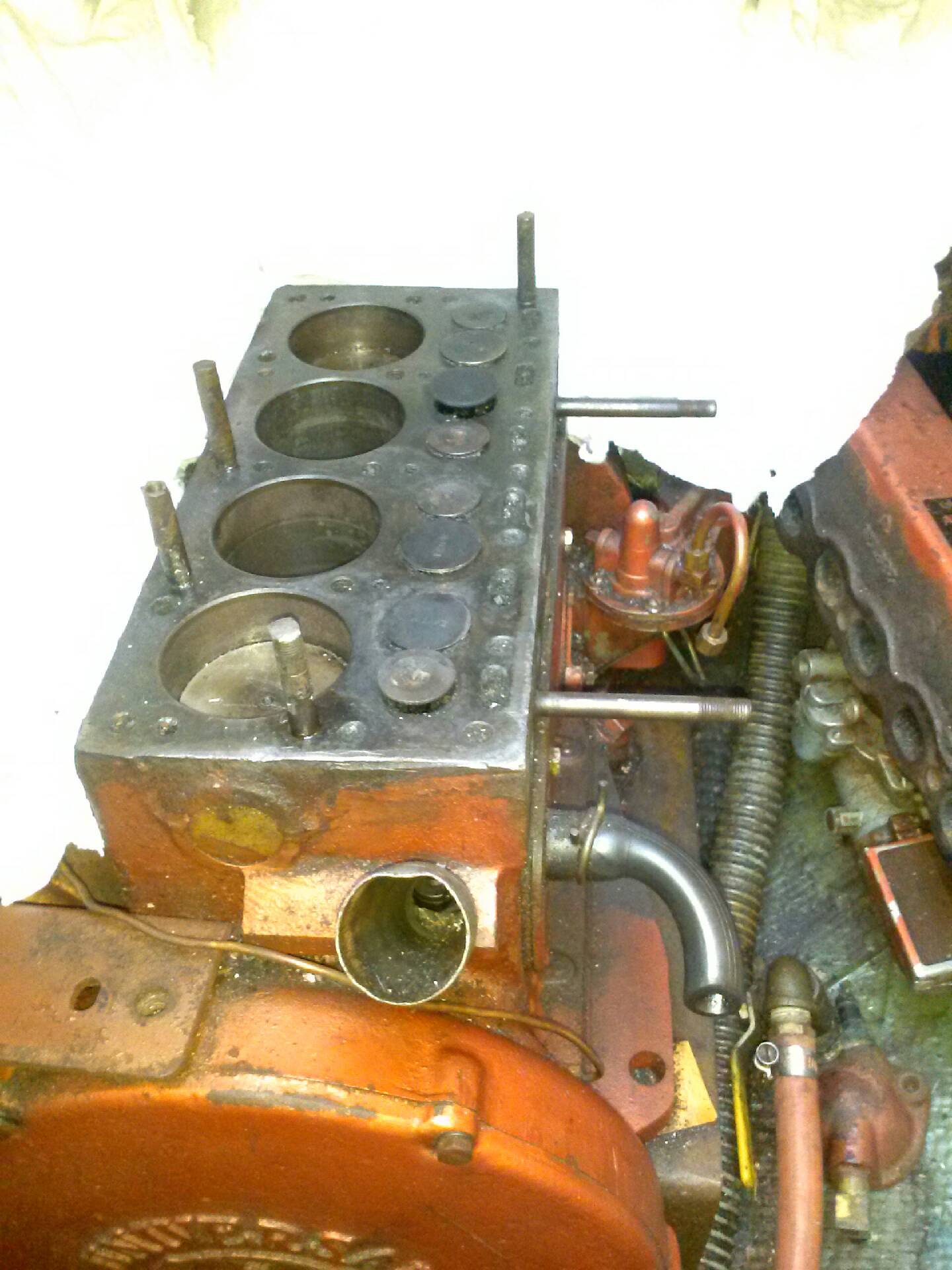

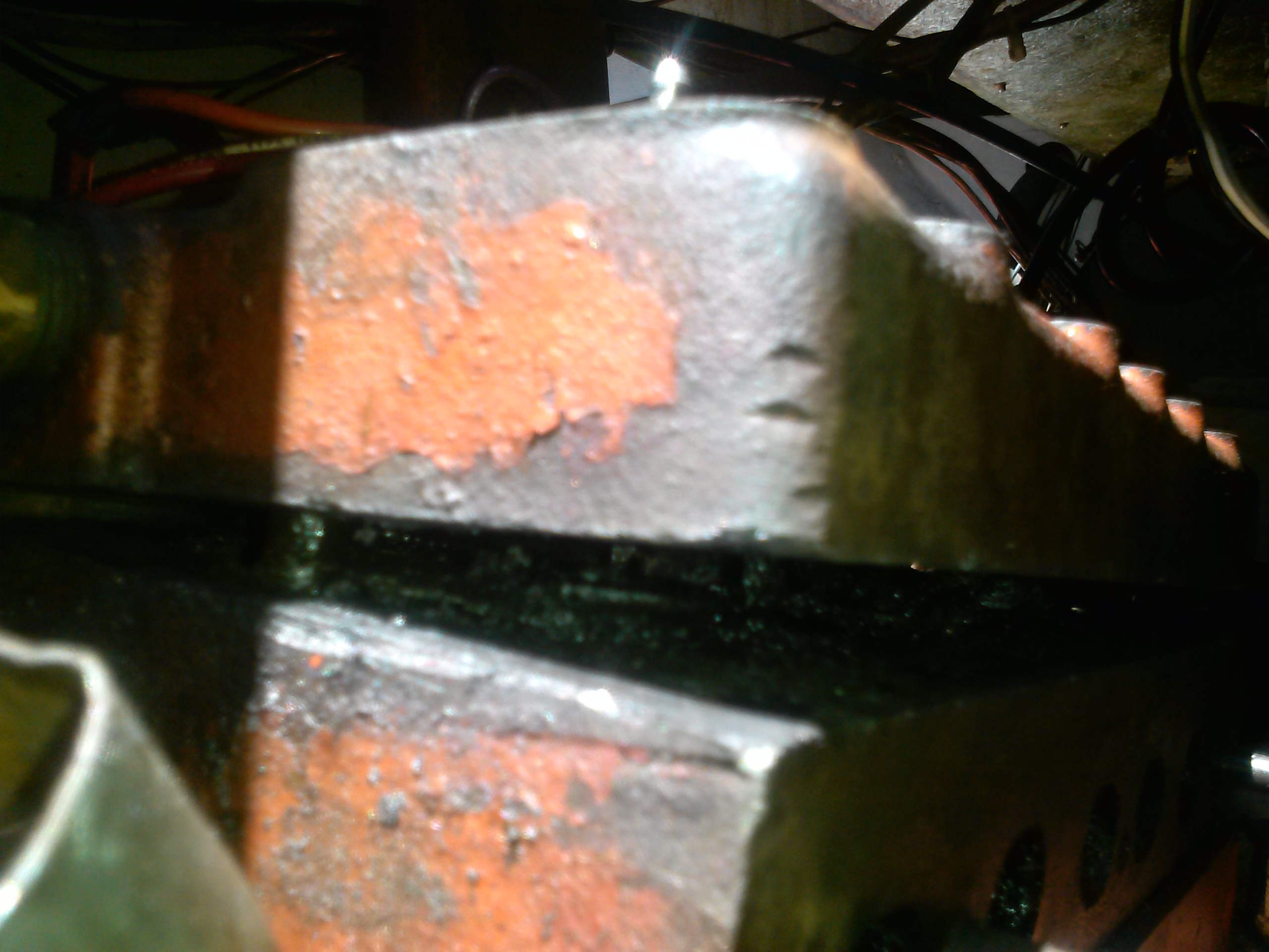

OK. Proof in the pictures. And today, I managed to take out two of the remaining four head studs, and prepped the other two for drilling. (Prep --- ha ha hah. That means I snapped them off at the block, but not too bad. I will drill them out, next week.)
Regarding the rebuild, I spoke to Don at Moyer Marine (www.MoyerMarine.com). The plan going forward is to remove the last two studs, order a new set and put them in, put in the head gasket, and them do a compression test. Someplace in that list, I need to turn the motor over several times and clean the valves, for sure. In at least two of the valves, head gasket like material was caught between the valve and the seat, along with LOTS of carbon. The engine block, between cylinders two and three, had a shadow, and artifact of communications between the pistons.
Regarding the rebuild, I spoke to Don at Moyer Marine (www.MoyerMarine.com). The plan going forward is to remove the last two studs, order a new set and put them in, put in the head gasket, and them do a compression test. Someplace in that list, I need to turn the motor over several times and clean the valves, for sure. In at least two of the valves, head gasket like material was caught between the valve and the seat, along with LOTS of carbon. The engine block, between cylinders two and three, had a shadow, and artifact of communications between the pView attachment 122553 View attachment 122553 View attachment 122553 iston areas.

Just wondering were you able to turn it over before you removed the head? If you did turn it over, did you do a compression test?
No. Four of eight head bolts were already out and the remaining four were twisted off at the top of the head. So, to go forward, I had to get the head off, remove the last four studs (now I have only two to drill out), clean the cylinders well, put the head on, and then compression test.
