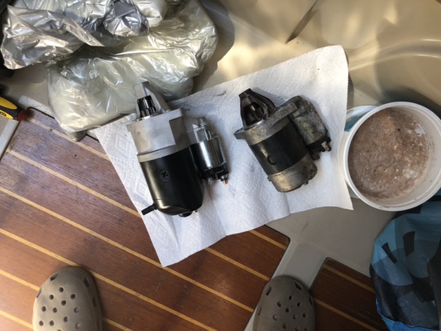

Thanks. I’ll look into that one next. See attachment, the one I bought from ebay (NEW STARTER UNIVERSAL INBOARD 5411 5421 M-12 M-15 M2-12 M-25 M-25XP M-25XPA ( 143471395688 ))
was too big (9” long vs 7.25” long) and would not fit.

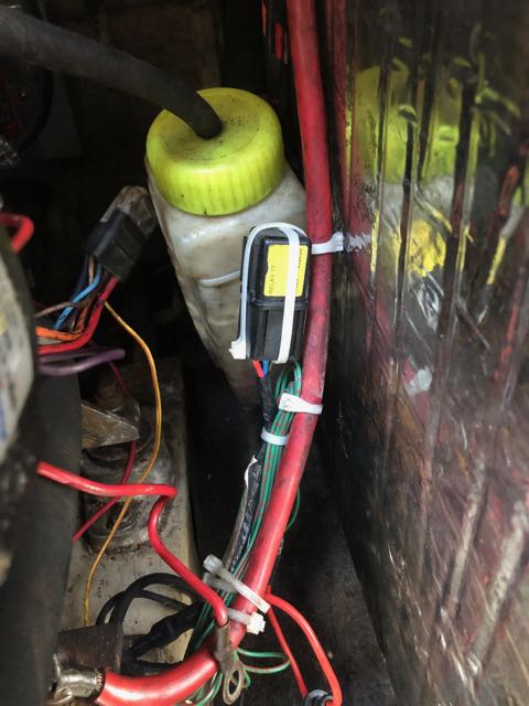

Thanks. I will try and make sense of this. Sounds relevant. My wires go into a relay and it's hard to track wires to follow from there. Currently I'm trying to finish hooking up a new starter - see my latest post on that which I hope you can help with.

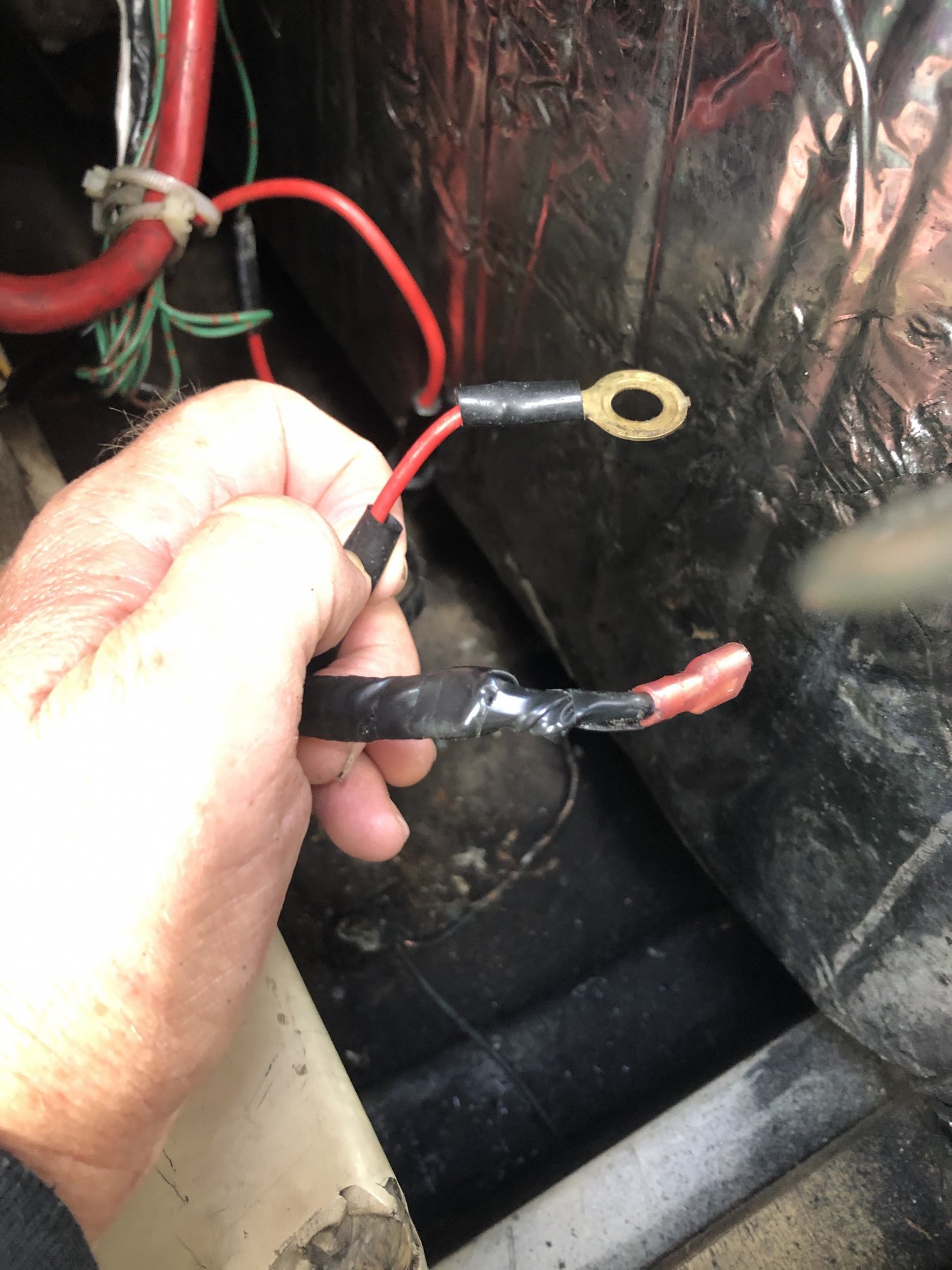

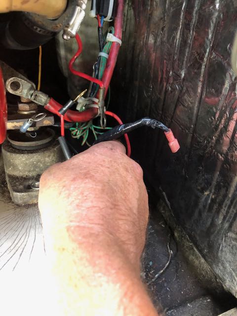

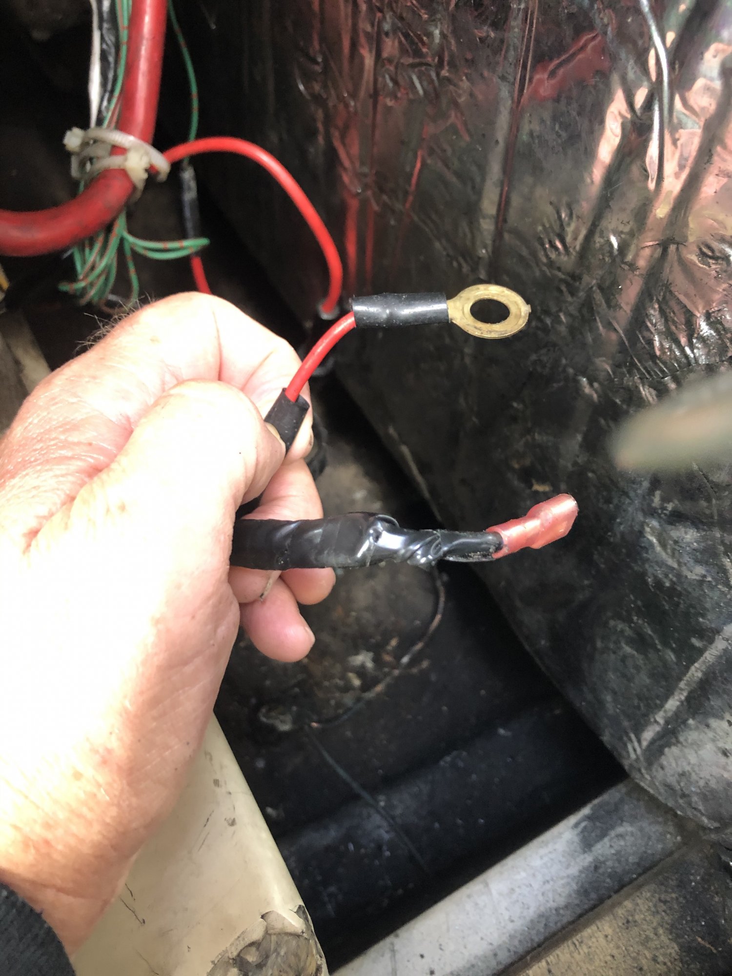

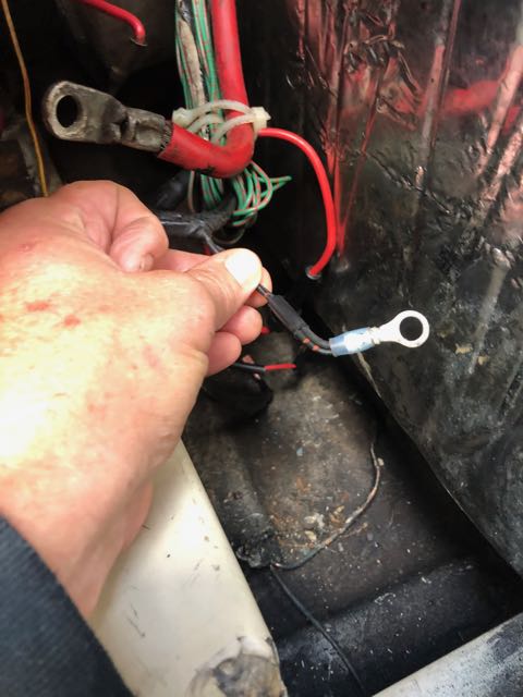

Finally got a Mitshibusi starter that fits. I bolted it in place and now need to attach the wires but it seems I have an extra wire to account that I did not take note of when removing the old starter a month ago. Time has passed getting the correct starter that makes remembering the right way to hook it hard. I fear hooking it up wrong and burning it out. Need help please. I'm attaching photos. I have the wiring diagram shared earlier in this posting stream but that is hard to follow as my wires go into a bundle with relay and its hard to track from there.
Here are the notes I took when I remove the starter:
Black wire Underneath the oil filter goes to the bottom bolt mount for the starter the other two wires off to the right red ones go to the top right post on the solenoid
Of course I bolted the starter down before seeing this note implying I need to remove the lower bolt, insert the black wire and bolt it again - very tight spots to work in. I have 3 red wires to account for yet my notes only talked about 2 red wires. Here are the pictures. I'm thinking maybe all 3 go on the right post of the solenoid?
As for whether a wire jumps from starter to Alternator, I'm not sure if it does or does not. I assume it would be one of the red wires from the right terminal on the solenoid to where on the alternator?

Congrats on getting a starter that fits. When I changed mine I had three wires on the + stud of the starter solenoid. Heavy gauge red wire working its way to the battery via the 1,2,off, both switch. Thinner gauge red wire which I believe went to the voltmeter. Orange wire which went between the starter and the alternator Out. The final wire was red/yellow with a spade connector which goes on the S terminal of the starter solenoid and goes to the Start button. This should be fused. This wire has been suggested in several write-ups to be replaced with a heavier #10 gauge so it may no longer be red/yellow. Hope this helps.

I got a mechanic to help and sure enough as you all suspected the culprit was a bad ignition wire close to the ignition switch in the cockpit. He thinks the starter replacement helps as you can hear much more vigor when the start cranks. At least I installed the starter correctly. Mechanic says the old was drawing more current to run than it should have Of course now I a new problem - engine mysteriously dies (3 times in A 30 minute trip). I’ll start a new thread for this topic. We are thinking water in the fuel. Mechanic says everything checks out well otherwise. Not sure how to deal with this. I did have the tank scrub a couple times with in the last 5 years. Last time was 18 months ago when I had a 2nd (or 3rd?) high end fuel filter installed that is supposed to catch the water. Have not filled the fuel tank since May 2019 but only have about 8 hours on her since then. Cannot recall if I put the fuel additive in it before leaving her sit (after 3 hours of use) for 9 months.
