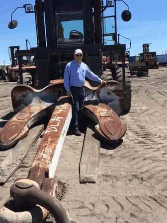

All this uncertainty about scope makes me think I need to upgrade my ground tackle
At 26,000 pounds:yikes:.... should hold my H26 on a 1:1 scope.
This guy is selling three of these on the Mobile Craigslist. Anyone need a mooring anchor?
If you don't let your rode out quick enough, it will hold with a 0:1 scope after delivery barge drops it into the water for you. :biggrin:

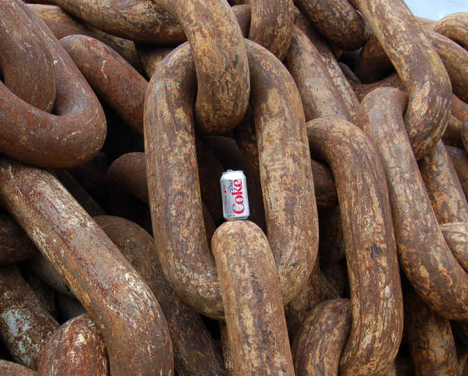

Who needs an anchor?
I so want to believe this pic is not a PShop image, but according to my rough calc each of those links weighs in at 5-600 lbs. Google tells me an aircraft carrier anchor chain has links that weigh 136 lb. Nonetheless, I always say that an anchor is only too big if it materially affects the trim of the boat (sailboat). That goes for rode too. :)
