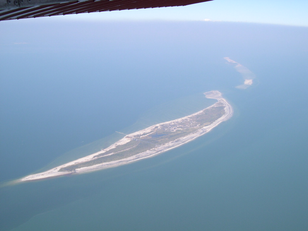

JamesG161
Feb 14, 2014
8,033
Hunter 430 Waveland, MS
That is the Channel current for the Shipping channel.
Look closely at this old picture. The Gap shown is now filled in by the Army Corps.
You can see the shallow area below surface just before the trench, which is darker blue.
Next you see the further offshore sand appearing again. That dark area between is the TRENCH.
I can swim in a 2.5 knot current.:cool:
Jim...
