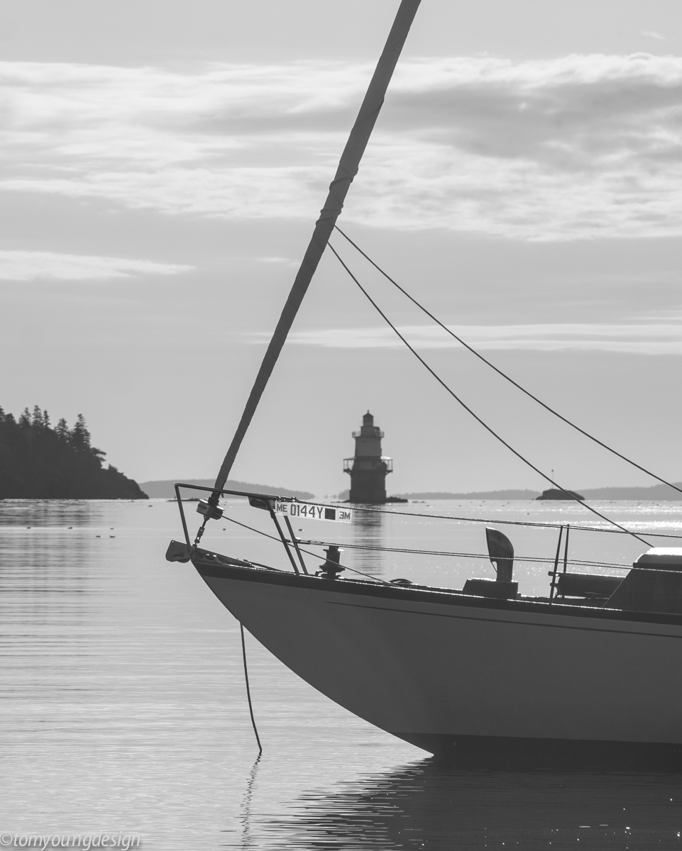

Scope - 'Limp rode'; that's my goal for an overnight anchorage.
TomY
Alden Forum Moderator
Jun 22, 2004
2,769
Is that Vinylhaven Tom? Don't recognize the lighthouse. :(
Very close, Rick!
That's the light - referred to locally as the 'spark plug' - at the Eastern end of the Fox Island Thoroughfare. Deer Isle in the background looking over Western Penobscot Bay.

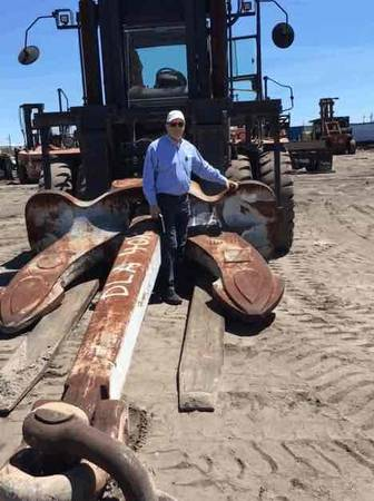

All this uncertainty about scope makes me think I need to upgrade my ground tackle
At 26,000 pounds:yikes:.... should hold my H26 on a 1:1 scope.
This guy is selling three of these on the Mobile Craigslist. Anyone need a mooring anchor?
