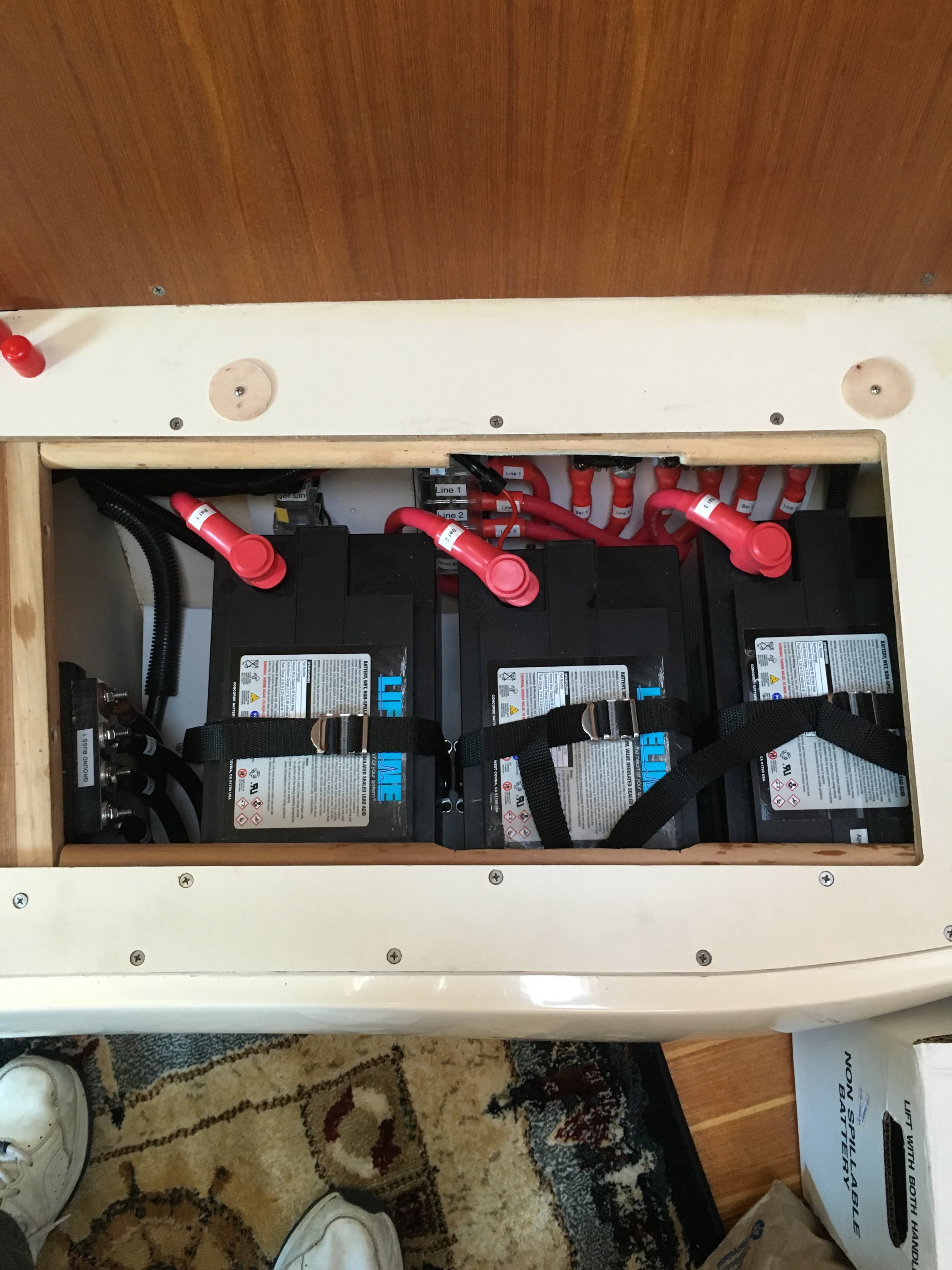

As seen in the photo of bank 1 each battery has it’s own breaker and is wired to a + and - buss.
Issue #1 = Breakers
AGM batteries have enormous short circuit potential, upwards of 5000A + per battery, and breakers generally do not meet the recommended AIC (amperage interrupt current rating). You also do not need nor want one breaker per battery as they are redundant, increase the failure points in the system, and also lead to more voltage drop. In a dead short breakers can literally weld shut if they don't meet the AIC rating. Class T, ANL or MRBF fuses are the proper devices for main battery over-current protection.
There are two banks with there own buss (Bank 1 - three batteries, Bank 2 - two batteries) The buses are connected to an A/B/Both/Off switch so that they can be bridged together to make one complete 625ah bank.
Issue #2 - No need for this switch or two banks.
The most efficient way to wire a bank like this is contiguously as one large bank. This avoids voltage drop issues, keeps the batteries better balanced and leads to considerably longer life when the batteries are charged and discharged as a larger bank. There are a myriad of reasons you do not want two house banks. You already have a redundant / emergency bank there is no need for three nor all the extra connections, switches etc...
This is done for redundancy
You already have redundancy in the AUX / START battery. Splitting the house bank is an unwise choice especially with very expensive AGM batteries.
as well as the ability to be able to isolate each part of the system.
The only way to truly "isolate" a bad battery would be to have an ON/OFF for each battery. If you short a battery on Bank 2 the 10V or 8V battery is still in parallel with the other 12V battery and can still thermally run away. If you short a battery on Bank 1 the 10V or 8V battery is still in parallel with the other two 12V batteries and can still run away.
In a scenario such as this you still need to manually identify the bad battery with a temp gun or isolated voltage readings anyway. By the time you've figured it out a few turns with a 14mm wrench and the bad battery is out of the circuit and you can continue on. In the real scheme of things the dual banks serve no redundancy purpose. The start battery can be switched in to maintain house loads while you identify the issue and take that battery off line. If you never allow your bank to drop below 12.2V then this is such a rarity that it is barely worth worrying about. Best course of action is to leave two "stubby wrenches" sized for the battery terminals mounted close to the batteries. if you never allow your bank to drop below 12.2V then there is minimal possibility you'd ever need that redundancy and your house bank will have a nice loong life and your start/aux/reserve bank will get really bored.
The 90 amp charger has three leads (only two are being used). The charger is used to charge the House banks only and each feed, to each of the banks is also independently fused.
The charger only needs to feed one bank, the house bank, and the ACR can charge the AUX bank. All those extra wires and fuses are simply unnecessary.
There is also a lead acid starting battery for the engine and genset wired to its own on/off switch.
For a boat like your a simple three ON/OFF switch configuration would be ideal and you would not be carrying around "isolated dead lead" that could never be called on in an emergency.. Share the Start/AUX battery between the engine and the genset, for starting both, as well as allowing it to serve house purposes through an emergency paralleling switch. The engine and genset draw so little power for starting that a simple G-31 battery is a perfect match for both and if a deep-cycle is used it can also serve as emergency house loads..

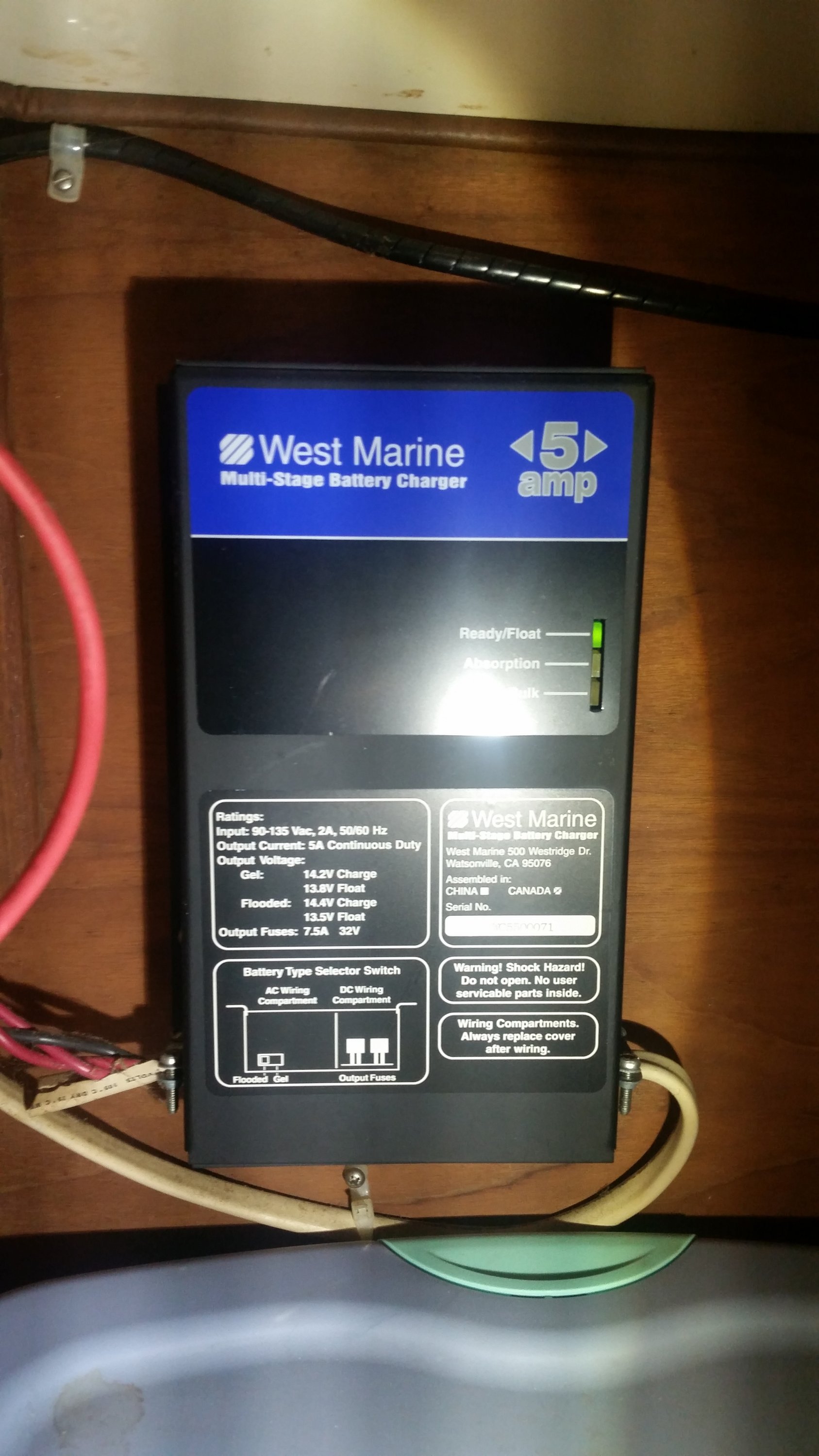

I have the charger below. it is currently wired to two 12v Group 24 pseudo deep cycle batteries connected a 1-2-All switch. I am considering switching to two 6v golf cart for main bank, and relocating and using one of the Group 24s as a separate start battery. If I added an ACR, do you think this charger would be sufficient for my new banks?
that's not much for that size bank...... you should be at 20% charge capacity ei 100 amp bat + 20 amp charger ect ect

(Some explanation) As for the independent breakers on each battery. All of the batteries are connected to busses on both the positive and negative posts and are not directly connected to each other from post to post. Since each of the positive posts run to an individual circuit breaker prior to going to the buss I am able to remove any individual battery from the system with the flip of the breaker. No need to unhook anything as long as the breaker has not failed (welded shut). This was done not only to protect the wiring but also so that any one battery can be removed literally in seconds. I could always add an additional fuse to break the circuit in case of a dead short.
Since there are two houses busses (one for each bank) all I need to do is connect buss 1 to buss 2 and move the original feed to the #2 position on the house switch from Buss 2 to the starting battery.
That will then make one whole house bank (AGM) and a reserve bank (lead acid ).

I will keep the ACR ( actually a stock VSR) in place and use it to help charge the reserve bank.
Please understand that Hunter's version of an ACR/VSR is not normally an ACR/VSR. In older boats it is normally a simple intermittent duty solenoid which parallels the banks when the ignition key is turned on. These are a cost cutting bad idea. Some later Hunters and the Marlow Hunters are now using an actual Blue Sea ACR.
A true ACR/VSR is activated & deactivated by voltage the same way an Echo Charger is not by the ignition key. The term VSR stands for voltage sensing relay. If your boat actually has a VSR let us know the brand and model. If it is just Hunters ignition activated elcheapo solenoid get rid of it and replace it with a real ACR such as the Blue Sea 7610..
I still feel like the echo charger would be a good addition as since the engine isn't run for that long the reserve bank will never really get a full change. With the echo at least it would be charged while at the dock.
If you are using a real ACR/VSR it turns on at 13.0V just like the Echo Charger does. An ACR's ON/OFF operation is really no different than an Echo other than it can pass more current and is bi-directional.
I understand what you did and it still should have been fuses for the AIC. Blue Sea m-Series ON/OFF switches would have cost less and then one fuse could have protected the paralleling bus... What is the amperage rating of each breaker? What is the AIC rating?

The 90 charger I bought is an MDP Dolphin. I got it because of the specific charge rates that match exactly what Lifeline wants to see in their batteries. Boost 14.4 and float 13.2 - temp compensated. I actually called Lifeline prior to purchasing and made sure they were ok with the charge parameters of this specific charger. It was the largest charger I could find in the size foot print that would fit in the space I have for it. Most chargers I found in this size only went up to 60 amps. I don't have the space to two chargers. It is interesting because the charger manufacture wants the temp sensor mounted on the positive post ( specifically stated in the manual). Yet ABYC states anything connected to the battery must be fused. Yet you can't fuse a temp sensor.
The charger manufacturer is simply wrong on placing the temp sensor on the positive post, would not be the first time... In terms of battery temp it makes no difference which post, but in terms of short circuit protection it needs to be on the negative.

So you are correct. I have an older hunter VSR ( sorry for not being more clear about that) thus what was leading to my confusion about how the start battery was going to get charged if the ignition was not on. I just went and bought a Blue Seas 7610 and will install that this weekend. I now get what Stu and you were referring to about not needing the echo charger if I use a "real" ACR. This didn't make any sense with my current VSR that only makes the connection when the key is on. So with the new VSR do I need to run the ignition connections? This is labeled as "optional" on the box. If so can I just use the old ignition switch connections that go to the old VSR? I would add the appropriate fusing of corse.
As for the breakers: Each Blue Seas series 187 breaker is a 125amps and the AIC is rated at 5,000A @12 volts. So I should be fine and they shouldn't weld closed in a dead short correct? There is also a fuse on the line from the charger that is also 125amp as the stated requirement by the battery charger documentation.
As for the Alternator. Do you have any suggestions 100, 120,140 165 amps etc. Right now obviously my current alt is underpowered, is not Temp regulated and is not programable for the AGM's. But since it is run for such short periods of time ( 1-3 hours at a stent) is it worth the 2k investment to upgrade to help top off the batteries while the engine is running?
