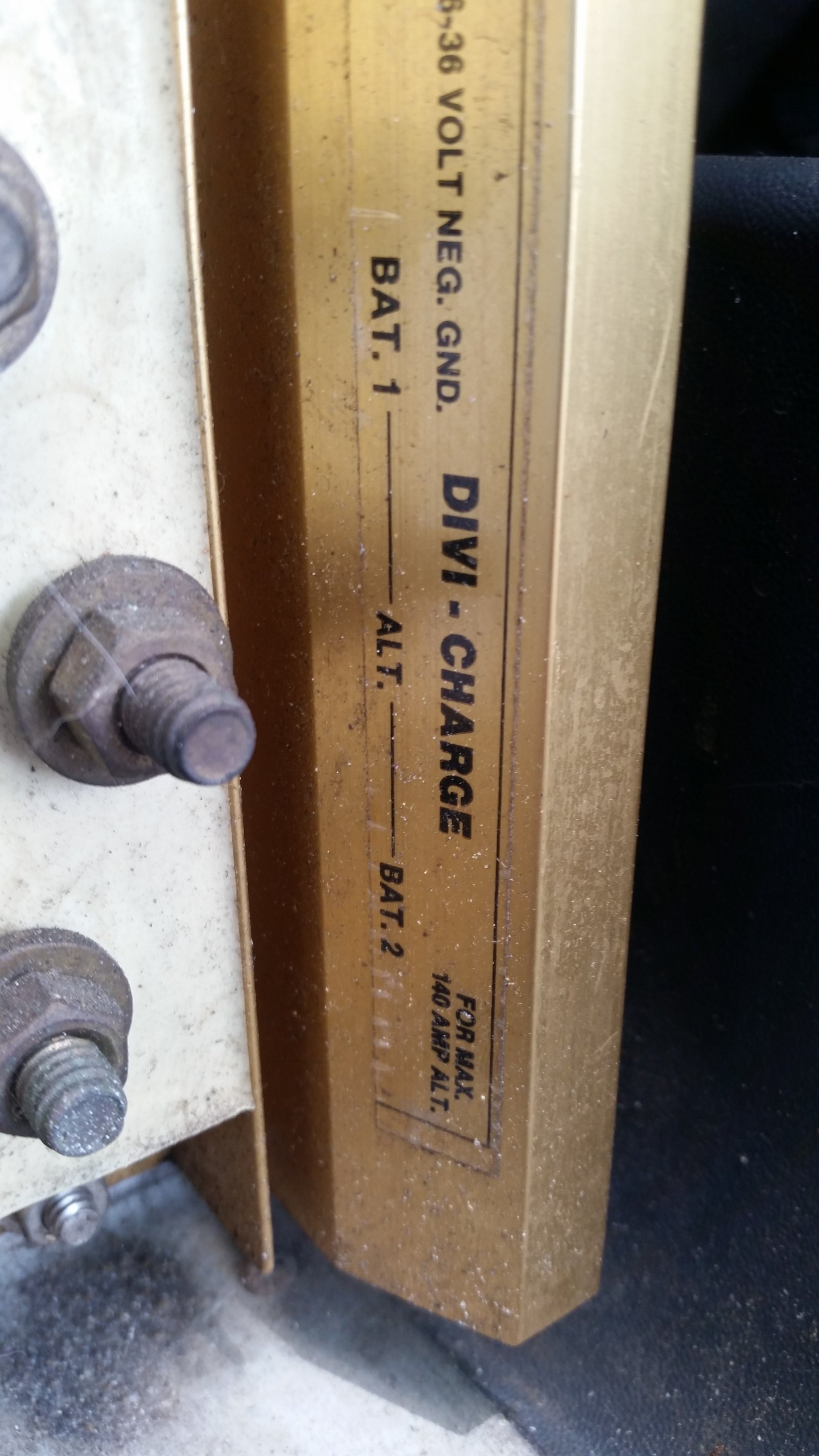

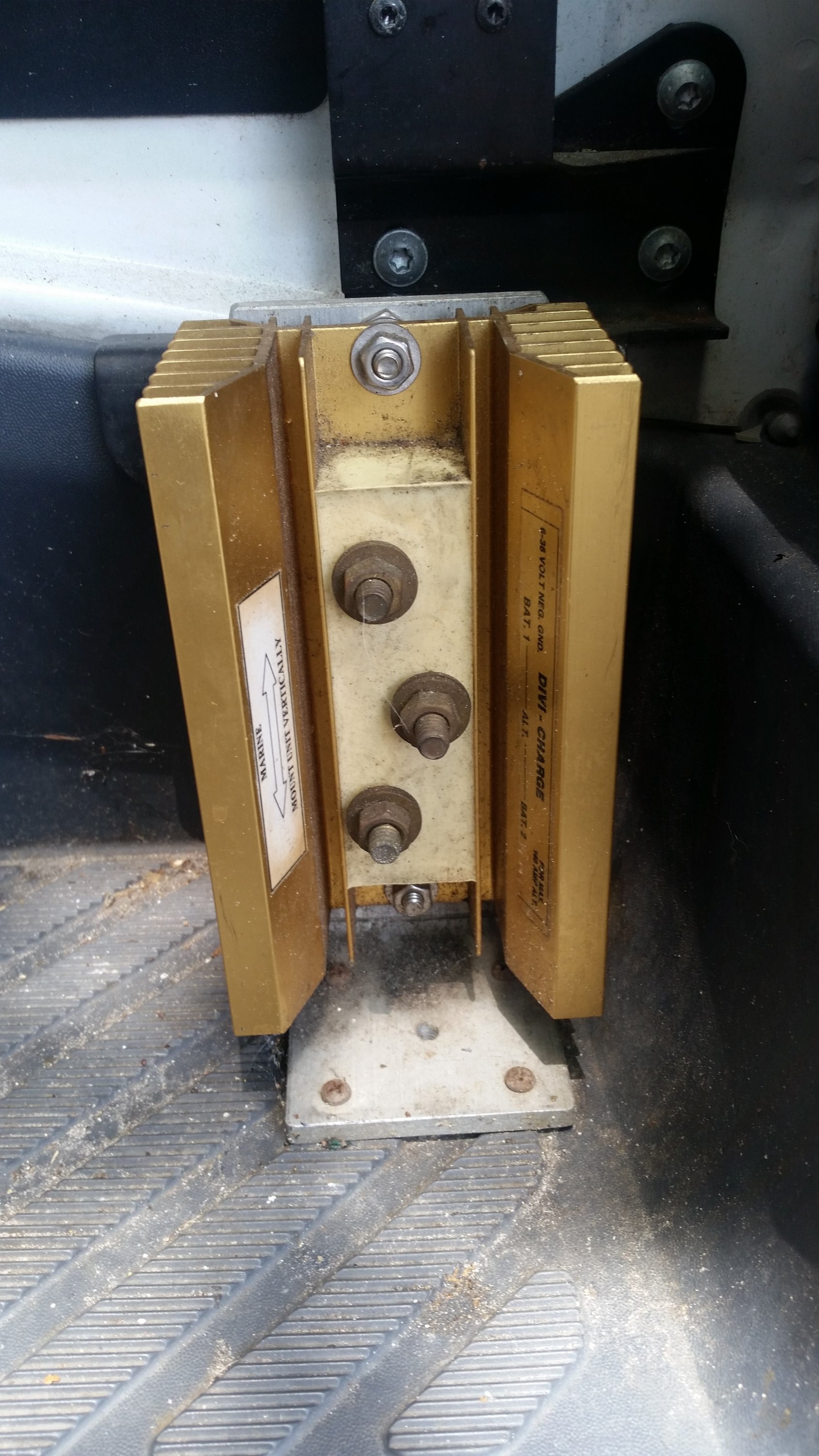

Can someone tell me how the below device compares to an ACR/VSR. It came installed in a Used Freightline Sprinter I bought for work. The previous owner was a marine diesel mechanic, so I figure it came off of a yacht at some point.
I am not running a second battery bank in my truck, so I would like to repurpose this on my Hunter 31. How would you wire this in with two banks and a 1-2-both-off switch? Would this work with the standard Hitachi alternator on my Yanmar 2GM. Someone mentioned issues with exciting the coils in another forum.
23,162
It appears to be what is called an isolator. It separates two battery banks when charging stops. They are way old technology and induce a voltage drop of up to a volt, not helpful when charging. ACRs are replays that do not induce voltage drop. Don't use it.
Unless you wanna go back to the 60s. :)
Sep 28, 2008
922
Canadian Sailcraft CS27 Victoria B.C.
An ACR doesn't have voltage loss. The isolator you show has about .7 volt loss. If you have an external alt regulator with battery voltage sensing it is fine. Otherwise an ACR is a much better option.

There is nothing good about diode isolators.... Re-purpose it as a boat anchor or garden ornament..:biggrin:
