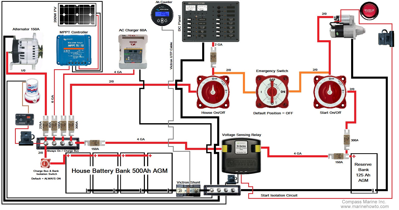

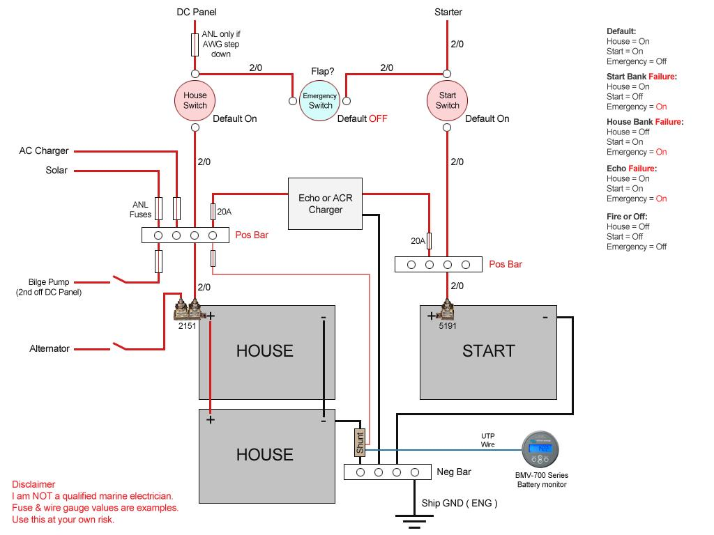

I am figuring all this out as I go along and utilizing great advise from Main Sail/Compass Marine, but I am still in the "I don't know what I don't know" stage. I am a little foggy on battery size cable. The original configuration was 3 Trojan T-1275 150 AH batteries where one was designated as the starter batter. Two ON/OFF switches, when both are on, the batteries are parallel. All this is wired with AWG 2/0 battery cable even to the engine.
The new configuration is combine all 3 into the house bank and add a starter battery ~650 CCA and a third ON/OFF switch as per Maine Sail example. My question is should I wire the whole setup with 2/0 or use 4AWG for starter battery to battery/switch/engine. I will terminal fuse the starter as per M.S. as well. Is there a possibility of burning up the 4AWG if starting from the house bank when the starter battery has failed?
I am also not clear on AH vs CCA. In the Bluesea circuit wizard, the option for Battery CCA is CCA or MCA. If a circuit is originating from the house bank, there is no CCA rating only AH. I need to go back and read Calder.
Feb 6, 1998
11,772
Stick with 2/0 wire as it will allow you to properly size your fusing to the max ampacity of the wire, and accommodate emergency engine starting from the house bank. On a 42' boat you're likely looking at a 300A or larger fuse...
The bottom line? If you intend to fuse both banks, and either bank could be called upon for starting, then you need wire that can handle the fuse rating that can handle starting loads or windlass or bow thruster or inverter charger etc.... Also larger wire will get more voltage to the starter and your starter will have more cranking ability and live a healthier life. If you have a large inverter-charger 2/0 might not even be large enough unless the run is short...

One other wrinkle in the implementation is the boat is all aluminum and everything is isolated ground. I have an Echo Charger to install and have been thinking about the ground. I have the 3 on/off battery switch setup and the house and starter ground are separate unless the switches are set to parallel. Should the single ground lead from the Echo charger go to each ground battery terminal or make a common bus bar like the attached drawing. I can't find the link to the borrowed image below, but the my plan is the same with the addition of isolated ground. I may have missed the mark in choosing the Echo as the common ground bus bar defeats the purpose of isolating the ground through the switches. Any help is appreciated.
Sep 28, 2008
922
Canadian Sailcraft CS27 Victoria B.C.
I see no reason for isolating the grounds of each battery from the other. On a metal boat it is important of course to keep all grounds isolated from the hull.
While I have not tried it I believe that neither the Echo Charge nor an ACR will operate with isolated battery grounds.
Sep 11, 2016
4
Via Marine 42 Rockland, me
I don't see a reson not to have a common ground to the batteries either. But, I don't know what I don't know. What are pro's and con's of having a common ground for the batteris on a isolated ground system? In this case, my system would be as the drawing, just remove the ground from the dual switches.
Thanks for the input!
Feb 6, 1998
11,772
Your drawing shows common negatives for the banks and this is correct..
On a metal boat the batteries/neg/Earth are often isolated from the ship and the engine should be as well. This requires an alternator that is isolated ground as well as a starter motor and engine alarm circuit. Creating an isolated ground system is not easy. This is a typical drawing for a 30-45' sailboat using three ON/OFF switches & a house bank charge bus isolation switch..
Rodd

Jan 7, 2017
92
beneteau 36 new london
> The three switch configuration has little to do with "combining banks" it is all about isolation, redundancy and the ability to "cross-connect" either bank to power and start the entire boat in an emergency
>If you want the three-switch configuration wire it properly with three switches.
>If you want a 1/2/BOTH install a 1/2/BOTH...
here's my separate thread for discussion of "creative variations"
http://forums.sailboatowners.com/in...y-switches-layouts.182986/page-2#post-1347024

Maybe this has been touched on somewhere in the last 10 pages, but a useful mod on Beneteau's with their usual 3-switch setup with a switch to break BLACK as shown....
Is to re-task the 'Black' switch as Maine's 'emergency combine' and re-wire. I used liquid tape to re-cover the black handle, and a label maker to re-label.
