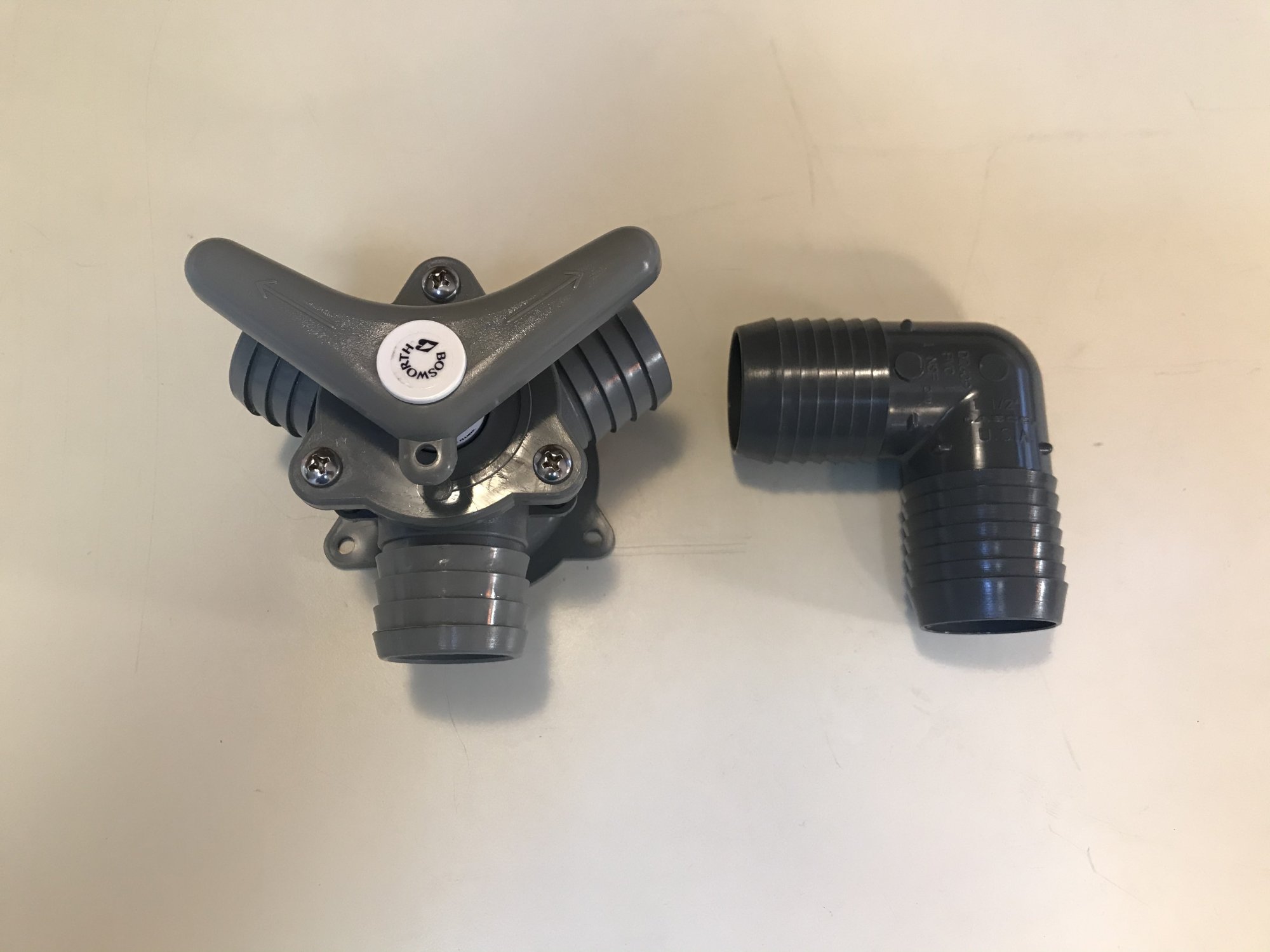

Installing 1 1/2” SaniFlex hose. The Y valve (measures 1 1/2”) fits easily into the hose but the 1 1/2” elbow doesn’t fit easily (because it measures 1 5/8” ... bought at Ace Hardware). What elbow do I buy to fit the 1 1/2” SaniFlex hose? Thanks!

Any chance of damaging the SaniFlex hose by stretching/forcing it on to a barb 1/8” larger than its 1 1/2” diameter?

The one you bought at Ace is likely 1 1/2" pipe size, measured inside .

Domestic plumbing fittings are sized according to the ID...marine hose fittings use the OD to fit into hoses, which are are sized according to their ID. 1/8" is quite a bit to stretch a hose....it can cause small tears to develop. I'd return the one you bought at Ace and buy a marine 1.5".

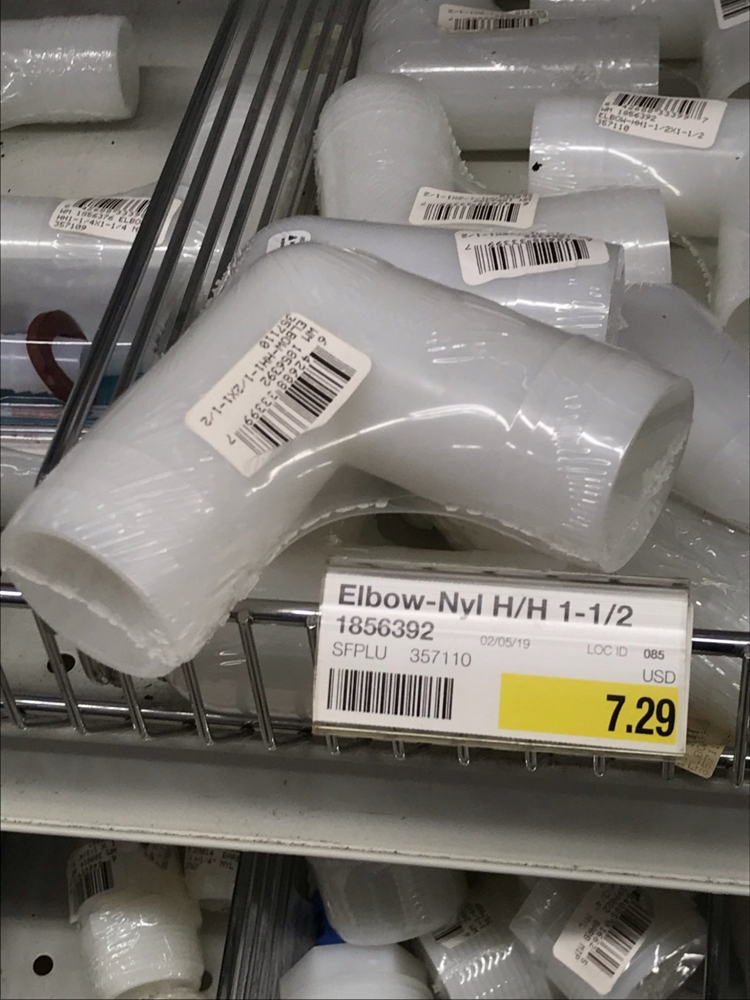

It might if one end were threaded AND it's stated size is the OD (see post #8 above).
Malyea...those are nylon fittings. Nothing wrong with that, but I wonder why nylon didn't turn up anywhere in my search for "plastic tank fittings."
