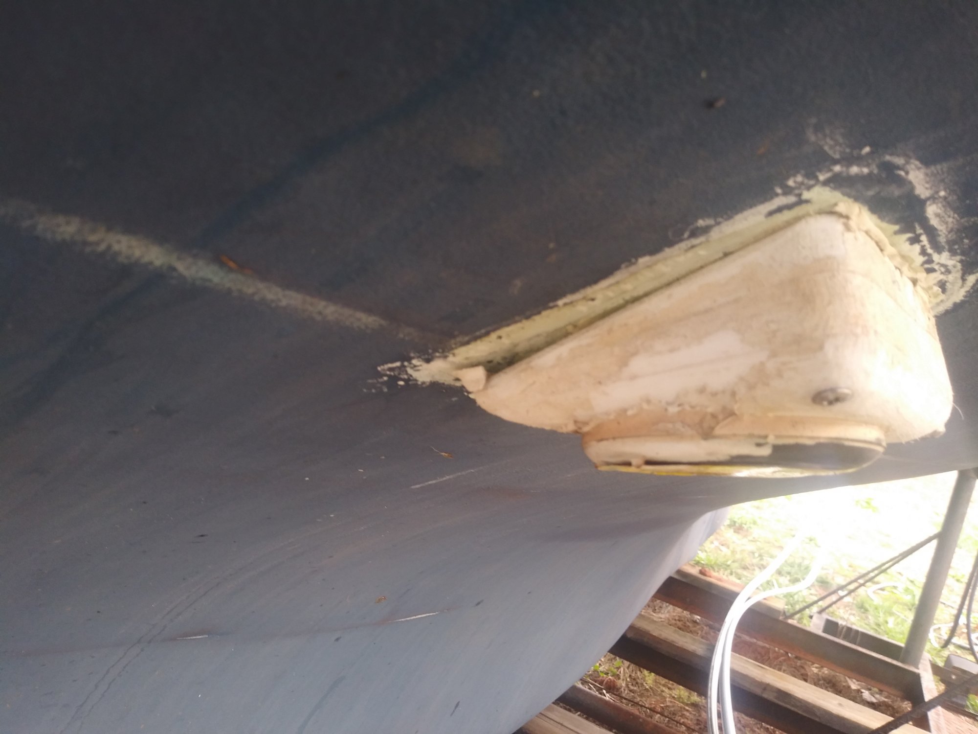

Well once again, thx for taking a moment of your time guys... Well just as the previously discussed long scratch that even been superficial took the paint of for 3 feet long and 3 inches wide, the deepth sounder also suffered damage. How they managed to so i dont know. Its as you can see sort of detached. Now then, would it be better to use 5200 or... West systems products and make it stronger in place.
Im afraid that with upcoming liveaboard use and traveling it might start leaking and being a pain. Thats why i considered tbe use of west system. As always... Thx for your advice guys.

What on earth are we looking at? Why is that box puttied to your boat's hull?
Feb 20, 2011
8,062
We're looking at a depth transducer mounted on a hunk of something devised to get it somewhat perpendicular to the waterline.
Or something...:biggrin:

Thats exactly right, according to the instructions it had to be mounted at that
angle for it to get the right readings.
I know is going to cause certain degree of drag and thats another reason i thought to use west systems instead of 5200...any thoughts on that pls?

Yes at an angle but not necessarily with a box hanging on to the hull. That looks like a box for a Side looking or forward looking sonar, not just a depth sonar.
Here is an image of a thru hull transducer with the sonar transmitter angled inside of the thru hull to the vertical. Nothing needs to be in a box on the outside of the hull.
You want to use an adhesive caulk designed for underwater conditions. 5200 is what I would use in this application.

I agree with your concerns about leakage. You want the block to be permanently attached to the hull. My preference is West systems products, Gflex or 105 epoxy with 404 or 406 additive would work well, 5200 is also an acceptable adhesive. For other posters, the block is necessary on some hulls because the deadrise angle exceeds the limit of the transducer, usually around 22 degrees.

Yes youre right on the money, its a Garmin echomap 74DV

I suggest you re think your existing through hull system and install it in a more conventional way. So... first thing is to READ THIS ARTICLE "Installing a through-hull transducer" to understand my meaning.
No matter how much epoxy or adhesive you apply to that external "box" you're always going to have issues. So... back to the beginning with a better plan... it will pay off in the long run, I guarantee it.
