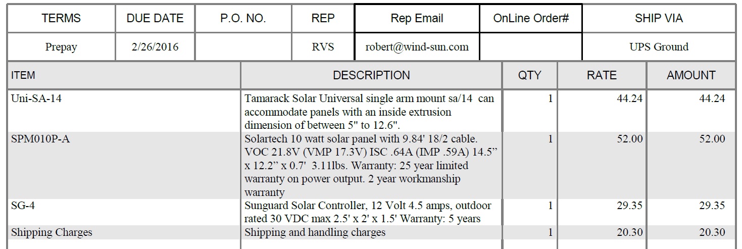

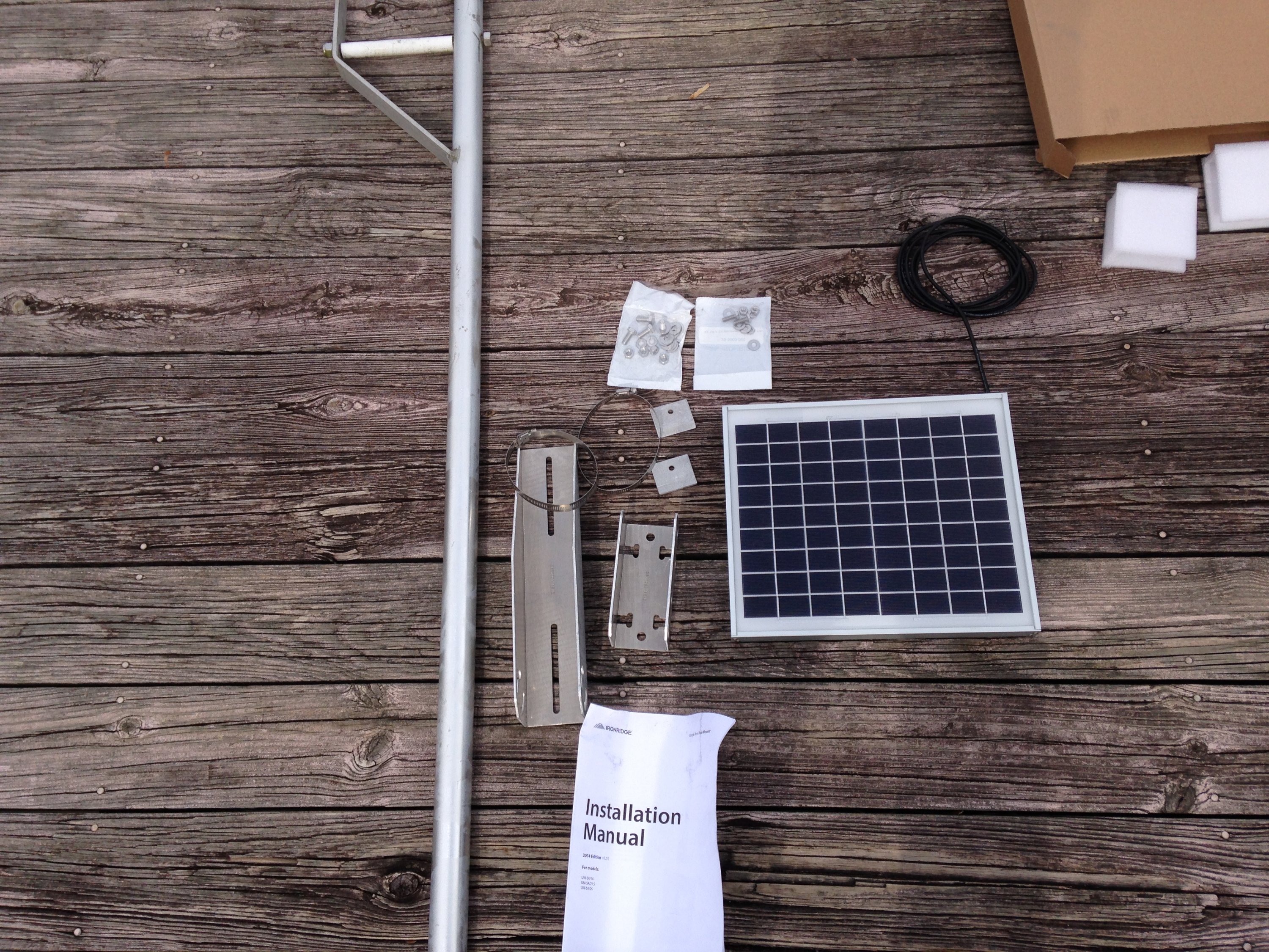

I wanted to share my experiences installing a solar panel on the mast crutch pole of my H26. I found a really nice company called Arizona Wind and Sun and I called them and talked to a guy named Robert Snipe and he very carefully talked me through the project and made sure I had the right parts.... and he didn't even try to sell me stuff I didn't need :wink3:. Anyway, I now have a small solar panel mounted to my mast crutch that puts out 0.57 Amps so I should hope to get about 6 Amp-Hrs a day. Total cost was $146 with shipping. I already had the plug through the hull so add another $5 for a trolling motor plug if you need that.
The mounting bracket connects to the pole using two worm screw clamps (large hose clamps like the ones you use to attache exhaust hose to the dryer). I drilled two holes through the mast crutch pole and ran the electric through the pole. The rubber grommets I got at Lowes and they are to keep the sharp edges of the holes in the pole from chaffing the electric lines for the panel. It took me less than an hour to install. Here are the pics and part numbers.

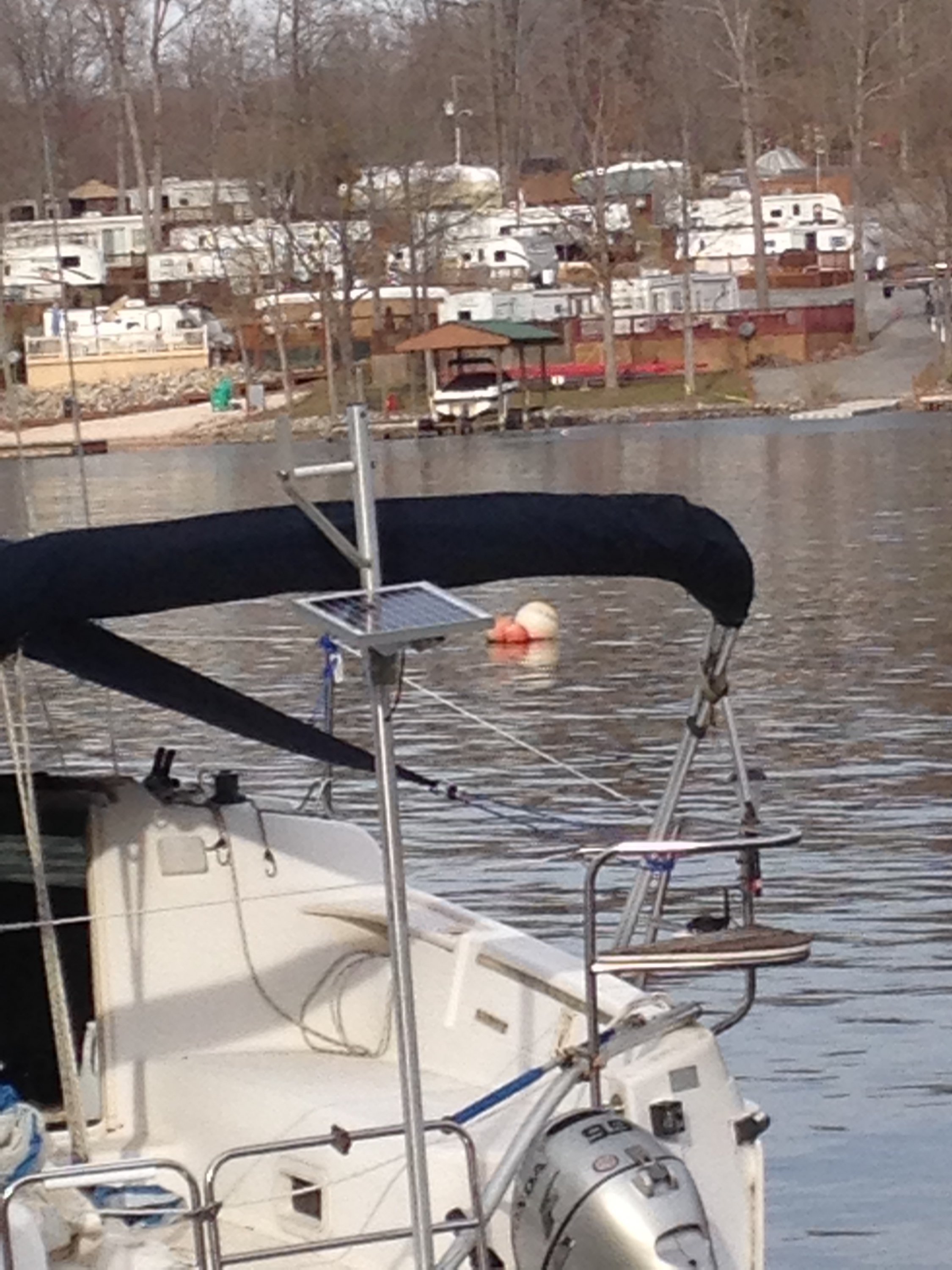

Nice install and I used that controller with success when I just had a 40 watt panel on the boat. Now I use two MPPT controllers and a friend uses my old controller on his race car trailer to keep the winch battery charged.
Looking at the picture of your boat it looks like in the picture that their is shading going across the panel from the mast support. If that is true and happens for much of the day it will probably kill most of the charging from the panel. This might not be a problem if the panel is just maintaining the battery in the slip and maybe not underway either. The 10 watt panel isn't much so even with your small loads the battery might go down some on a couple day cruise but maybe not enough to be a problem.
I know Walt is performance oriented so weight is always a consideration for him but if that isn't the case you could mount a larger panel for the same initial price (Solar Blvd for instance has a 40 watt for $58) so that might be an option if you find you need more output from a panel. That controller will handle up to a 60 watt panel and probably even an 80 watt as it is unlikely that we get 100% out of a panel on a boat at any time.

The Hunter 26 is a trailer sailboat and that pole is the mast crutch for trailering. The bow pulpit also has a built in mast crutch. The P.O. left his boat in the water but he also left the crutch pole in place. Said it made a nice pole to grab onto. So... I looked at that and said... makes a nice place to put a solar panel. The bottom of the hull on the H26 extends about 3 inches past the transom making a small ledge. The pole sits on a pin on top of that ledge and is then secured to the back of the transom with a U-shaped bracket.

You are probably correct to assume I will get less than 6 amp-hrs out of a day depending on my orientation to the sun. I have a battery monitor so I'm guessing if things start to run low, I will pay attention to the angle of the panel. It is not hard to twist the mount to different angles. After the install I got the feeling that it would not be too hard to put two of these mounts on the same pole and stagger them 120 degrees apart facing aft. Add a bigger panel and I just might start thinking about that stereo... :)
I'll let you guys know if I was able to keep up or not. As the cost of panels keeps dropping... I'm guessing we will all start covering our boats with more and more of these things. :dancing:
