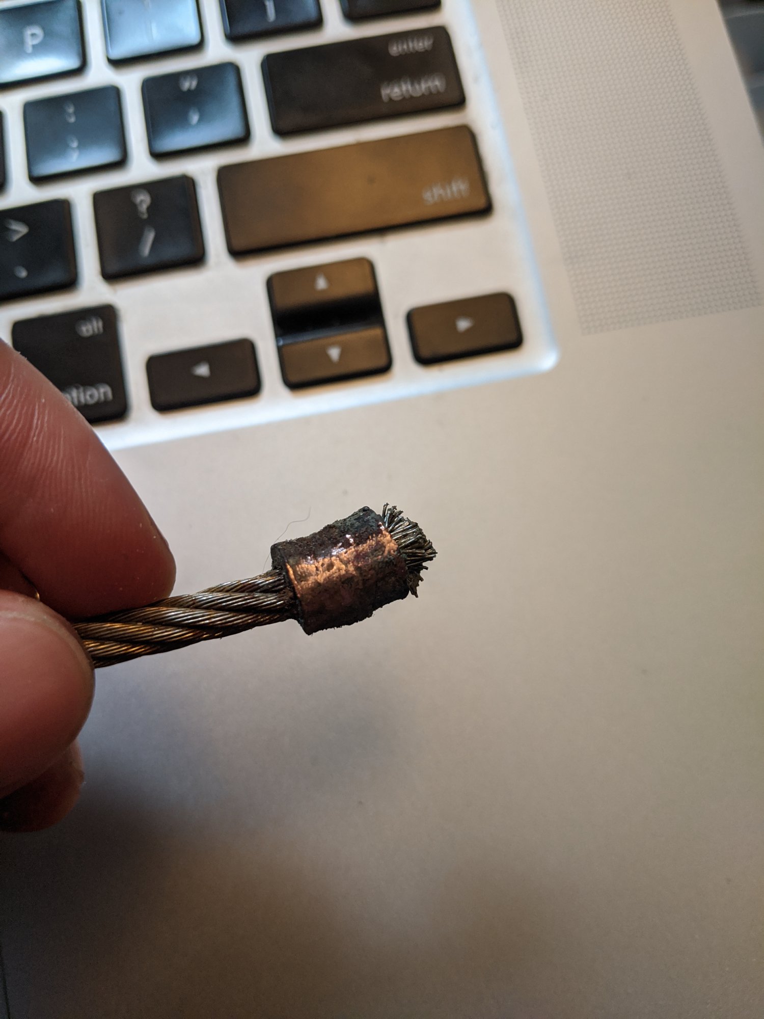

Finding a place that can actually do it correctly is proving difficult. The boatyard told me they could do it -- but the swager tool they wanted to use was an older 7 cavity version of this tool which is only rated for aluminum and copper,
When I researched similar tools from Loos and Nicopress, their multi-cavity swager tools were also only rated for aluminum and copper, and they had a different single cavity tool that is required for use with stainless steel. The yard also claimed that they typically use zinc plated copper for centerboard pennants and that it lasts a long time.
So, I am left with deciding if I should use the stainless steel sleeve with the wrong swager tool, or the zinc platted copper, but with the correct tool.
I found the stop sleeve that was on the old cable (see attached) which had not been replaced in over a decade, and it was plain old copper. Or perhaps it was plated at one time and the plating was lost. It still seems to be in plenty good shape -- though the boat was also in freshwater that entire time. I plan to be in saltwater for 1-2 years before heading back to fresh.
As often seems to be the case with boat repairs, I know what I want, but I must choose between less ideal alternatives. However, those less ideal alternatives might still be good enough.
