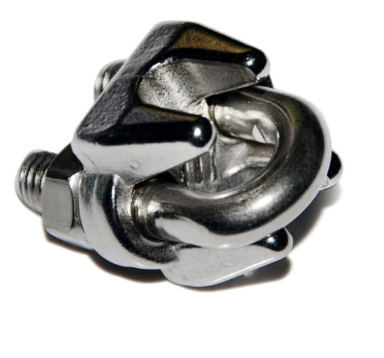

Right.... you probably want something like this... or two or three of these.
