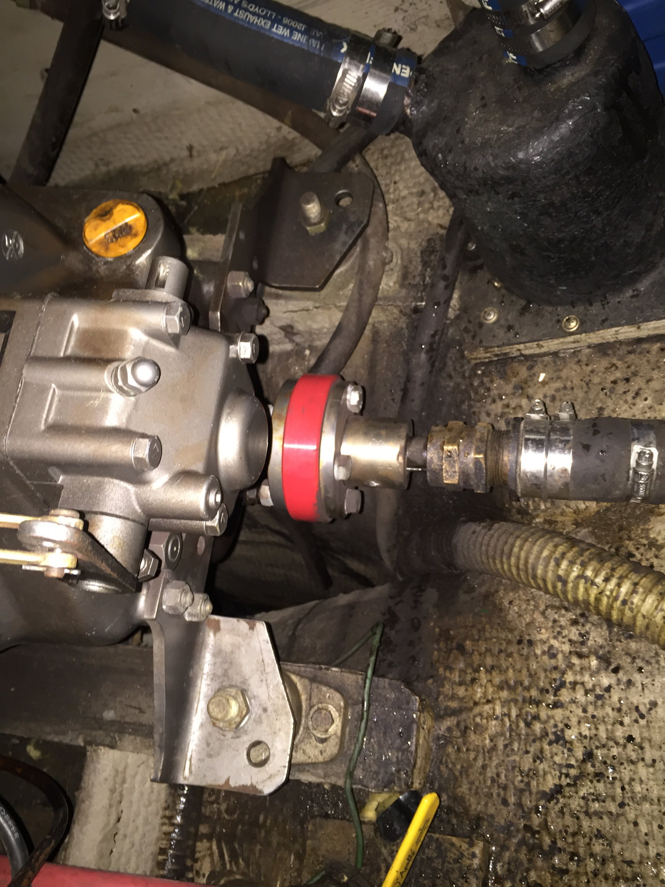

Ahoy. I figured my first post ought to be a good one, but maybe it's not.
After purchase the previous boat owner told me (after I launched) that the transmission coupler on the prop shaft side needed to be replaced, but neither I nor my boatyard guy saw anything wrong, nor can we seem to duplicate the described clunking sound.
(For the sake of this discussion let's ignore any of the potential political interpretations of the situation....I think it's an issue that came up for the boat owner at the tail end of last season and just wasn't communicated well to the broker. It would've been an easy fix on the hard, so I am told, though maybe more complicated in the water.)
There's about a 1" red plastic drivesafe in there that looks intact, the bolts I can reach seem tight and not stripped, yet we cannot seem to find an issue in forward, neutral or reverse, at idle or higher rpms.
I'm basically a total newbie at engine work so I'd love any advice or comment on how to really identify whether there's a problem. And if you've seen something similar, was it addressed in the water or did the boat need to get hauled and re-launched?
Thanks!!

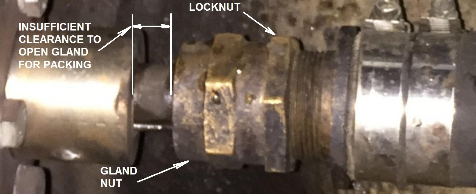

The red plate between the two couplings appears to be a flexible coupling. Not clear on its function as the rubber hose attached to the base of the packing gland usually acts as the flexible coupling. What this red coupling has done is place your stuffing box in a position where the packing cannot be changed without disassembling the flange couplings. Not a good situation at all.
But one problem at a time. Do an alignment check yourself if you can or get your mechanic to do it. An alignment can be very time consuming but following the instructions is not too complicated. You really should start doing as much simple engine work as you can for two reasons:

From what I've been told, the red plastic "drivesafe" is essentially the part that would break in the event of a grounding or prop fouling that would potentially otherwise break the coupling. It is an inflexible spacer with staggered lag holes for the shaft side and the drive side couplings.
Presumably upon loosening and removing the attachment bolts on both sides of the drivesafe it can slide right out, allowing the additional space needed to make the repair.
But I cannot even determine if there's a definite problem. I had a 4 hour shake down sail on this vessel yesterday during which we ran the motor for probably an hour to n the front side of the trip and a half hour upon returning. No weird noise or signs of problem at all.
