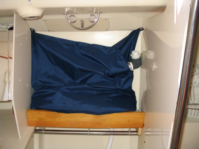

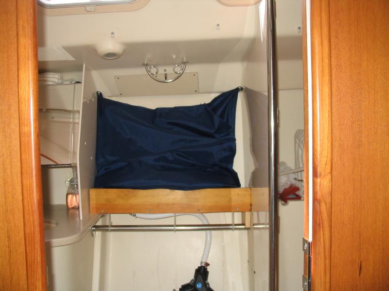

Peggy: Attached is the only photo I have readily available of the temporary version of the fresh water tank I installed on my Hunter 410. The boat is on the hard an hour away. The black valve at the bottom of the photo is plumbed into the head intake line. Thus, there is no need to open the intake through hull to use and flush the head. The tank is filled from the shower spray handle. I have since built a starboard box and enclosed the bag tank where it is now. The top of the tank is useable for storage of towels, etc. and the fill fitting pokes out the top as well.
Post edited to add a second picture showing fill fitting.

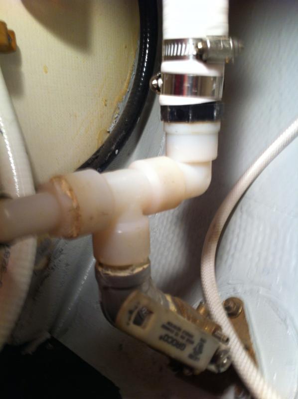

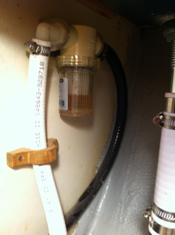

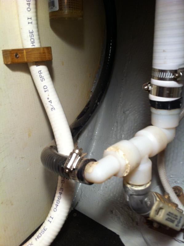

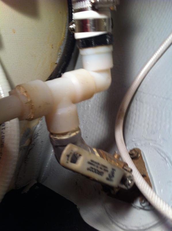

thank you Peggy...yes i ill be more than glad to...i didn't write any info about the install as i felt that YOU having recommended this arrangement would know exactly what or how to describe it.....if you have any questions please feel free to ask....
regards
woody
P S Peggy..plz.. send me an email to woodster3046@yahoo.com ...i am not sure how to email you theses through this site .......

not sure this is going to work Peggy but here goes....
Sep 15, 2009
6,244
S2 9.2a Fairhope Al
:confused: not sure this went through there is no place on sending you an email to copy and paste the reply...not enough nuts and bolts....
