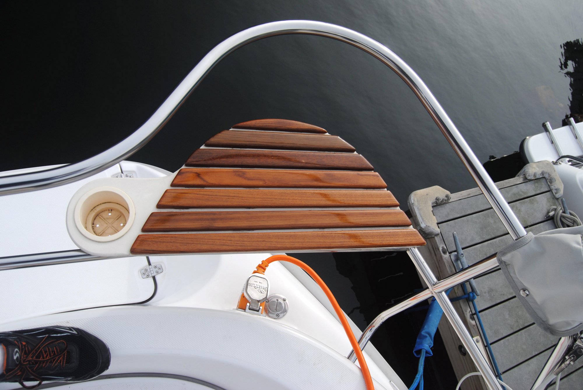

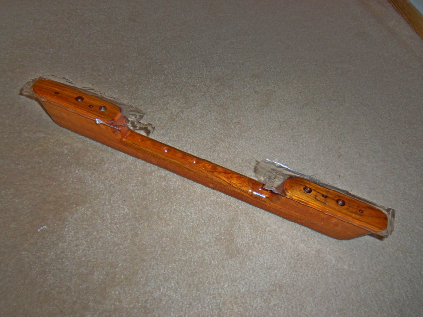

The only exterior teak I have on my boat is the pushpit seats and a few handles on binnacle table tops. Given that you have the experience, skills and time, I would coat your sanded woodwork with ~ three coats of clear epoxy followed by 3 - 4 coats of marine varnish. Looks like wet varnish for year to come.
Above is a teak grab after three coats of clear epoxy ready for removal of the rough edges and any drips.
If your boat has any amount of external woodwork, finishing it with epoxy would look spectacular IMO and require less work in the long run. Lots of learning to start with.
