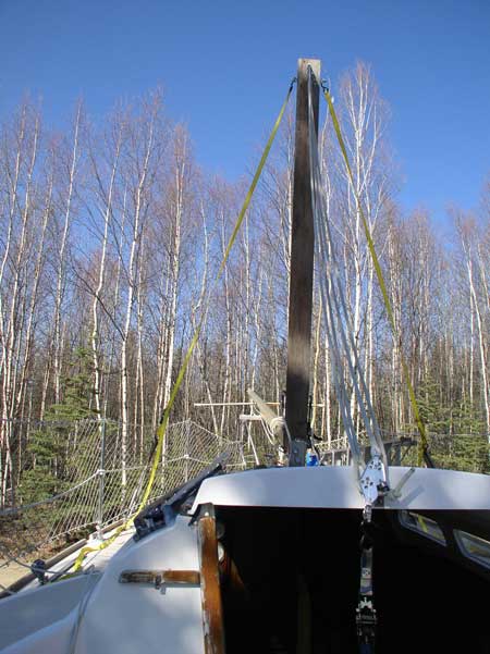

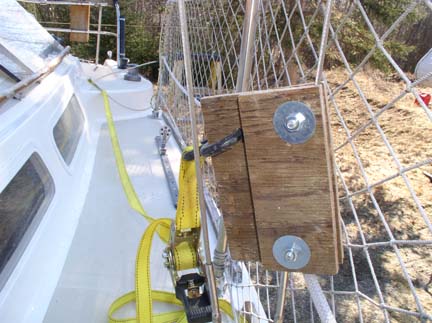

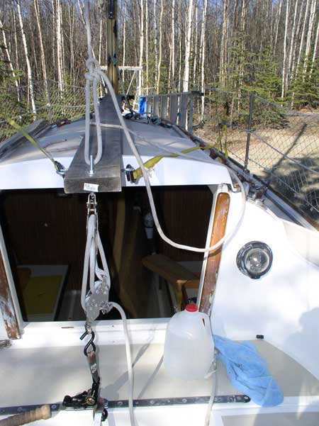

I don't really have great pics of my system but I do have some. I use my Main sheet for lifting, a gin pole made from a 2x6, main halyard to the gin pole, And ratchet straps from gin pole to outer shrouds. The straps go to blocks of plywood I made that are two pieces that bolt together so to clamp on the shroud shown in first two photos. You need to get them so they are close to the pivot point of the mast in elevation. Whats good about this is it pulls the shrouds semi tight giving the mast side to side stability.
Now the gin pole is notched to fit the mast and goes on it about 6" up. I have two eye bolts on either side and a strap goes from one around the mast and over to the other to hold the pole in place at the base. Two other eye bolts near the far end of the gin pole on each side go to the respectful straps to the shrouds. Then an eye bolt on the face for the halyard and one on other face for the main sheet. A 4 to 1 reduction on the main sheet made it really easy to raise and lower the mast.
Some problems I had 1) I need a longer main sheet that is why you see the strap from main sheet to traveler. 2 ) don't pull the straps to tight from gin pole to shrouds. I leave them slightly slack. 3) when lowering the mast you need slack in the main sheet and have to start the mast to lean by hand. First time the strap feel off the main sheet and almost lost the control of the mast. Now I use a more positive tie off then just the hooks. But a longer main sheet would eliminate the need for the strap!
