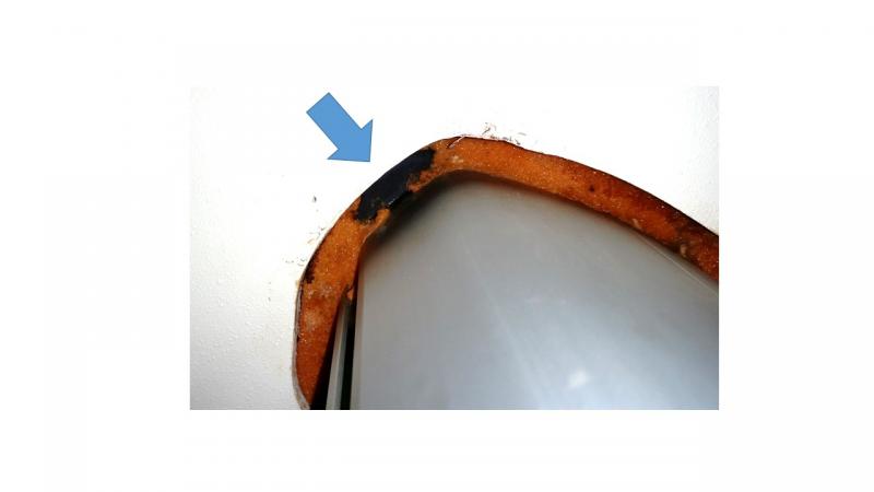

On my relatively new to me Oday 28, our mast seems to be allowing water to travel down into the bilge, a nuisance. Generally not a lot of water, but here in FL, we have had our fair share of intense downpours, generating 7+ inches of rain.
My bilge pump works fine, and we are talking about a couple of pints of water, with an average storm. You can see minor remnants of water around the cabin top, where the mast comes through, as shown in the image.
There is no mast boot, just Gorilla tape at the base of the mast, with some silicone in the mast slots.
If you look up into the mast hole, what seems like old foam, with a bit missing is visible, see image ---

I removed ALL the old electrical tape that was wrapped around the base of the mast, and found it had an ANCIENT mast boot installed,,, yellowed, cracked, and the strapping so rusted that when I went to tighten them, the heads of the screws started to separate,,
as a temporary fix, I applied a generous coating over the obvious cracks and unsealed areas with a waterproof, adhesive molding,, let that dry, than re-wrapped the base with a waterproof tape,,
the problem seems to be the recessed channels (3) in the mast, that penertarte the cabin top,,, as Stu suggested, my plan is to cease the flow of water down those channels BEFORE they reach the base of the mast,,

I do agree with the posted comments --- I DEFINITELY had water coming along the exterior of the mast, inside the cabin, as evidenced by a water trail along the mast, and slight staining around the esdges of the mast/cabin top hole -
there are obviously other opportunities for water to penetrate the INSIDE of the mast, either through the top of the mast, or the holes for the upper shrouds,
I wanted to seal the water OUT, (thank you Mr. Jackson) from coming into the cabin, along the exterior of the mast -- and I do believe I have accomplished that (epoxy putty over the original foam and re-sealing the mast boot, and using putty above the boot in the mast channels for diverting the flow of water)--
