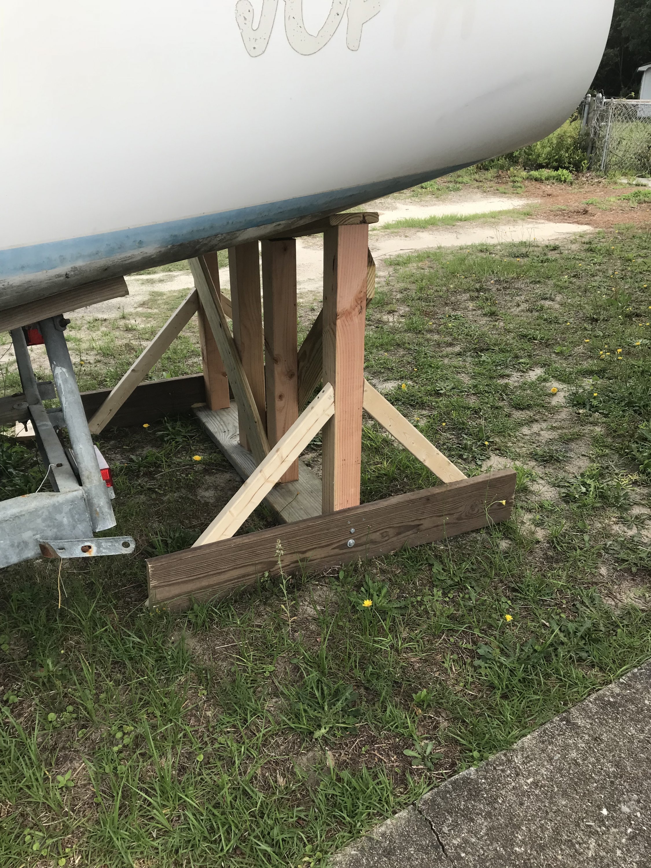

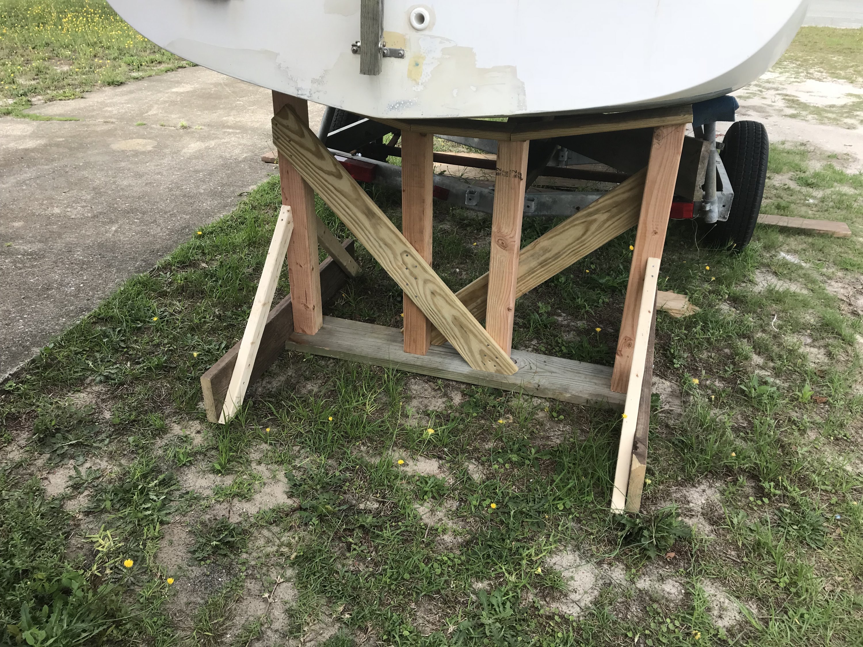

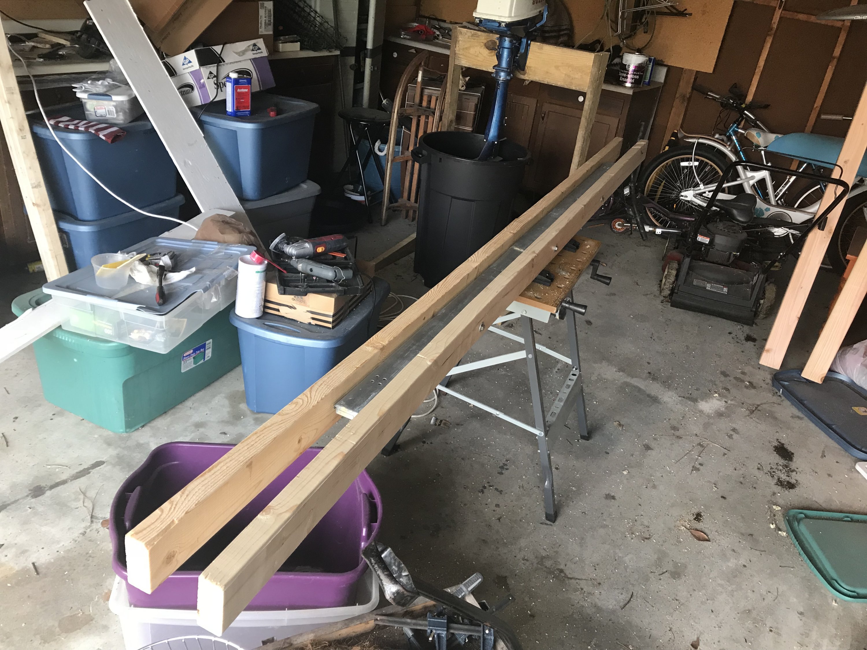

just finished the rear support and building the “beam” to get her off the trailer. Planning on auxiliary legs in the middle for the beam once the trailer is moved. And more support front and rear of the keel just in case

Nice. Connect those two supports and lift the whole thing up onto casters and you may not need to replace the trailer. ;)

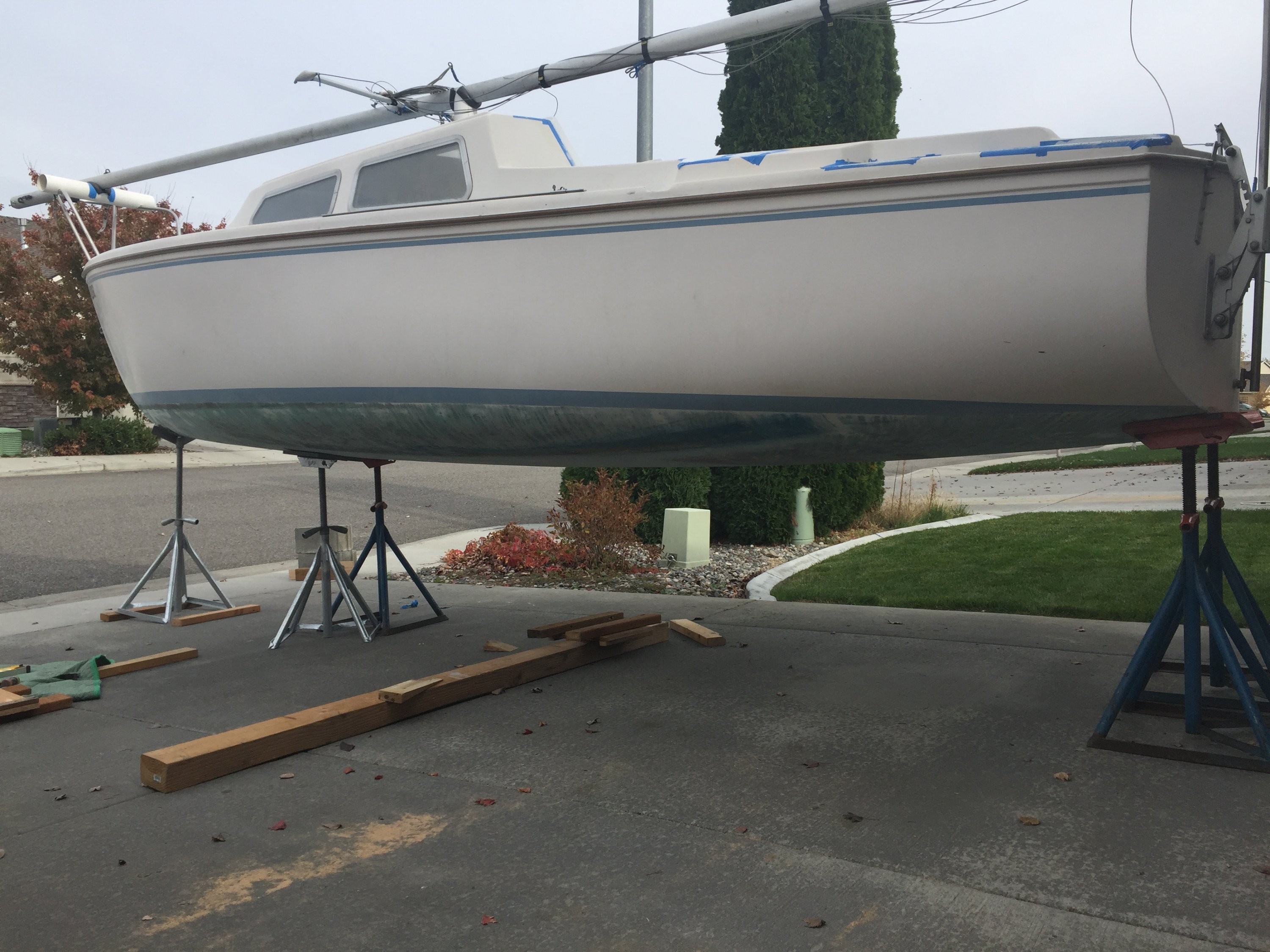

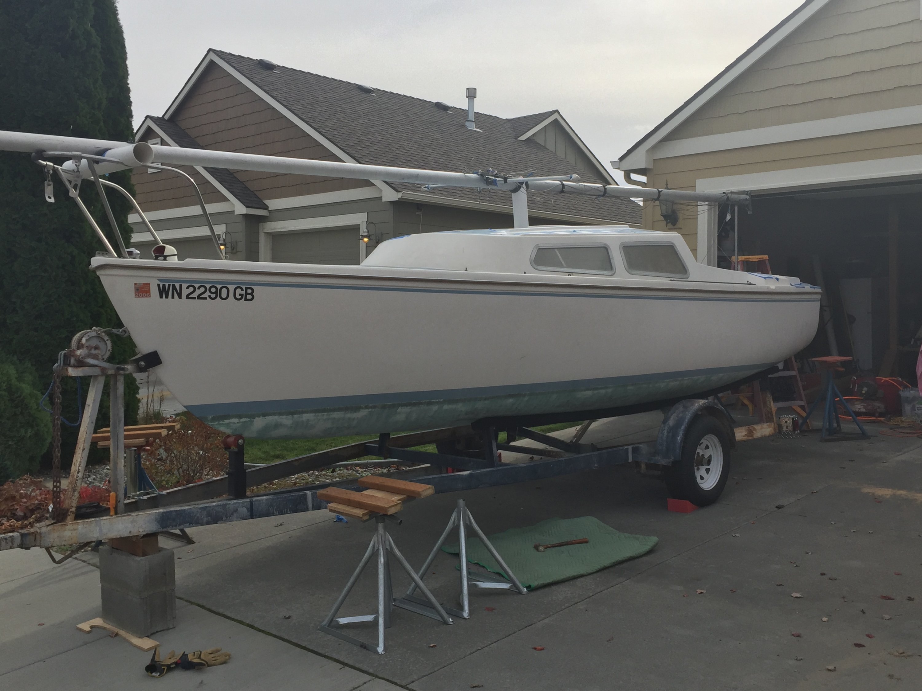

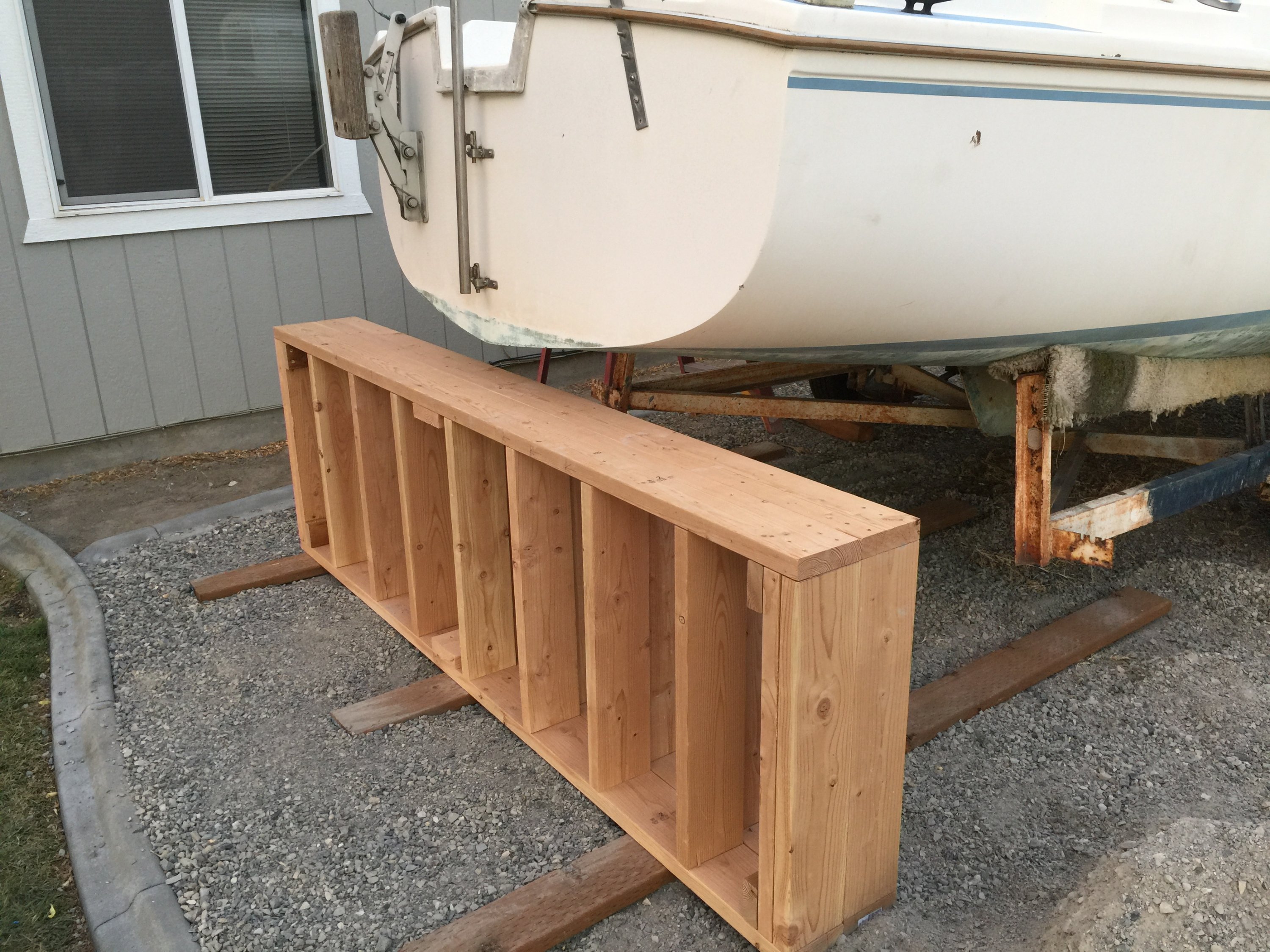

looks great-- word of caution: be mindful of the distance from the stern you have the lateral support. I found anything but right at the joint (plus or minus a few inches) started into the belly of the relatively unsupported hull. Just make sure as you load up the support that it's not trying to oil can your hull. I've switched over to boat stands but in my initial attempts you can see how close to the joint I stayed: and even in the boat stand model I tend to be within 6 inches of the transom joint

I would love boat stands.... Lumber currently is more in my budget. Tx for the heads up on the location. The plan was "as close to the bunks as possible. Then block just behind the keel trunk,as well as forward. I'll keep a weather eye out for oil canning for sure! But 6" from the transom work too.

A note of caution, do not put all of your supports close to the center line of the boat. Better to have a very wide stable base that will support the boat if you need to get into the boat for any reason.
The wider the better, I had supports under the out side rails and down to the ground at one yard. We had a very bad storm with over 45 mph wind and my boat stayed up right and another one with a similar setup, but no added supports fell off the supports.
Now I support all the way across the full width of the transom and at the max beam.

And chain them together. The surfaces of a boat bottom slope, so tie the supports together to keep them in place.

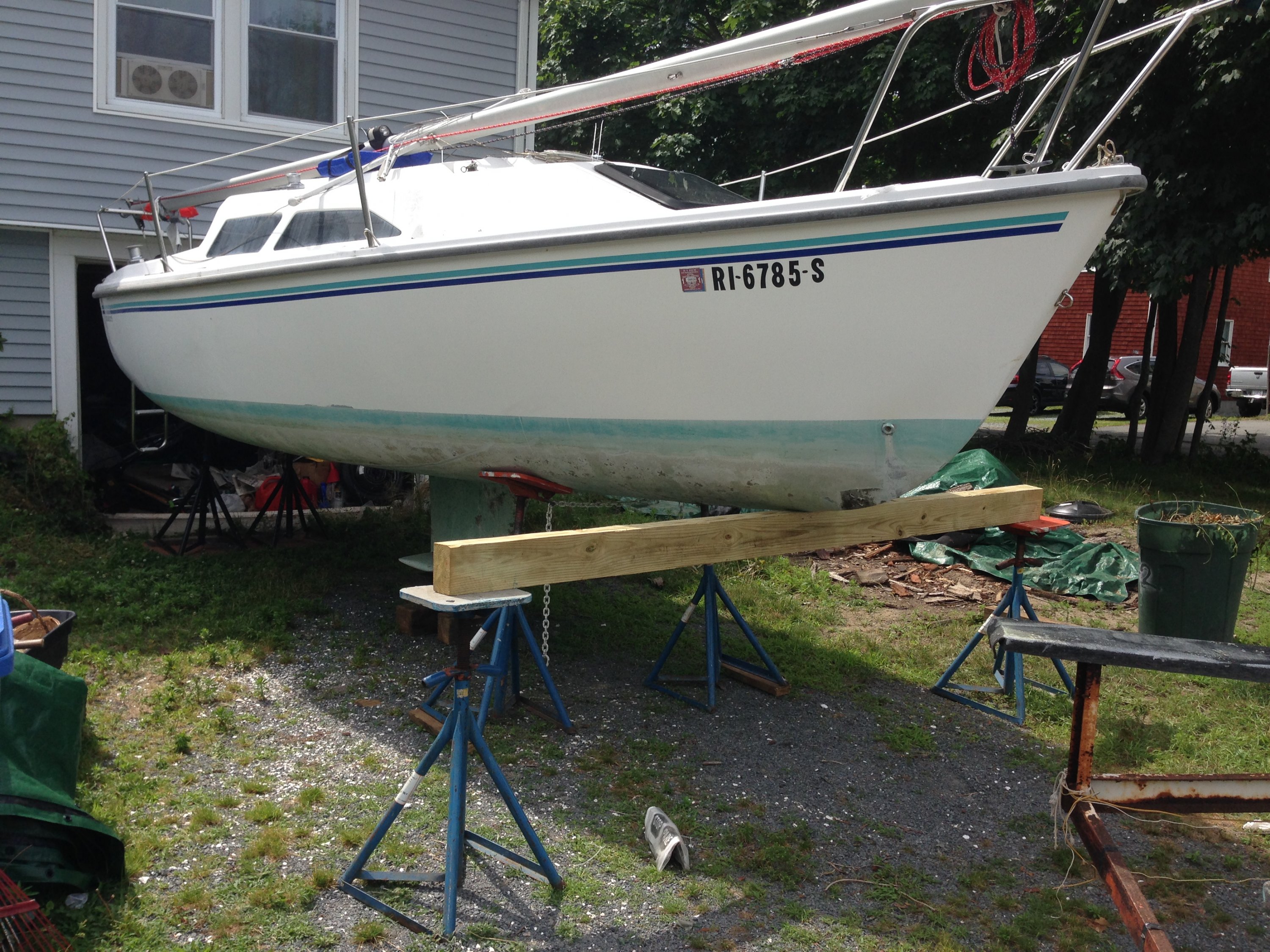

I just got some boat stands on Craigs list. used a 4X6 beam for the bow across two stands. got a bow stand for after the trailer was removed. Whole thing was pretty simple.
