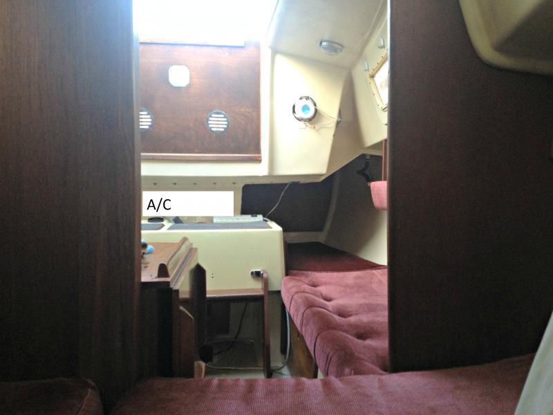

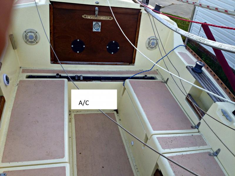

Kermit, what did you end up doing for A/C, I am finding myself reconsidering my A/C... getting to be too much trouble moving it in and out! I have two options, buy a unit and put in the aft outside settie, cut wholes to inside the cabin for cool air, and cut small port for exhaust, this solution is more expensive but less mods to the boat. option 2 take my window unit and cut an opening under the hatchway to slide the window unit into the cabin area. What do you guys think?

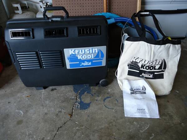

I use a krusing kool portable (mounted in sampsonite suitcase) 7k btu that I found on craigslist. I have it mounted all the way forward sitting on the shelf under the forward hatch. I have the water cooling hoses run down under the seats to under the sink in the head with an additional above water thru hull there. to run the ac simply place the pump in the water, pass hose thru the thru hull under the sink, connect to hoses from unit, and turn on the ac. freezes the cabin out!
I also have a honda eu2000 generator so I can use this on the hook. works great

This is the only photo I have of it installed. It is held in place with a nylon webbing strap and as I said, the two water hoses(feed and discharge) and electrical cord run straight down from the unit, under the bunks to a thru hull under the lav sink. Thats where I connect the feed pump (I screw a cap on the inside of thethru hull when not in use) and have the discharge line feeding into the sink drain. I also ran an electrical cords to give power to the unit and pump. There are photos of the unit on google images.
I dont use the forward vberth area because of this. I cut a 3/4" piece of plywood the size of the table and place it in the notches in the seats which makes a very large berth in the cabin. I use the back cushions as the extra cushions and made 2 additional ones to fill in the gaps. I store the plywood under the aft berth cushion.
Hope this helps
