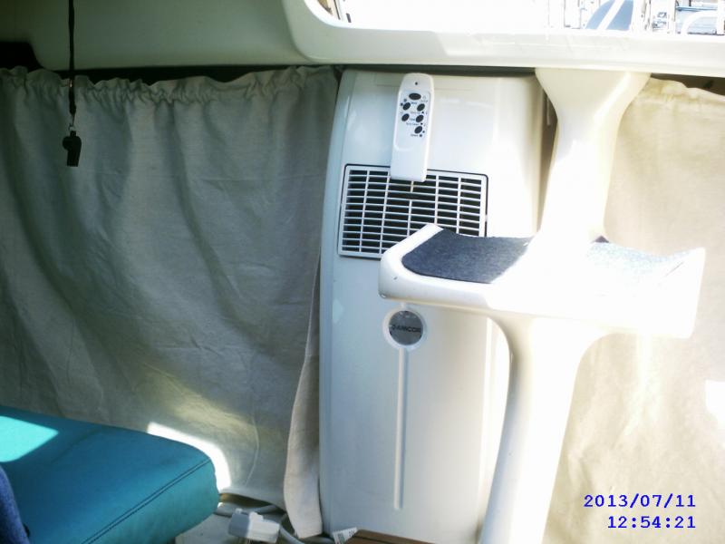

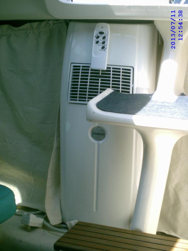

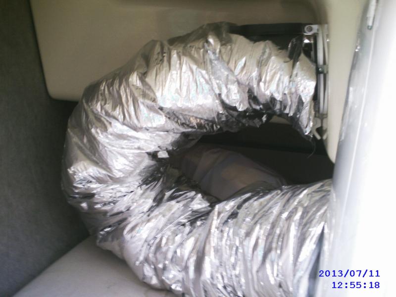

AC
This is what I use on my 23.5.Since I only use births under cockpit for storage fits great.Vents out hatch in cckpit.Only use it at dock,even with camping cover up still cools area well.Bought it on Ebay at vminovations,Refurb $200.00.Curtain off area so only cooling small area.Also rapped exhaust in insulated flex duct as it does get hot.made sumbrella cover not shown.Changed out exhaust this winter 90 degree fitting at window made lot more room.

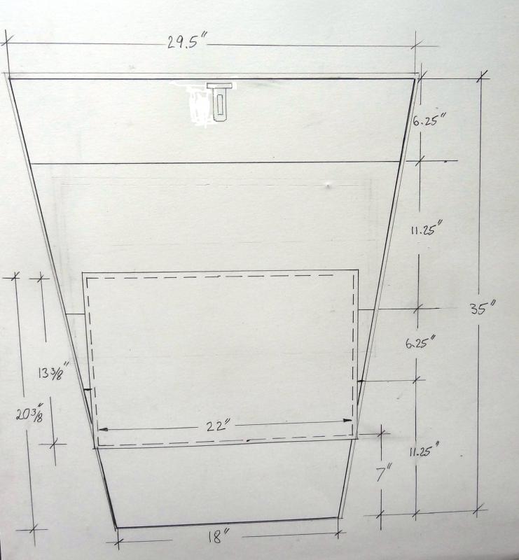

Just figuring how it would look like to fit the air conditioning unit in the companion way hatch of a H26/H260.
The picture shows the measures; the opening is 18" on the bottom and 29.5" on the top. The total vertical clearance is 35". There are originally 4 boards; two 11.25" high ones made of Plexiglas and two 6.25" high ones made out of wood.
Since the unit needs 22" horizontal clearance it would sit up about 7" and would go up to 20-3/8" from the bottom.
The top board with the lock latch could stay.
A boards would need to be cut about 16.25" high with the 22" x 13-3/8" opening to mount the unit on. And two other boards with 6.25" high would be needed, one for the bottom and one to fill the top gap.

Kermit,The unit I got from VMI,they dont handle anymore.But its 8000 btu and works great.On my old Chrysler 22 We used a small window unit in companionway slats,was a pain to always get over{my opinion] and had to store it in dockbox,this stays on boat always.Real happy with the way it cools.
