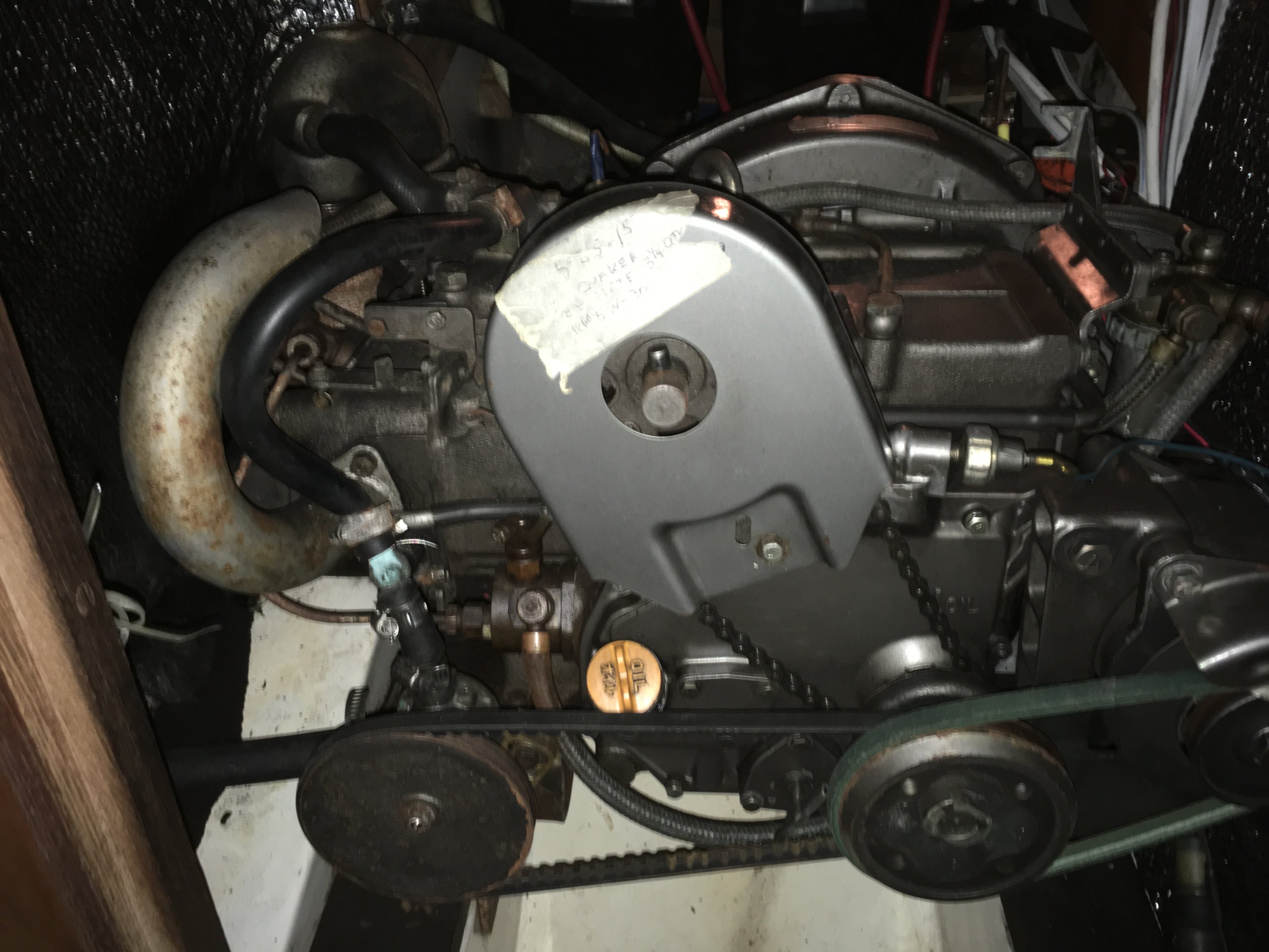

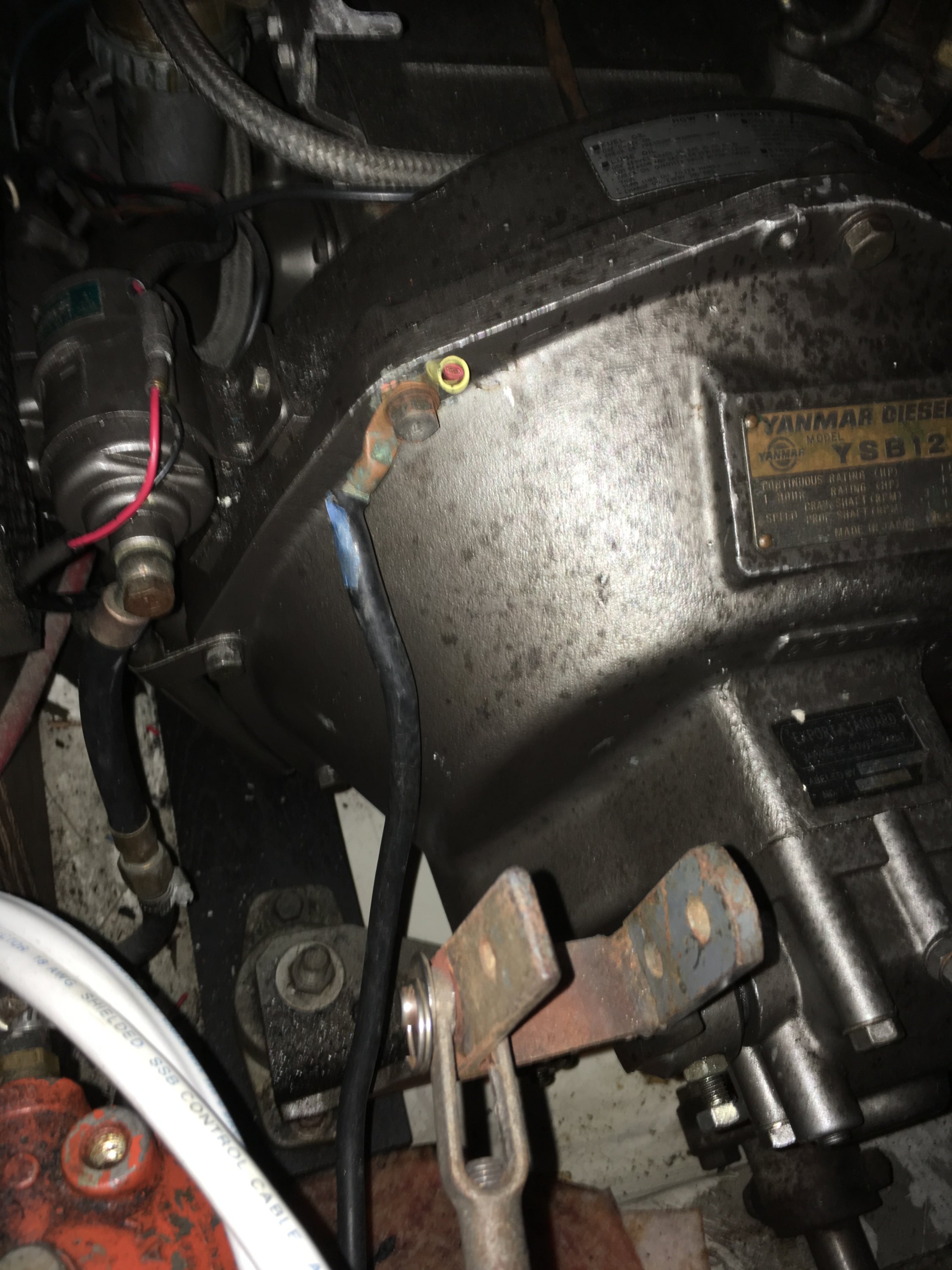

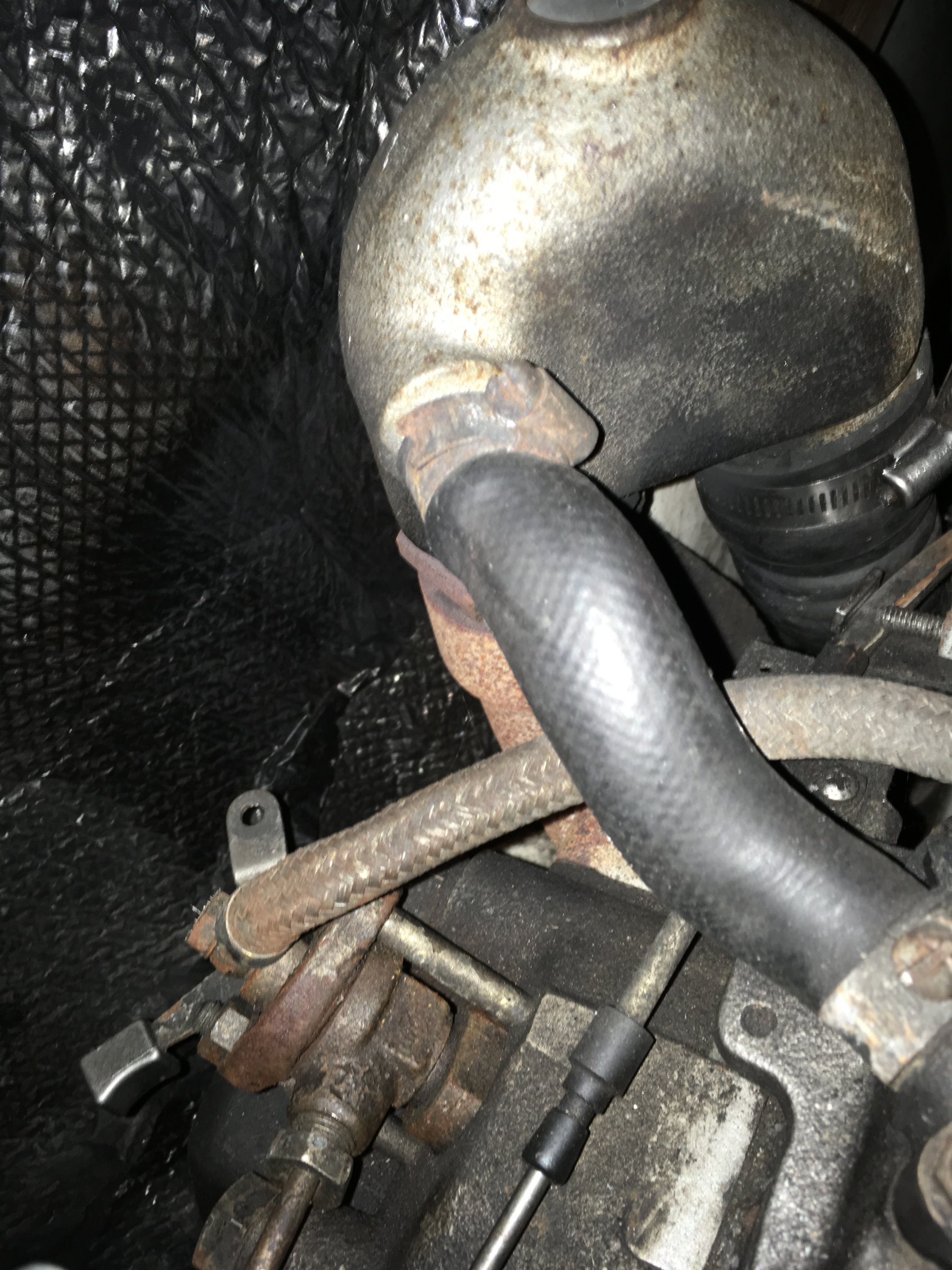

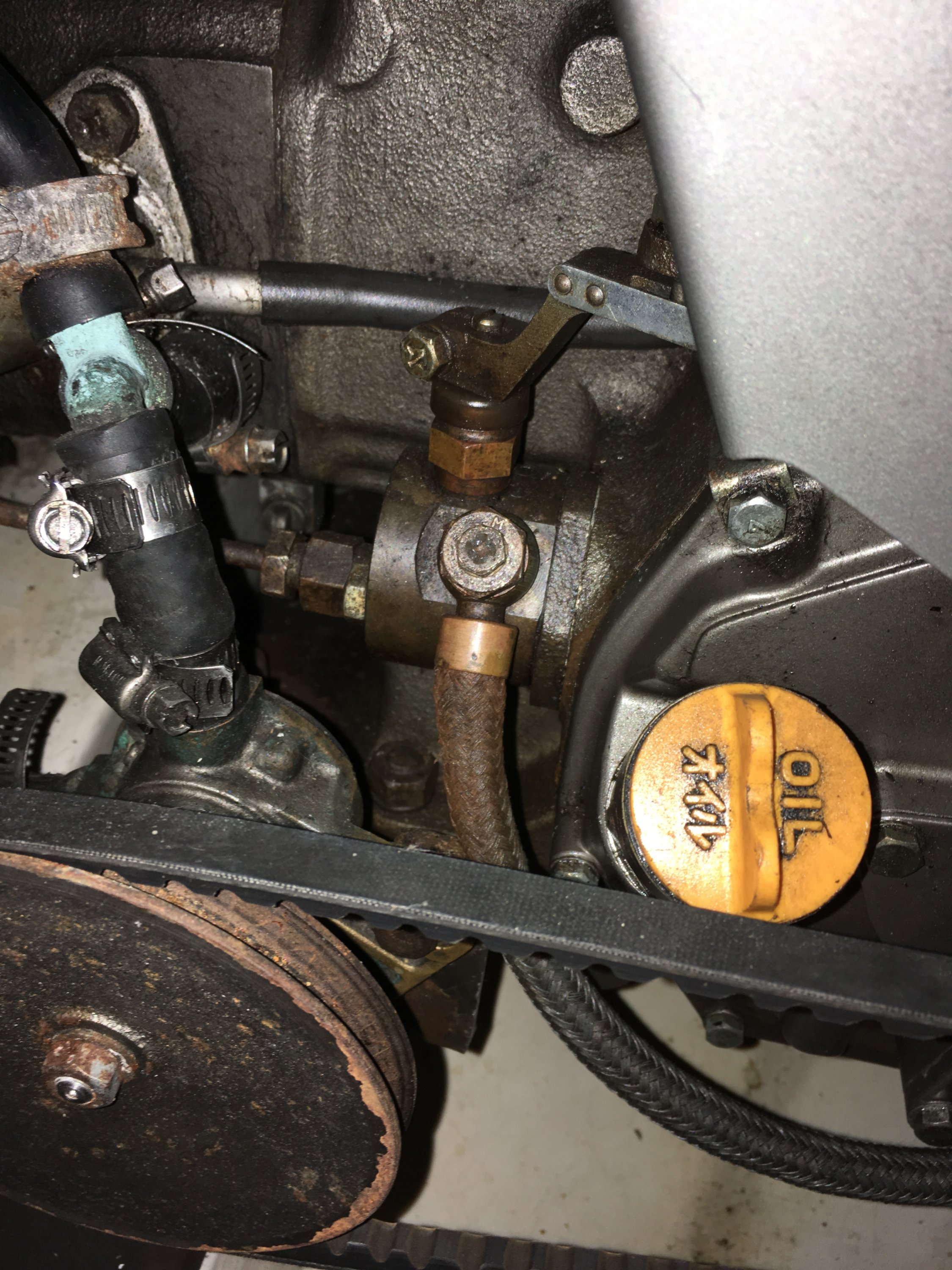

To bleed air that might be in the fuel line, I loosened a screw on the top of the fuel filter that is mounted on the engine while the electric fuel pump was running. After I got a steady stream of diesel, I tightened it. From that fuel filter, the fuel lines seem to run to 2 locations on the engine. Are these the correct places to unscrew to bleed the fuel? (see images named 'steps removed looking closer' 1 and 2) I tried unscrewing the first one but it just seemed like I was stripping the screw. Would a wrench work better? On the right side of the 'steps removed access' photo, you can see the fuel filter on which I was able to unscrew the bleed screw. In the bottom left of the 'port aft berth access' photo, you can see the orange fuel filter which leads to the electric fuel pump (mounted on the left (port) side of the engine) and then it leads to the fuel filter that is mounted on the engine. Would it be worth trying to get these fuel filters apart to see if anything is going on in there? Do I need to fill them with diesel when I put them back together?
