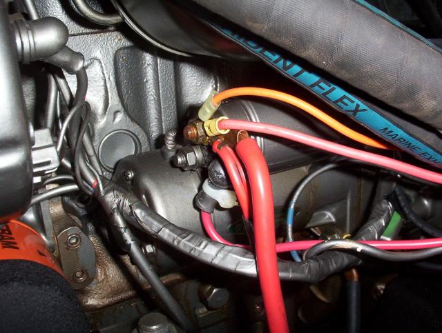

Warren Milberg said "I added a 12vdc relay to the solenoid to help boost the amps delivered to the starter when you hit the button. Problem is increased impedence in the wiring harness".
I agree 100% and installed the relay some time back. This immediately fixed this common Hunter/Yanmar problem..... but a year or so later I am seeing more of the same! So I have concluded that the wiring harness is now really suffering. I have thought about adding a momentary switch close to the new relay in case all else fails!
The internet consensus seems to be that the high impedance is due to the original use of un-tinned wire and the large number of connections in the harness. As a possible simple fix, I wonder if anyone has tried leaving the old harness in place and running two new wires, one to one side of the started button and one to the other side of the key?

Common problem on Yanmar engines due to Yanmar NOT using tinned wiring, especially in the Starter PRIMARY circuit. Replace all the components with TINNED wiring, etc.
Most common (in order of problem)
1. Fuse for the solenoid mounted on the aft/port side of the engine block.
Clean the corrosion from all the connections or replace with Ancor type Tinned fuse holder.
2. ditto above with the entire starter primary wiring circuit .... from the engine battery switch TO the solenoid. Replace everything with tinned wiring/components that show any voltage drop/resistance. Note: check for voltage drop/resistance only after the engine compartment has been hot - dries out the corrosion making it less conductive.
3. Starter push-button. If this button is used anytime there is any voltage drop (consequential amperage rise) the internal contactors of the pushbutton will 'arc' and there will develop a lot of (non-conductive) 'soot' on the contactors .... replace every 2-3 years. $12.00 from a Yanmar shop or get an alternative that uses (tinned wiring, etc.)
To rule out 'solenoid problems' (rare) next time the engine fails to start or turn over .... take an old screwdriver and physically 'jump' between the HOT (large) positive wire on the starter with the + terminal on the solenoid. If this instantly starts the engine (because you just bypassed all the primary circuit) then go back and read steps 1, 2 & 3 above.
