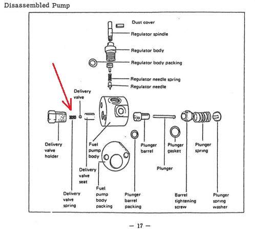

We made progress but the problem is not solved.
Installed new fuel filter and priming bulb and are getting fuel all the way to the pump. But after reinstalling the pump it just won't push fuel up to the injector. You can operate the plunger by hand, and it will squirt fuel without the delivery valve spring (red arrow) installed, but not when the spring is in there. So Steve believes that replacing the plunger assembly and the delivery valve assembly should be our next move. He found them online for relatively cheap (under $100). We also found out from the marina guys that the only place in NE Oklahoma that will rebuild the pump for me is Thompson Diesel in Broken Arrow, $150 for labor (ballpark) plus parts, which is the backup plan at this point.

I take it you have the pump fitted and are rotating the engine by hand or with the starter motor and fuel is not emitting the pump on the outlet side.
My first thought is that an airlock in the pump would do this. Steve is on site and I am along way away, but I still have a couple of ideas before buying a pump plunger assembly (BTW $100 is a great price, so maybe worth buying and sticking in the spares box)
Give the following a try. Using your exploded parts list as a guide.
Use lots of paper towels or rags to catch fuel.
1. Screw in regulator spindle (with fingers) until it seats. This will give max fuel delivery.
2.Unscrew delivery valve holder 4 or 5 turns. Under normal conditions fuel will dribble or pour out from around this outlet without the pump actually pumping. Let a liberal amount of fuel run out. (10 or 15 seconds or so). Tighten valve holder.
Actually a worn or damaged plunger, plunger barrel or delivery assembly will allow MORE fuel to pass in this situation.
3, Fit fuel delivery pipe to fuel delivery valve. Don't fit it into the injector. Tighten at valve end.
4, Place rag over outlet at injector end.
5.. Crank over engine. (using the decompressor lever helps)
This process should give you pure fuel at the injector and eliminate an airlock in the pump itself .
If fuel doesn't dribble from the loosened delivery valve, my guess is the the pump has not been assembled correctly.
I know it seems a hassle, but remove the pump, disassemble and reassemble.
If it dribbles from the valve but doesn't spray out of the injector supply pipe, it would seem to be a worn plunger assembly.
If it sprays out of the pipe, just fit the pipe into the injector. Set governor arm assembly as I mentioned before and you should be on your way.
Finicky? Yes , but the hit you get when she starts is worth it.
