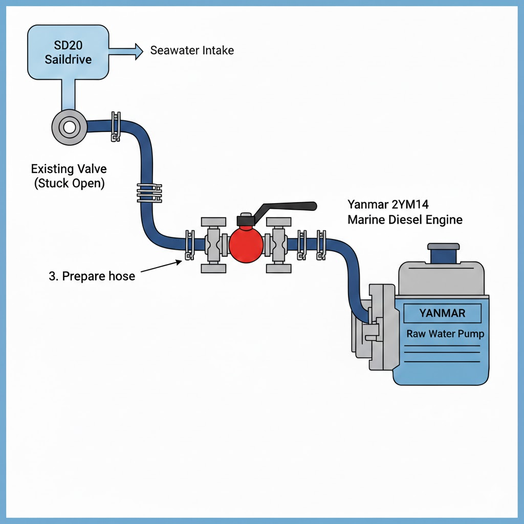

Hi I have a Yanmar 2YM15 diesel with an SD20 saildrive.
I have had to replace the raw water shut-off valve twice now as it stays stuck in the open position. Each time it is very expensive to haul out the boat and do this for such a small part. I have been told that this should be replaced with a ball-valve type of unit but Yanmar does not make one and still have to haul it out to change this.
In the meantime, I read that I could install and install-line valve between the saildrive and the water pump. It seems if I had the clamps, valve and a plug, I could cut the hose and quickly plug it then do the valve one side at a time without much water intrusion. I really appreciate any thoughts or experience with this. Am I crazy? Also, even if the shutoff worked, this seems like a nice back up to have on board.
Thank you all so much. Please leave out the sarcasm I really appreciate the knowledge out there. Here’s a simple diagram attached

I do not see the advantage.
The most suspectable failure point is the hose and you are spending a lot of time and effort to protect a little less hose.
If it is to protect other components from leaking the valve and clamps are not too expensive and it will allow you to sleep at night, then I'd say it was probably worthwhile.

Hi @circa1971la . I don't have a saildrive for propulsion but I do find your situation to be most interesting. And then there's the $500.00 +/- for the haul out to replace a nickel and dime valve. Most painful.

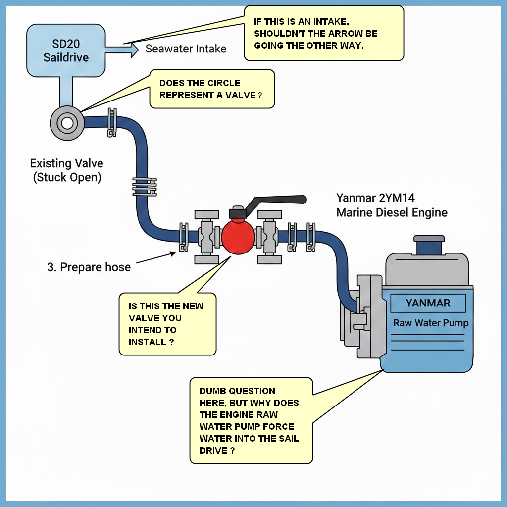

My apologies but I've got to say I find your attached pic to be confusing as hell. Could you please add any info you can to my questions :
You don't want to trust your gut in a case like this. Calculate the depth of this stuck valve below the water line of your boat.
No gut feelings here. Exact number of inches. And, what is the diameter of the existing valve ?
Next step, post a close up hi res picture (several is much better) of the stuck valve as far as position and ease of getting to the valve. Get close enough so that we can see how you installed it last time. What thread sealant did you use ? Give us everything you can ............ we're not there.

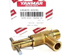

Yanmar doesn't make valves so they can't help you. If this valve can be safely removed in the water (above paragraph will tell), you should be able to install a good quality bronze valve for ~$30.00 depending on size. Any chance you've got the old stuck valve kicking around ?

Educate me as to why the Yanamar raw water pump feeds water to the sail drive. Interesting.

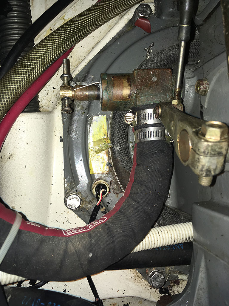

I’m sorry Ralph the photo is from AI... the point was just to show the inline valve. Anyone with a Saildrive out there will understand this issue and frustration with these. The seawater comes through the Saildrive into a line that connects to the engine. The raw water pump uses this to cool the engine. The valve is brass (photos attached) and they are notoriously crappy and get seized. The valve is accessed in the engine starboard side. Fortunately it’s seized in the open position but there are times when you want to shut this off. Nothing is leaking inside. Because of immense pressure underwater, you cannot change this in the boat slip with a diver. You have to haul it out to replace it. So my idea about simply putting an inline valve was to be able to do this while the boat still in the slip. The photo of the valve installed is from another boat I found online but is basically the same setup.

The valve looks like it can be disassembled for service. Try loosening the top of it to see if you can turn the handle.

Source the valve from Volvo. They use the same thread and Volvo's are ball valves.
People complain about Volvo a lot, but when it comes to saildrives, Yanmar cheaps out everywhere. Both drives are made by ZF, and are essentially identical, except Volvo specs higher quality components like the ball valve, hardened prop shafts instead of plated steel, roller thrust bearings instead a copper washer, and the list goes on. You just don't see the huge amounts of issues the Yanmar saildrive threads have in Volvo saildrives.
